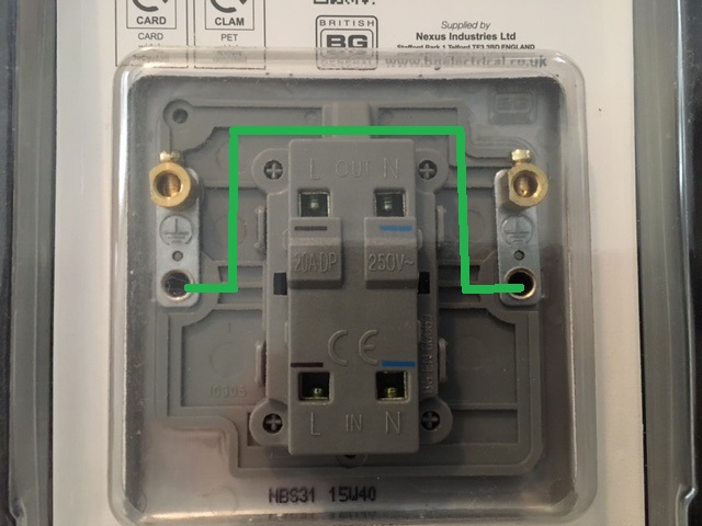

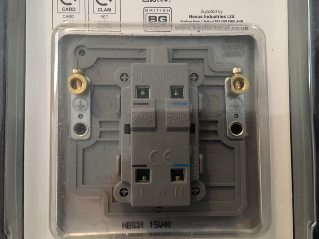

The reason for asking is because my electrician asked me to purchase 20 Amp switches (to match other sockets) and I was a little unsure because when I opened one, the tail fixings and holding screws where small. Not the usual size like the ones found in double gang sockets.

I have purchased a Nexus Metal 20 Amp DP switch. The terminals look like they will fit 2 x 2.5mm tails but they are a lot smaller than terminals found on gang sockets. I don't know if the size of the terminals are rated to certain amps. See photo
Is there any connection between those two earth terminals ? As per the green in the image.
If there is no connection between then and the installer uses both Earth terminals then the continuity of the CPC ( Earth ) will depend on the back box being metal and BOTH the fixing screws being tight. If ALL earth wires are wired into just one of the terminals then continuity will not depened on screws and back box.
It's a metal plate. Not that that is good manufacturing, my comment about cost cutting applies here too.
Will the connection between the rivets and the chromed front plate carry a fault current ( from the CPC ) long enough for the MCB to operate. As you say not good manufacturing due to cost cutting to save a bit of metal.
Seems a strange design if the "user contactable" outer plate is being used to form part of the CPC continuity circuit
Assuming the back plate isn't metal, which I think you are suggesting, I would then suspect there is a metal strip on the other side of the switch, which gets covered by the cover plate.
I think I would probably put all 3 conductors into one terminal.
There is no direct connection between the two earth terminals. It looks like it is connected via a small metal case to the front of the plate. I am assuming when the screws are in this will complete the earth circuit.
