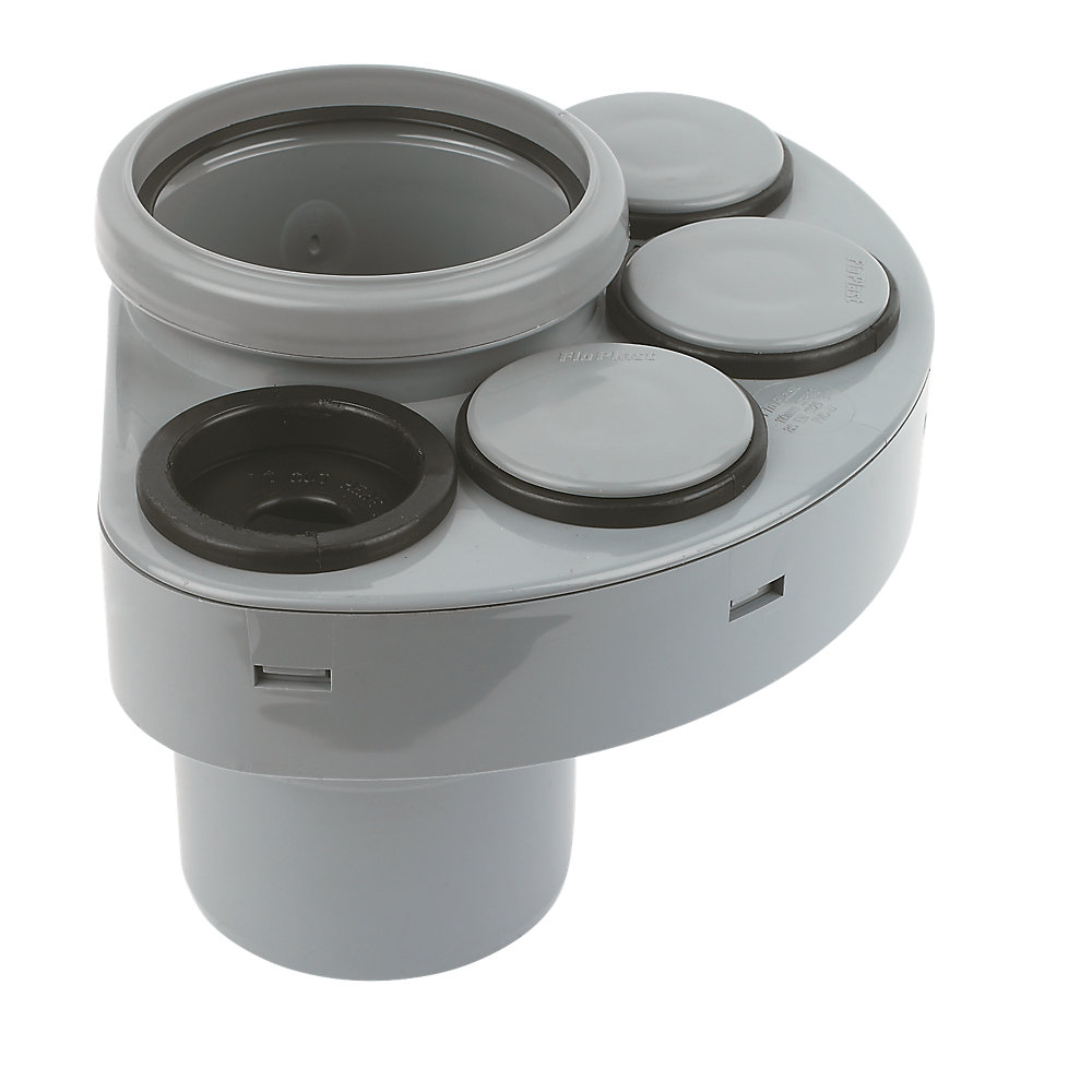

I need to connect a 22mm plastic pipe carrying condensate waste (boiler already neutralised it) to a 32mm plastic pipe than will then fit into a 4 boss waste manifold
i use 22mm regular plastic pipe to take the condensate down 6 levels to outside.
I have fitted a new soil pipe in a bathroom and can now terminate the condensate at 3 levels down instead of 6 and straight into the sewer rather than an outside drain
I need to connect the 22mm plastic pipe into the boss as described but to avoid sewer smell leakage, I wanted to use a 32mm pipe into the boss as the boss has a rubber seal for 32mm
hence the 22mm pipe to 32mm connector question
Then the regular 22mm pipe should fit in the centre if there are no burrs on the pipe.
