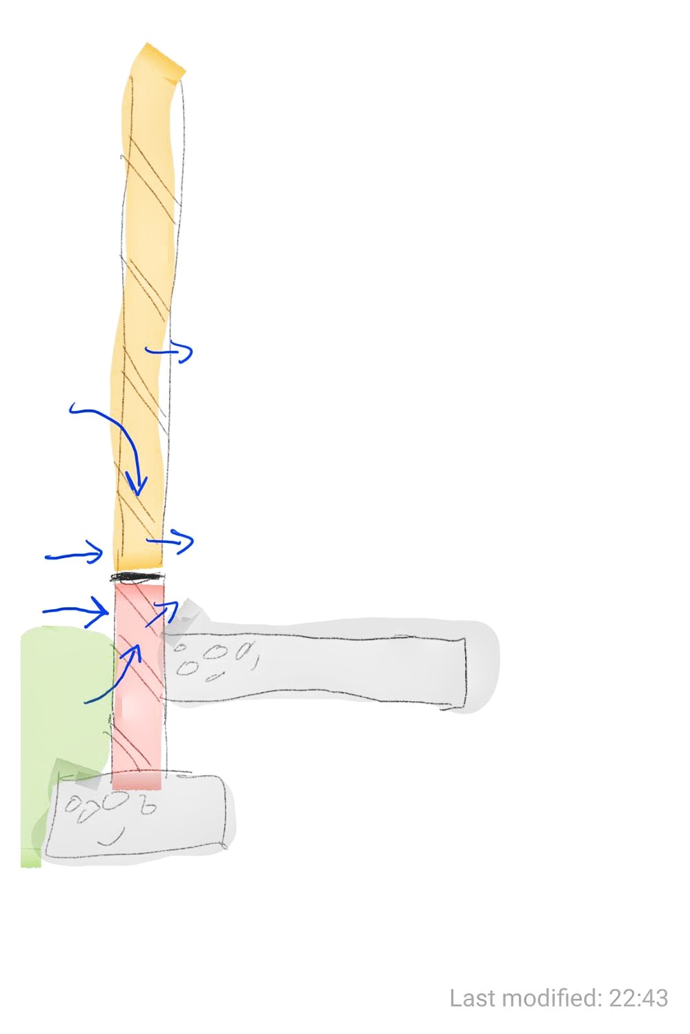

Hilarious how Woods shows a single skin garage, sideways rain and no roof protection, to prove his rather weak point. Even on a single skin garage a DPM coupled with a DPC will out perform a poxy raft as the brickwork would need to be saturated before ingress occurs. A very rare occurrence.
Why did you not show the DPM in your illustration?
Roof or not, it illustrates the well known scientific fact that moisture penetrates a solid brick wall. :rolleyes:
Which then raises the question of why insert a DPC when moisture will still be getting across the wall above the DPC.
Answer me that.

Depends on the finish of the exterior of the solid wall.

Because the rare time that there is driving rain prolonged enough to actually become a problem does not become the reason for forsaking all other moisture preventing practices. Your argument that once in a lifetime your vertical wall may allow the penetration of rainwater is not a good enough reason for leaving out a DPC and a DPM and is certainly a poxy excuse to fit an inferior, troublesome raft.

It' not just that. Its about location, roof overhang and other factors. Woody knows too well that the conditions for a wall to become saturated and begin admitting water are extremely rare. He also knows that garages built upon slabs are often penetrated by groundwater.
He is being obtuse.

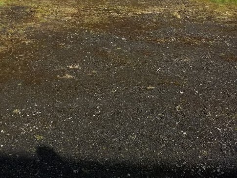

Hi, See pics of site. My house was built in 97 and the land around me is reasonably good. I will be building a garage on the location you see in pics. Land is reasonably good and has limestone chippings on it whre i park my cars/van. The garage will be 8x8 but considering making it larger to 10 or 11x8. Double skinned block.

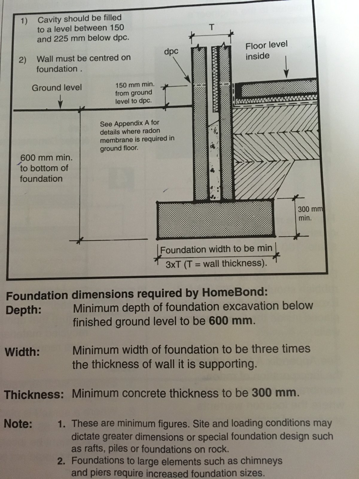

My question is, i was going to dig down 600mm and fill up 400mm of that with concrete but friend who works in construction with me has mentioned the fondations has to be below the frost line, then build up with block either on the flat or on edge and the cavity filled with a weak mix. However in my building book, it clearly shows the foundations showing min of 300mm in a 600mm trench which brings me above the frost line. Now im confused.
I was hoping, if i had to dig deeper than the 600mm, ill just fill the trench full of concrete to just below 250mm below the ground level then start my blocks from here.
In this country I believe 450mm down is enough for frost
http://nhbccampaigns.co.uk/landingpages/techzone/previous_versions/2011/Part4/section4/sitework.htm
The most important thing is digging down enough to reach ground of suitable bearing capacity -thats almost aways going to be deeper than 450mm. You wont know until you dug your trench. The other thing to bear in mind is trees or hedges in the zone of influence.
