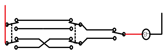

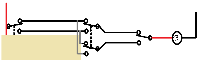

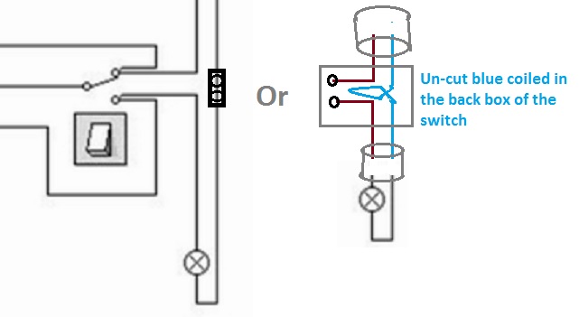

I would say the back boxes for switches are tight enough as they are without having a block connector inside, OK no real option with intermediate switch, but two way switches are normally wired as EFLImpudence showed in first diagram.
Technically I suppose one should run the neutral with the live so it is a balanced transmission line, however at 50 Hz a small resistor or capacitor in the bulb can sink any out of balance current and stop the lamp coming on dim or flashing.
Oddly at school I was shown JohnW2 diagram, however also at school shown how a fluorescent tube worked with a starter, but missed out the ballast completely, that it seems is the advanced wiring diagram as used with "A" level students. So don't reckon much as far as electrics taught at school.

Well, I can't forgive the overlooked ballast (which sounds like a recipe for a 'big bang'!), but they were probably correctly teaching 'common/standard practice' as far as 2-way switching was concerned. The house I lived in whilst at school had such an arrangement, as did the first house I bought (in 1978) and also my present house (which had been rewired in the early 80s). In fact, it was decades after I was at school that I even became aware of what is now usually called the 'conversion' arrangement of 2-way switching.
This isn't the most common problem with the 'old' method of singles in tube.
This was the method of intermediate switching taught at my school, using 2 double pole 2 way switches and a single gang 2 way.
