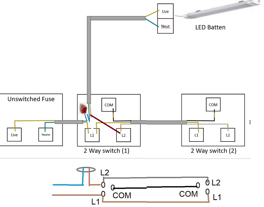

Hi, I’ve wired up a light in my garage however it will only stay on (the switches don’t do anything)
I know somethings wrong but because it’s from an unswitched fuse I can’t find that specific diagram online.
Terminated as per attached if anyone could please recommend how to fix - many thanks!

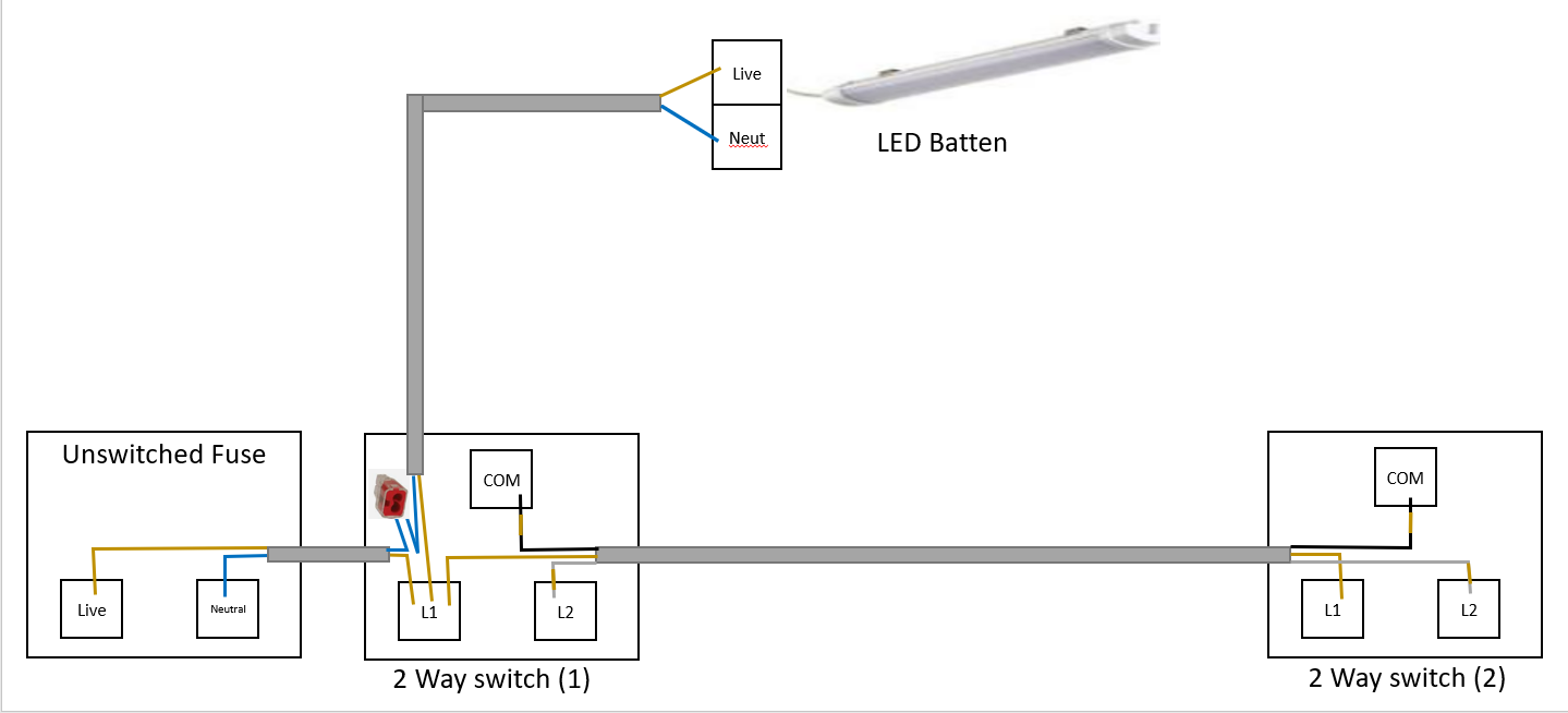

Hi, thanks for your reply - this is working better now but it’s only working in certain ways… I.E they work in certain configurations but if I turn one on the other won’t turn it off (if they’re switched a certain way round if that makes sense?) is it possible I broke one of the switches when I wired it up incorrectly?
I’ve just worked out that one of the switches only works if I press in the switch really hard - assume it needs replacing for a new one then?
If the Neutral ( blue ) was never connected to any terminal in the switch then it is very unlikely that the switch was damaged.
Most probably you have made a mistake at one of the switches.
Replaced the switch and it’s all working perfectly now, thanks again for the help
