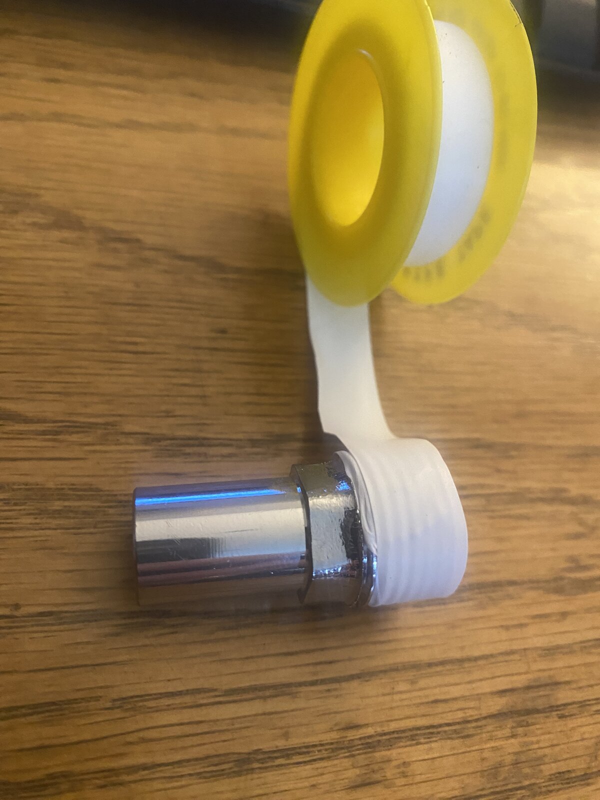

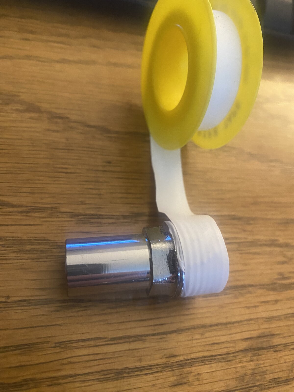

So the tail will screw into the rad clockwise right as the thread is on the tail itself, so do I need to apply the tape to the tail counter-clockwise or clockwise?

Clockwise with the end of the tail towards you. That way tightening pulls the tape into the thread, ACW would push it out.
If you hold the smooth part of the tail in your left hand with the thread to the right then turn the tape onto the thread away from you - ACW

Yup .... as it goes on the thread, it goes on away from you if you hold the tail with the thread on the right, that's, so when the tail is tightened in CW it's tightening against the tape.
Depends on what end you are looking at it from though. I'm right handed so I hold in my left and wrap with my right, as I look at it to me that's ACW.
edited to add pic

With the threaded end facing you, the way you'd normally hold it (as I said in #22), that looks like clockwise to me. But your pic should make it clear to the OP.
Sorry but I just wouldn't hold nor ever look at it like that, hence my description. Held in my left hand with the threads to the right or right hand with the threads to the left, the tape would be going on ACW. If the tail then turns and tightens into the rad clockwise then the tape would still be running anticlockwise to ensure it doesn't unravel.
The only time it would clockwise is looking at it head on at the thread end, which is always an option and all are correct depending on the view/opinion I guess.
OK, as long as the OP understands
