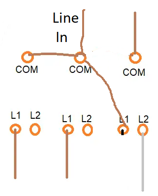

As @SUNRAY says a two way and two singles is possible View attachment 309174I would start by putting all the wires in a choc block so I can power up safely, then test to see which has power, and connect that to all switches.
There are at least two ways to wire two way, View attachment 309175the basic system shown L1 is permanent line, on both switches, checking the other switch should show if that is the method used.
Once line in is identified, then just need to by trial and error find the L1 wire for simple on/off switches, then two remaining are for two way, again trial and error as to which is L2 and which is com.
Followed this and it worked like a charm. All the lights are working now. Thank you very much for your help.
PS: found the two lose wires that was bridging the live wire.
