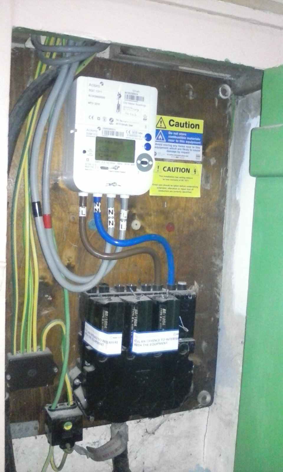

I'd not worry about the 3-Phase bit and peices unless they really are in your way. The meter is a mdern (read industrial 'smart') 3Phase one. Doesn't matter if one, two or all 3 phases are consuming energy it has only one output so will serve as a domestic one also.
As has been said, I think the only "3-phase bits and pieces" are the 3-phase cutout and meter - which, as both you and I have suggested, would probably be best retained. Most of the bulky stuff there relates to the storage heaters (now going or gone), so that can be removed, and all the various CUs etc. will probably be replaced by a single one - at which point the OP should have a simple and tidy installation (and few, if any Henley blocks!).
Any property with 3phase and a 3P meter installed is worth more. Please don't ask the supplier to remove it 'cause if you or your successor in the property want 3 phase for their use it is so expensive to have it installed and the reasoning to have installed so converluted and difficult.
Very much so - much as I said above ("if it were me..."). I have a 3-phase installation and, although I'm using all three phases, I could manage quite happily with just a single-phase one supply - but there's no way that I would dream of 'getting rid of' the 3-phase supply.

Personally I wouldn't even bother contacting DNO unless you need the cut-out fuses removed during the works.
If you do get it changed to a single supply you will end up with: the cut-out (Company fuse), 2 tails to meter, meter, 2 tails to your equipment. Something like this but with fewer 'earth' wires:
All the rest of the installation is yours to do as your electrician feels fit.
BUT I see there are 2 electric showers, if these are being retained it could be beneficial to run at least one of them on a separate phase.
I am assuming the supply is currently 80A or 100A fused. If it's less than this I'd definitely say keep it 3 phase
Our electrician will fit un a new consumer unit but who is responsible for removing the huge 3 phase supply unit? it it us or the electric company?

they are (according to the electrician) the old boxes for the 3 phase uni that we want removing
I can't help thinking you need to find an electrician - ie someone who actually understands electrical stuff. This one sounds like that only know enough to do "standard" domestic stuff - perhaps one of those "5 day wonders" - and is completely out of his depth.
It's hard to think that a competent electrician would not understand that all that stuff is redundant and can be removed.

As has been said, everything other than the meters and the thing at the bottom right with the fuses is yours - so if (as I suspect) a lot of it will no longer been needed, it will be for your electrician to remove it (once he's worked out what it all is and does).
