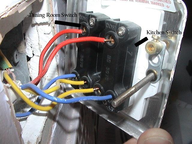

The dining room switch is next to the kitchen switch in the photo

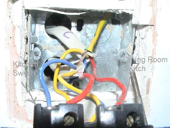

I know it's a pain, but any chance of a photo looking into the switch box at the kitchen end?
so that we can see where the wires come from..
it looks like the yellows are mixed up, but can't tell for sure..
ta..
ta..
Looking into the box....
Have to get some sleep, lack off sleep and Electrics do not go well together.
yup, the yellows are crossed, that will be the cause of the dimming, swap them before you go to bed and report back...

all the visible earths look fine to me besides the one that was the middle switch, but this looks likt the OP has stripped the cables back himself to put them in terminal blocks..
ok we can do this.. but it's going to be confusing so bear with me...
at the dining room switch, change the wiring to the following.. ( dining room only, don't alter the kitchen switch )
Com - Yellow
L1 - Red
L2 - Blue
now connect the wires in the middle red to red, yellow to yellow, blue to blue..
the switch wires in the middle should be connected red to red, black to blue.
this should now get your 2 lights working from either switch...
this should be sorted properly when your sparky comes and has a look but it will get you up and running for the time being..
ideally you should change the cable between the switches to one piece, and re-route the switch wire to the dining room switch..
