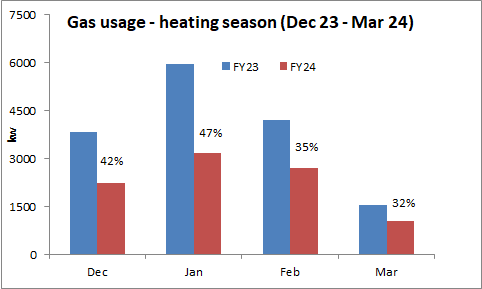

I had two 24+18kw old boilers serving two separate zones in my house.
All single glazed windows, poor insulation no cavity walls.
I plugged all draughts and holes. I carried out HL calculation and it turned out I need 12kw for 4 beds, a huge lounge (600sq.ft), 3 baths.
Installed 13 kw Viessmann heat only boiler outside my home; weather proofed the boiler by building a wooden box around it.
In this heating season, from 20th Dec to 10th Mar, heating was on from 0800 - 2100 hrs mostly since my dad and wife are vulnerable to cold.
Installed thermostat with new setup (old setup didn't have room stat). The house was comfortable, gas usage came down to 40% from last heating season.
I have bought a weather compensation sensor for viessmann and will install it next heating season to see if it saves any gas as advertised.

Are you saying that a 13Kw heat boiler is good for your house of 4 beds and three bathroom which is poorly insulated?
Yes. This is what I have put; a 13kw heat only boiler (Viessmann vitodens 100-w).
I have a two pipe system.
I didn't change any pipework, its an open vent system.
All single glazed windows. I had to change a couple of radiators upstairs since old ones were single panel and were inadequate for colder rooms.
I insalled it before winters and these winters were very comfortable; on pocket as well as heating inside the home.
As I have said earlier, I wanted to install it in a balcony under the shade and was advised to weatherproof it which I did. I can share pics if you like and the heatloss calculations that I did for room by room on an excel sheet.
