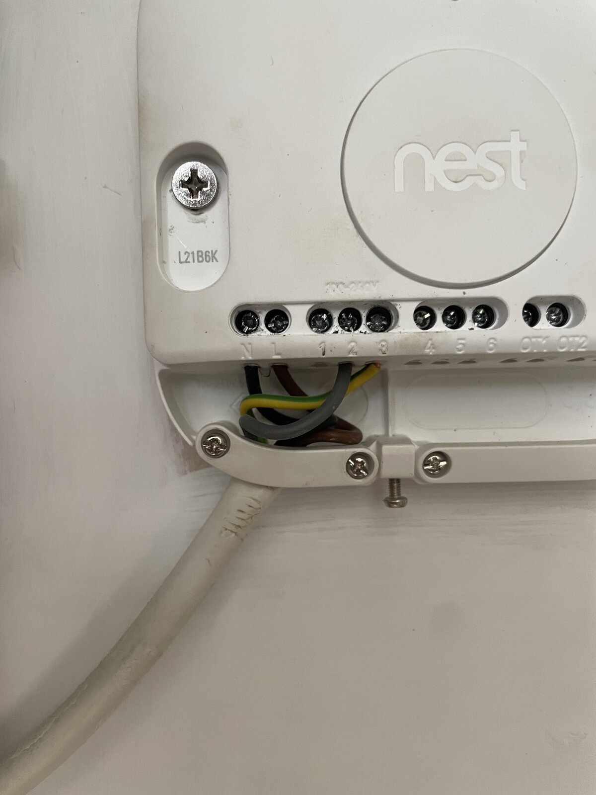

The cold snap made me switch heating on for first time in 6 months which has caused 2 unrelated problems on a well maintained Worcester Bosch 38CDI. Grateful for any advice on:
1) boiler doesn't respond to Nest thermostat 1's call for heat, either wirelessly or on manual override next to the boiler. Have reset the Nest and the boiler but problem still persists. (Pic 1 - manual Nest override looks like it's calling for heat but 38cdi not firing)
2 but it responds to Nest 2's demand showing boiler is functioning, but the Grundfos UPM3 shows an error and won't restart even when using the anti-clockwise unblocking procedure with the screwdriver (Pics 2 and 3, UPM3 quickly defaults to error mode)
If you link-out the call to heat and the common (terminals 2 & 3), within the Heatlink, and the boiler fires - that could prove that the Heatlink is dead.
If you aren't sure how to to that, post a pic of the wiring within the Heatlink, and we should be able to help.

The Heatlink has an earth, brown and black coming into the junction block. I've looked at the Nest instructions but can't tell what should happen to these wires afterwards and how they should be linked to the zone valves and incoming 240v supply, so any advice would be very welcome.
And how I can jump them to simulate a call for heat.
1) there is a grey wire I missed, coming out of the Heatlink into the junction box
2) here's the open Heatlink
2) here's the open Heatlink View attachment 317470
It's probably easier to do in the Heatlink - with the power off, just place the grey and yellow/green wires into the same terminal (2, or 3, it doesn't matter).
If the heating comes on when the system is powered back, the heatlink is likely to be faulty.
If the boiler still doesn't fire, the problem is elsewhere.
Good news: I jumped the grey and yellow/green in the Heatlink and the boiler fired. It also seems to have "unstuck" whatever electronic glitch had been happening and Nest 1 is now controlling the boiler again.
Bad news: the Grundfos is still stuck and short of swapping it out, I'm not sure what I can do with that..
