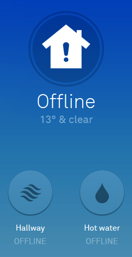

When I had a problem and turned the supply off it gave this screen
it is clear enough when something has gone wrong.

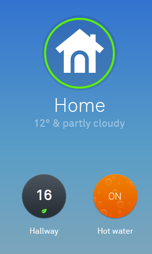

When it is running the colour changes like this
with in this case domestic hot water being on, I note you can use different software, not sure which you are using.

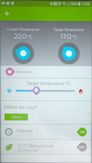

where it says Hallway with circle with 20 in it saying you are home, that's the Nest thermostat, on opening you get

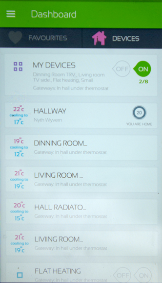

however you can also use Nest's own software, it seems only on the phone does it show TRV head and wall thermostat on the PC they are separate.
As to if heating will auto turn down if I am away and wife home I don't know, as yet not got her phone set up. Could that be your problem, is it picking you your phone is away and turning heating down, I do wish it was a little cooler to be frank, shows between 21°C dinning room and 24°C in living room, think an air con would be better today.
