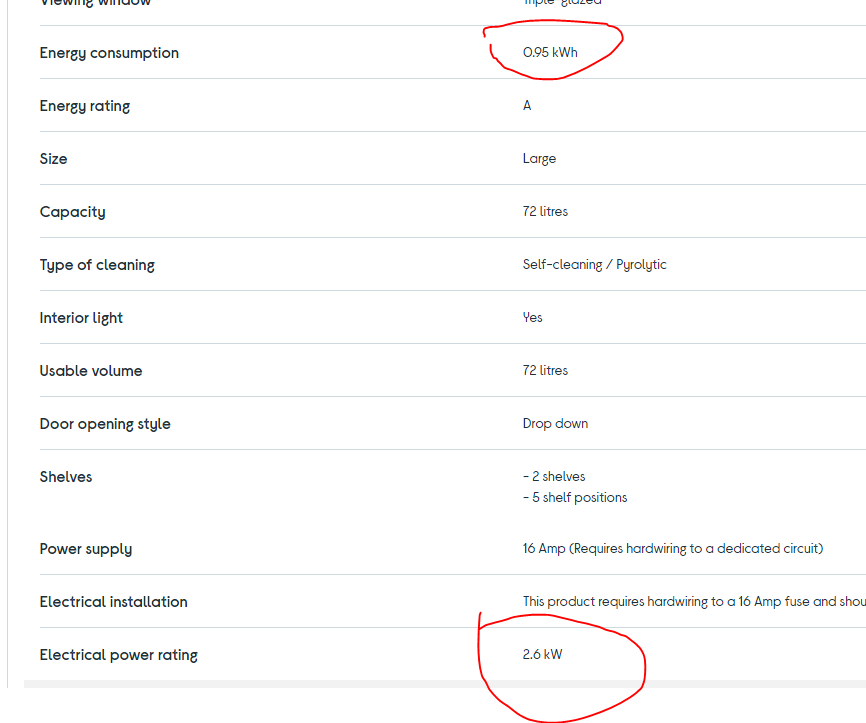

3kw or really 2.7 kw constantly is a lot of energy...even a fan oven these days only uses 0.87kw or 870w at max these days with an a rated oven.
I think you will find that that is 0.87kWh or 870Wh.
I.e. 2.7kW - cycling on and of with the thermostat - is 2.7kW when e.g. actually on for 20 minutes out of two hours = 0.9kWh.
Did I put a h in there sorry butter fingers...the draw of a modern fan oven is about 0.87kw or 870 watts at full blast.
No, but you should have.
No it isn't - that is not what kWh means.

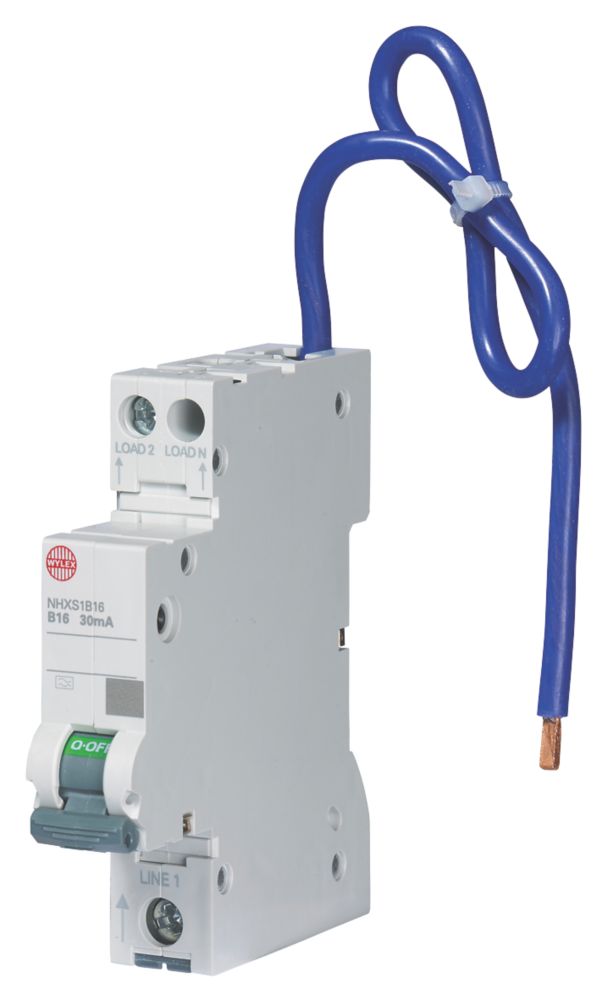

I've started by having a look at some DP RCBOs, and I am wondering if this one is OK, in this enclosure?
The problem is that "double pole" is rather loosely defined when it comes to MCBs. The RCD bit will be fine, but the MCB could be double pole as in "overcurrent detection on both L&N" (which is OK), or it could mean "overcurrent protection on L only, but switches the N as well as the L when off/tripped" (which is not adequate for reasons I'll explain later). I don't have time to go digging into data sheets etc. right now to find out.
I also stumbled across this, while searching, which has RCD and a 16A MCB. Could I use it, rather than buy the separate bits?
In principle yes, but see above about what "double pole" means.
As others have mentioned, that is demand averaged over time - most will have elements rated much higher than that, and so your supply needs to be rated for the higher figure. The other issue is that for things like fridges, the inrush current will be many times higher than running current - although I imagine modern inverter driven types have a much lesser peak demand.
Thanks @SimonH2.
I'm trying to read up on the difference, and how to identify it. Am I correct in thinking that the above is the same as "1P+N vs 2P" with some 1P+N products being described as 2P?
