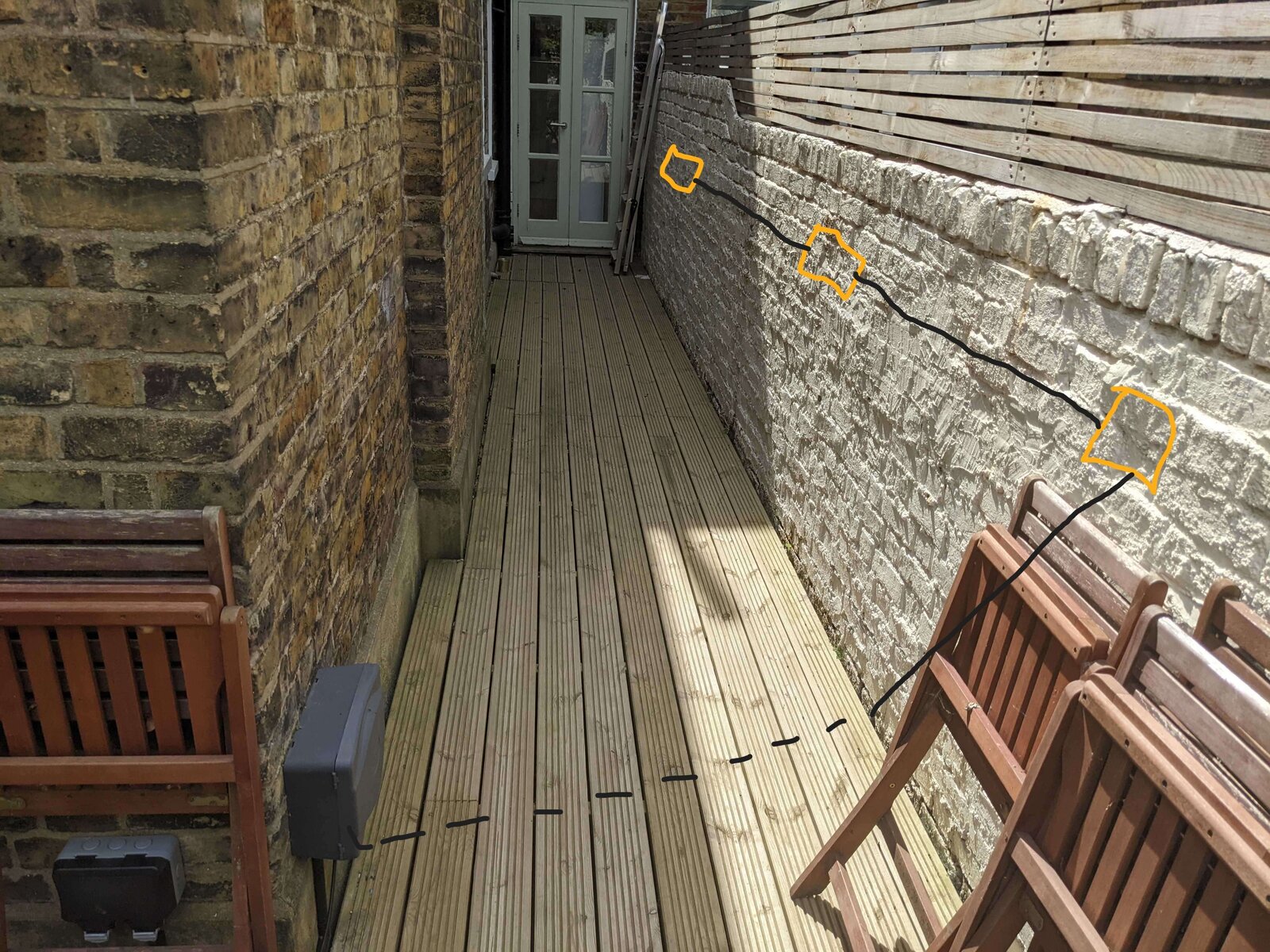

Hi all - I am wondering if anyone knows if it'd be possible to connect 3x wall lamps (connected by conduit) and feed a weather-proof cable underneath the decking to a 3-pin outdoor socket (as shown here)?
I can't find any wall lights designed for 3-pin sockets. Would it be possible for some electrician to feasibly customise the lighting set to do this?
Doing it this way means I wouldn't need to open up my walls any further to access electricity.
Hope it makes sense?
Attached.
Thanks in advance,
Z
You could do as you suggest, but given the location of the two boxes on the house wall, you might be better to get a switch added so that the lights are on a spur?
If the lights are LED the draw wouldn't be anything to worry about.
Another possible option is to power them via a connection by the French doors?
