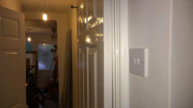

1st is the approach to the extension - 2gang switch, the one on the left controls the 4 lights (the one on the right controls a small room)

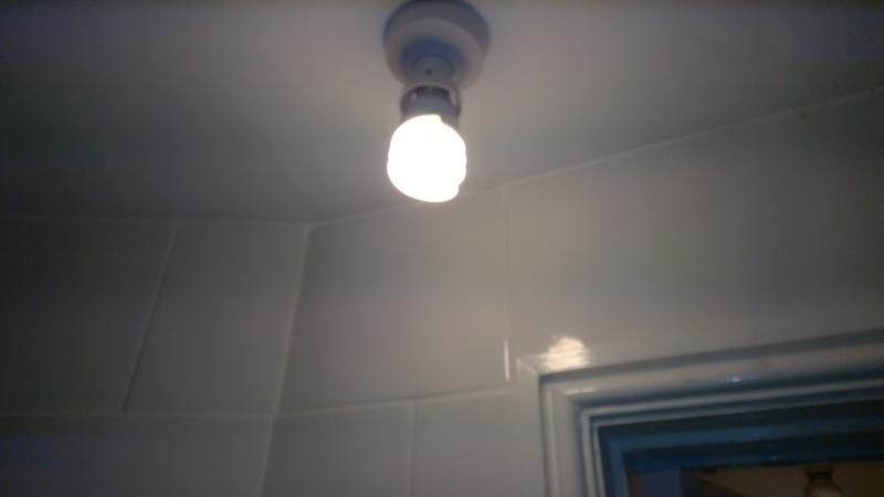

2nd this shows the relationship/locations of the lights

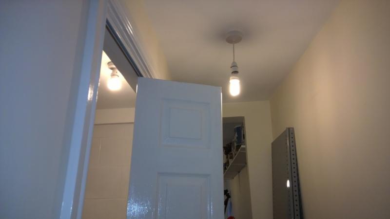

3rd shows the ceiling rose batten mounting.
This is the light I want to control separately - ideally on a pull cord (without the other lights having to be switched on)

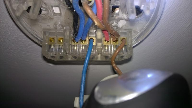

4th shows the wiring of the ceiling rose.

The photos of light switches and lights don't tell us anything about how they are wired up.
The photo of the ceiling rose shows that it was wired by someone who did not have a clue how lighting circuits work.
That was my first thought, but there are a lot of cables/wires so this maybe why the middle terminal has been used.
But yes, not exactly cleaver with light circuits

What I meant was that photos of the fronts of switches and of pendants don't help.
No more than you normally see in a loop-in rose.
The photo is surely one of the intermediate roses, with in and outs of neutral and switch wires. The incoming live and switch feed must be in another rose.
Typically 1 wire per screw terminal.
They have managed 2 wires per screw terminal, but not done 3 which would have been required to use the outer terminal
Well its not there is it.
Either at another rose, at the switch, or junction box,
or god know what with that install !
