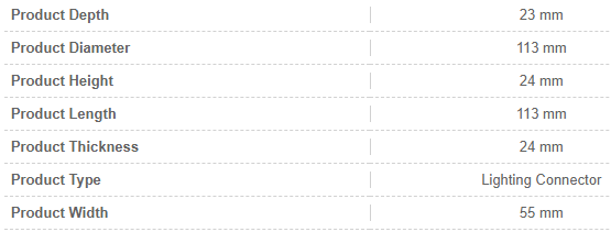

Does anyone know of a connector like the one below, but with a smaller profile (ie smaller hole needed in the ceiling)? Thanks. https://www.screwfix.com/p/greenbrook-20a-4-way-lighting-connector/176gv
Have you actually seen/handled one? If not, have you any idea what size it actually is - if you can make any sense out of the following, you're much more clever than I am :) ...
Kind Regards, John
The PDF for it says "L113 x W55 x H22.5mm", so, Pythagoras says that should fit through a 60mm hole.

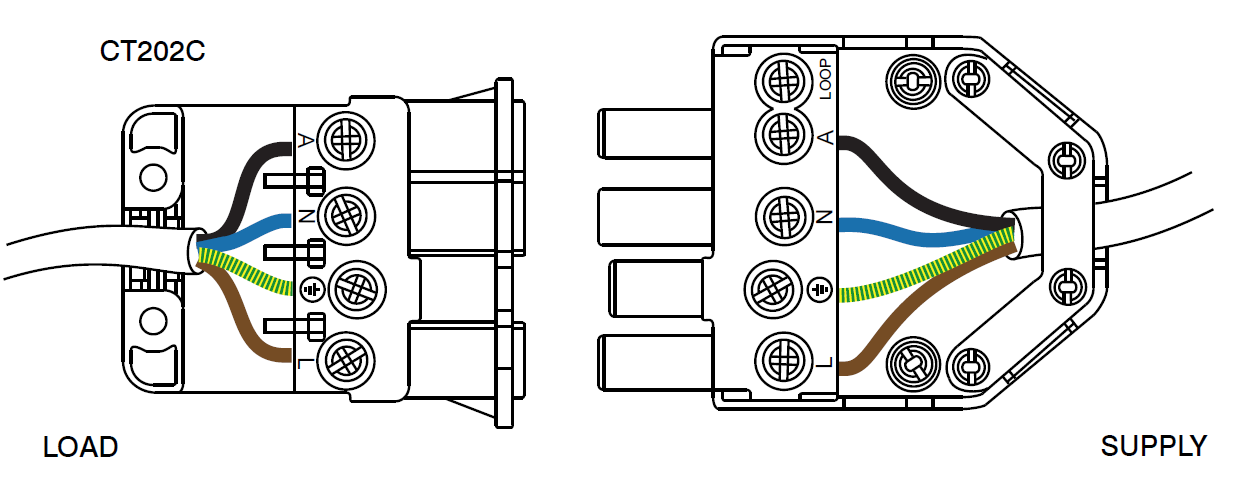

Do you actually need the L1 'auxiliary' terminal also, or just the loop in terminal?
Click flow CT102c is a bit smaller...
https://www.downlights.co.uk/ct102c.html
Has the loop, but not the L1 and will fit through a 51mm hole.
John: Saw that and couldn't work it out!
Gaz: Yeah, I need a 4 terminal one.
Seen some round ones on Screwfix but not sure if they are suitable.
Will look at Click too.
Click do do that type... (CT202C)
But it's barely any smaller than what you've found already, sadly. 55mm hole.
Yes, that's what I guessed the figures on the Screwfix website we trying to say.
However, I must say that I'm rather surprised that it is 55mm wide (which, in English is over 2 inches) - which makes it pretty 'chunky'.
