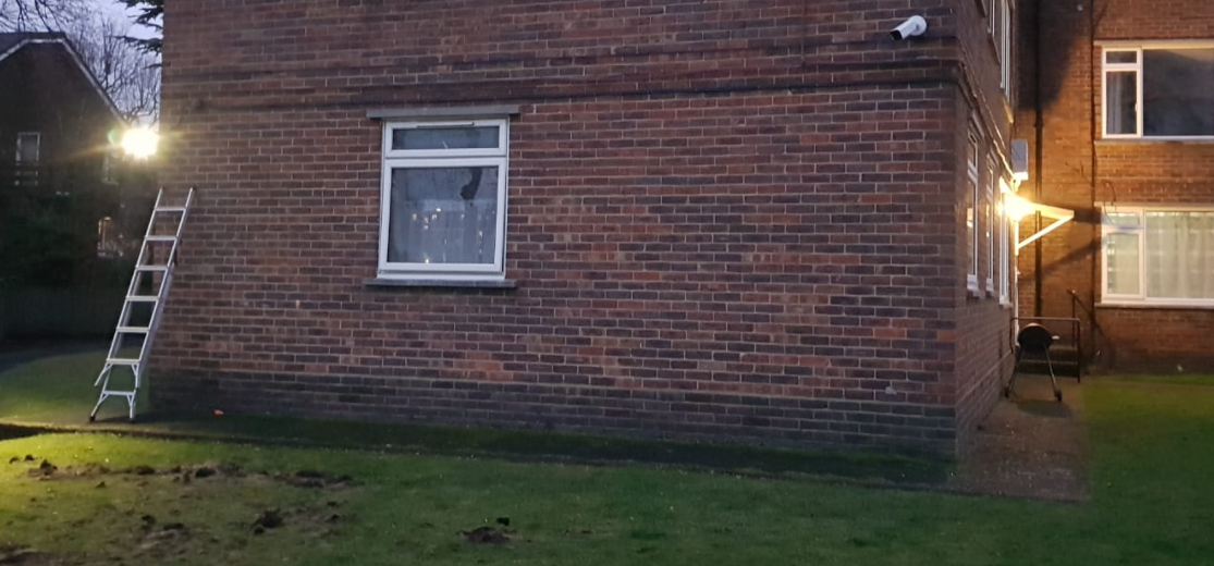

I've read this thread with interest - and would like to say thanks to the contributors for helping with the idea of connecting the Live of the combined lamp + PIR to the switched live of the junction box. It 'kind-of' works for me. My setup is different though, I have 2x combined PIR lamps. The one on the left is the new one, which has 3 connections (L,N,E) - where the L connected to the SL on the junction box you can see just above it.
The junction box has 2x E, N, L and 1x SL on one side of the terminal block, which I assume is the PIR from the right-sided light. So the left-sided new combined lamp + PIR only functions properly during the time the right-sided combined lamp + PIR is on, but not when it's off.
Anyone have any ideas on whether there's a way of making the new combined lamp + PIR work independently of the existing right-sided one? Thanks for any help you can provide.
Only by rewiring so that one has a permanent supply.
The better solution is to use one or more separate PIRs, and one or more lights.
Lights with built in PIRs are useless, as to get the PIR covering the required area results in the lamp blazing horizontally into peoples' eyes, or if the light is positioned properly at a decent height directed downwards, the PIR is useless as it only covers a tiny area directly below the light.
PIRs normally mounted at about 2 - 3m above ground level and positioned so that people walk across in front of them, not directly towards them.
Lights of the flood variety mounted 5-6m above ground level directed downwards.
