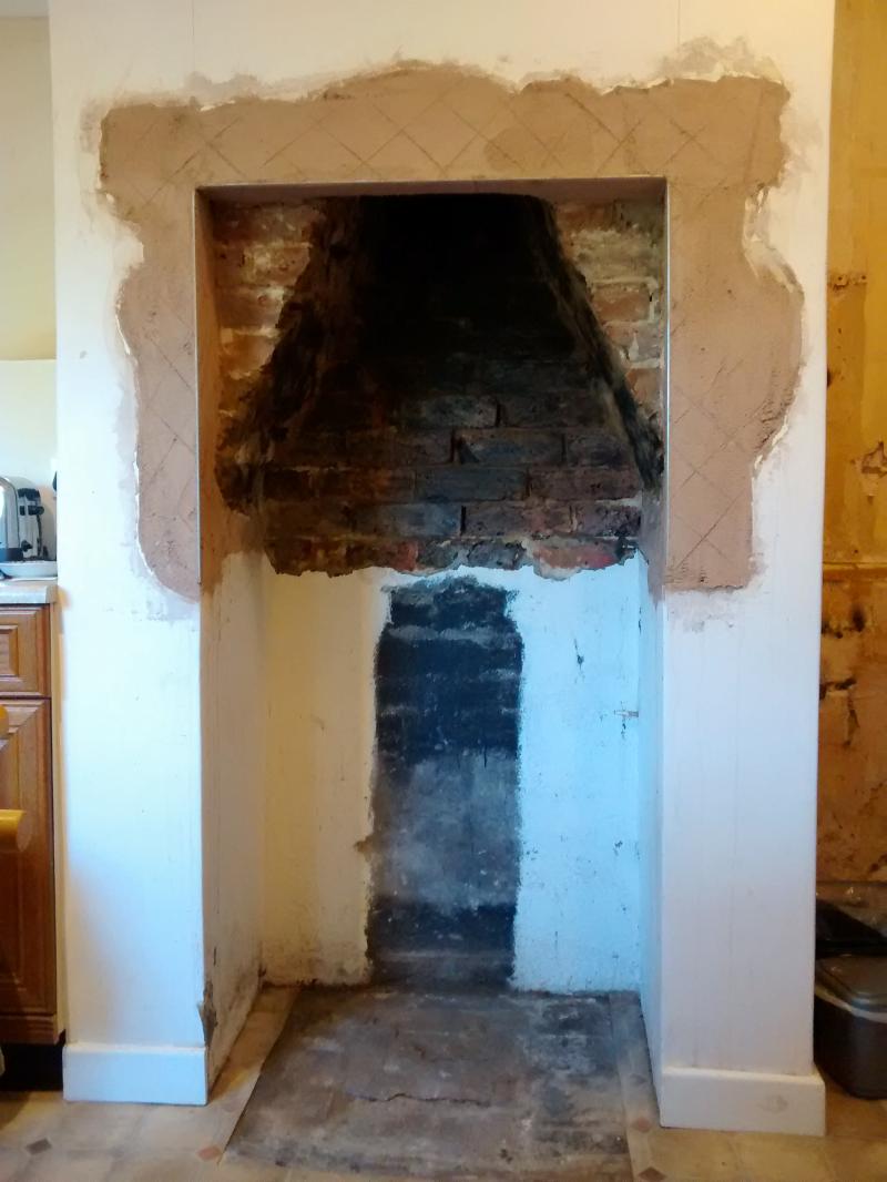

I've had my chimney breast raised as much as possible for a built under cooker and induction hob, there's a metal flue in situ and am trying to find an extracter fan to fit into the small 40cm x 40cm opening we've now got.
Does anyone have any ideas? I'm considering modfiying one if necessary.
Any ideas appreciated.

Can you explain where the 40cm. x 40cm. requirement comes from?
The fireplace is obviously more than 40cm. wide.
But doesn't look wide enough for it to be a good place for a hob.
If so, although plenty of room, width-wise, for a normal cooker hood it may be too low - so a plate and fan.
Assuming the worktop is the usual 90ish cm the width would appear to be around 80cm.
A bit tight for a hob, perhaps, but ok ???
There are hoods with a very shallow visible profile but you may have to remove some chimney to accommodate the 'works' or there are fans which go on the top of the flue.
Hi, sorry I didn't make it clearer, here's some extra info:
sorry image info is dire :D
Ignore the worktop to the left, it's a 50cm depth so looks deceptive and is to be removed.

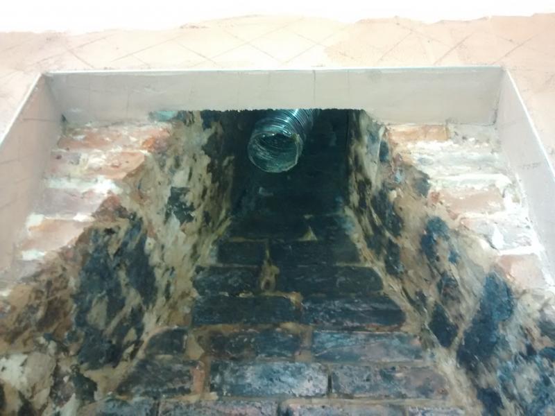

So new worktop right across, under counter electric oven, inductor hob and hope to get small extractor at the point where the lintel went in. The 40cm x 40cm gap I have is width at top and depth from lintel to rear bricks
Chimney runs up middle dead centre in my house, with kitchen/lounge either side of it ground floor and 2 beds either side of it upstairs.
Looking up

Doubtful if any hob can be satisfactorily installed in that space - the height of the bare opening is already too little for a gas hob, some electrics might be permitted there (650mm minimum for many but only if an extractor is installed above) but that ignores the tapering sides which are far lower, and the fact that if a mini extractor was found, it would not be the full width of the hob anyway.
Proper solution is to install the cooking appliances elsewhere in the room, or remove the chimney breast completely.
