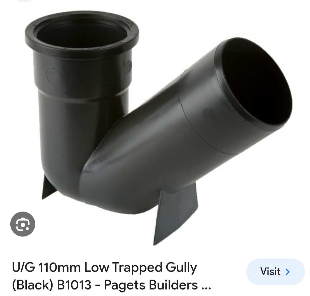

40mm into soil pipe - need a trap?
Practically speaking you could change the elbow coming out of the wall for a Tee and then connect the rainwater into the top of it.
Regs wise, I believe that even in a combined system the rainwater and soil should be separate until they reach the sewer. Otherwise if there is heavy rain or leaf fall from the rainwater then you risk the pipe clogging and the rainwater coming out of the toilet...
So I wouldn't do it.

One of the risks you run if you attempt to connect the rainwater to the soil as per your proposal, is you'll be venting the sewer through the downpipe and out at the gutter outlet. There is then the possibility you'll get foul air going under the eaves, and into the space behind, which given the dormer affair you have, then into the room(s) beyond.

The solution is a trapped gully fixed to the wall, cut the legs off first and fit a little basket to collect any leaves.
Spend the other £29,990 on a cruise.
Extremely unconventional, but technically it would work!
You'd need some good brackets, there would be a kg or five of water in that trap at all times.
It would be infinitely better to do it properly.
