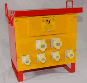

Most will have guessed the subject 1715810539925.pngwith a 10 amp overload they can deliver 41.8 amps when one line is shorted to earth for a very long time without anything tripping, common to find extension plugged into extension so the cable is that long there is insufficient current at 230 volt to open a 10 amp overload, but there is over 40 amps at 55 volt.
Where I work in the main they are used to supply 110 volt lighting, most power tools are battery or 230 volt, it is not a building site, so there is no rules saying 110 (55-0-55 or 64-0-64) volt must be used, but in a building which leaks like a sieve, reduced low voltage lighting is considered better.
Power tools do not present such a problem and the cables are run out for a job, then collected again once finished, but lighting can easy be left on for an extended time, and possibly no one would notice it had failed.
So with inspection and testing of in service electrical equipment would you pass it? And what would be the reason given if failing it, assuming in an as new condition?
My view has always been these transformers should have double pole OCP.

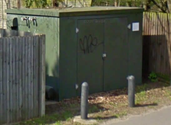

One of the places I worked, in the factory prior to transporting a installing on site I assisted with fitting out a roadside pumping station in a glass fibre hut, this sort of thing:
The 240V supply was transformed down to 110V for everything. The company's electrician fitted a 32A RCBO to supply a 6KVA or so 110V transformer followed by a domestic CU with single pole MCB's including 16A MCB for each of the several 16A yellow sockets and of course red and black wiring.
I queried only pole MCB's in the CU and essentially told I was not an electrician and not my business. I spoke to a manager and he didn't understand the problem, so I used a yellow plug with a short length of 1.5mm² flex and linked the unprotected phase wire to the earth and powered up.
With the MCB off the manager, the electrician and myself stood and watched the piece of flex and the wires in the trunking overheating and smoking, .
The electrician was promply instructed to change the damaged wiring and CU for a bigger size to take 2 pole MCB's.
Also they had to put an inspection and modification program in place which was no mean feat as the same method had been used for years in a lot of cabins.

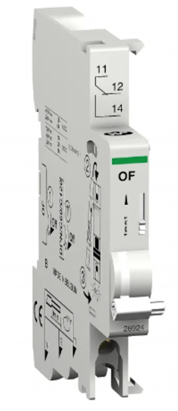

There are auxilliary contacts available (ususlly ½ module width) to add to the side of a MCB (1, 2, 3 or 4 pole) which I've seen used as a neutral break however they are usually only rated to about 6A and designed to be a control signal to show the MCB has tripped or to restart the timer in a λΔ starter for example.

However I am not talking about this, I am talking about yellow bricks, and as again @SUNRAY shows they can deliver 40 amp to earth from a 16 amp socket.
To use a classification often refereed to, are these transformers dangerous, potentially dangerous, or should there be simply a warning on them, remember fire is dangerous, not so much looking at shock risk as to fire risk.

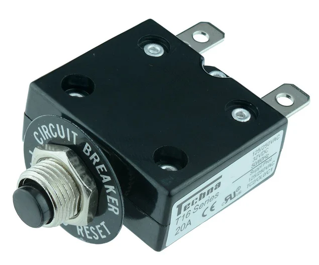

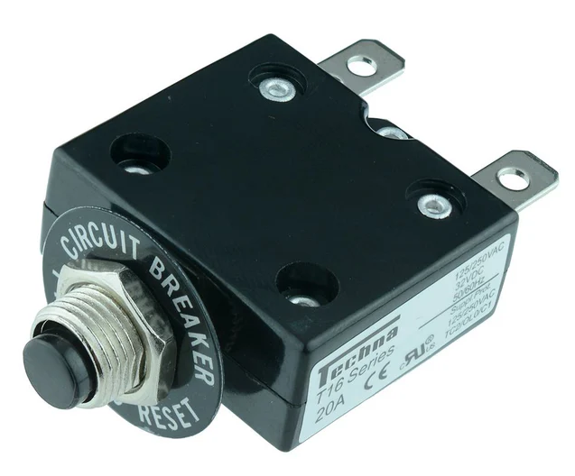

To have a transformer with two 16 amp sockets on one 20 amp double pole MCB may be technically exceeding the rating of the socket, but in the main 1.5 mm² cable can take 20 amp without melting, however it can't take 40 amp without melting. To fit two 20 amp 1715856843779.png overloads on the output even if not linked would remove the fire risk, but a 10 amp on input only protects the transformer primary winding.
So when doing the inspection and testing of in service electrical equipment, should transformers without protection on the secondary fail?

To have a transformer with two 16 amp sockets on one 20 amp double pole MCB may be technically exceeding the rating of the socket, but in the main 1.5 mm² cable can take 20 amp without melting, however it can't take 40 amp without melting. To fit two 20 amp View attachment 343328 overloads on the output even if not linked would remove the fire risk, but a 10 amp on input only protects the transformer primary winding.
There is no easy answer and there are other questions involved, such as what lighting load do you have on yellow bricks as technically they are designed for intermittant tool use and the continuous rating is usually around 50%, from memory I think my 1.5KVA is 800VA and 3.3KVA is 1.8KVA and I know from experience a 1.5KVA will trip it's thermal overload when running at 1KW continuous. IE: Lighting festoon hired from a plant hire company with 40*25W for an outdoor carol concert, luckily I'd thought to take the 3.3KVA as a backup and even that was running hot outdoors in December.
