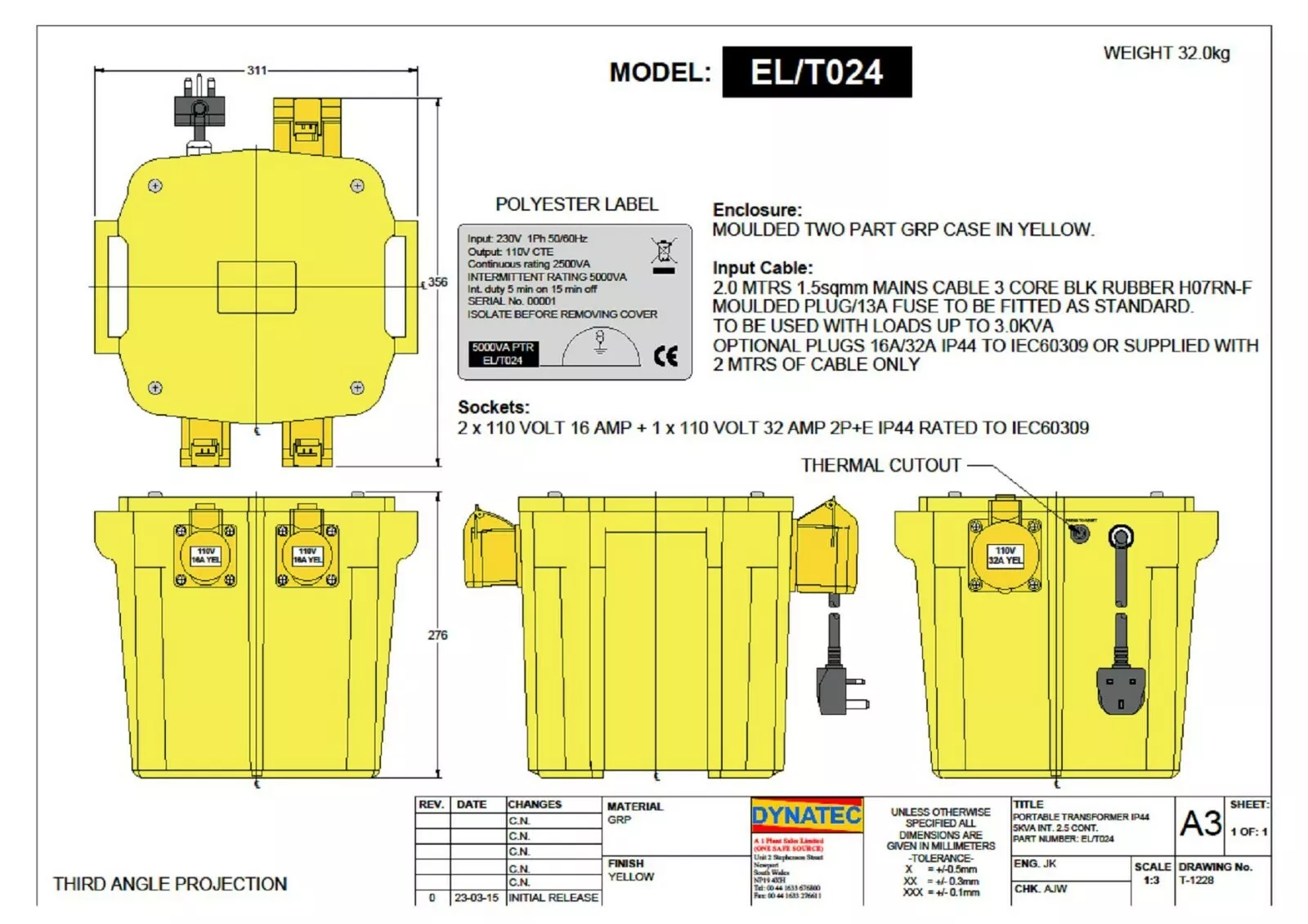

The standard MCB/RCBO is too large to fit in the yellow brick, and they do not have appropriate weather proofing, the small thermal only trip does have a cover which can be used, and as far as RCD's go, there is a problem finding ones which will work with 55 volt, there seem to be some in line versions, as to if it really needs RCD protection for the extra 5 volt is debatable.
The biggest problem with on site 110 volt supplies is fire, and a path to earth is needed to get the 40 amp, so use of a RCD would help, not against shock, but from fire.
As to TN or TT it hardly matters the yellow brick is portable, so it may end up with either.

The common situation is a long 230 volt lead feeding a brick which then feeds the lights, and one does wonder what is the point, they want the brick local to the user so they can remove the 230 volt supply, so the brick does not get left powered up, as even with no load they get quite warm, however that seems to defeat the whole point of having 110 volt.

Over 3.5 KVA the transformers tend to have overloads on the output, and at 1 KVA to earth only 18 amp, so 1 KVA and under not a problem, it is the units between 1 and 3.5 KVA. A 16 amp unit will draw 7.65 amp at 230 volt, and has a 1.76 kVA load, so there is really no need for a yellow brick to be over 2 kVA. OK that's still 36 amp at 55 volt, but that is better than 54 amp which equates to 13 amp at 230 volt.

The 1.5KVA I repaired had a 6A thermal trip or ~1380VA, reflecting that into the 55V secondary ~25A. However that is effectively a 'working current' not fault.
I purchased a 3.3KVA due to finding the fluo task lighting would dim significantly, sometimes extinguish when starting power tools when using a 1.5KVA.
