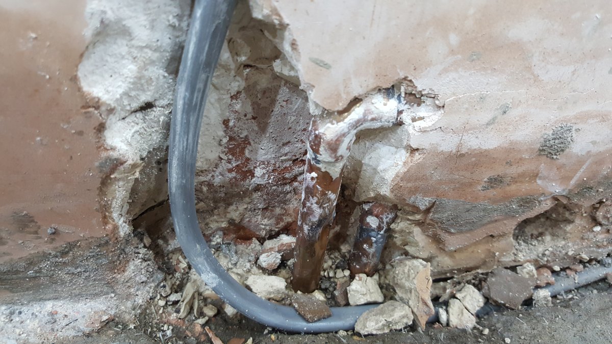

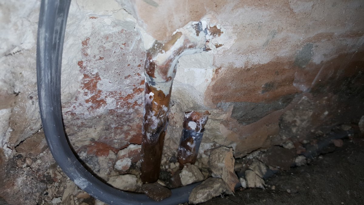

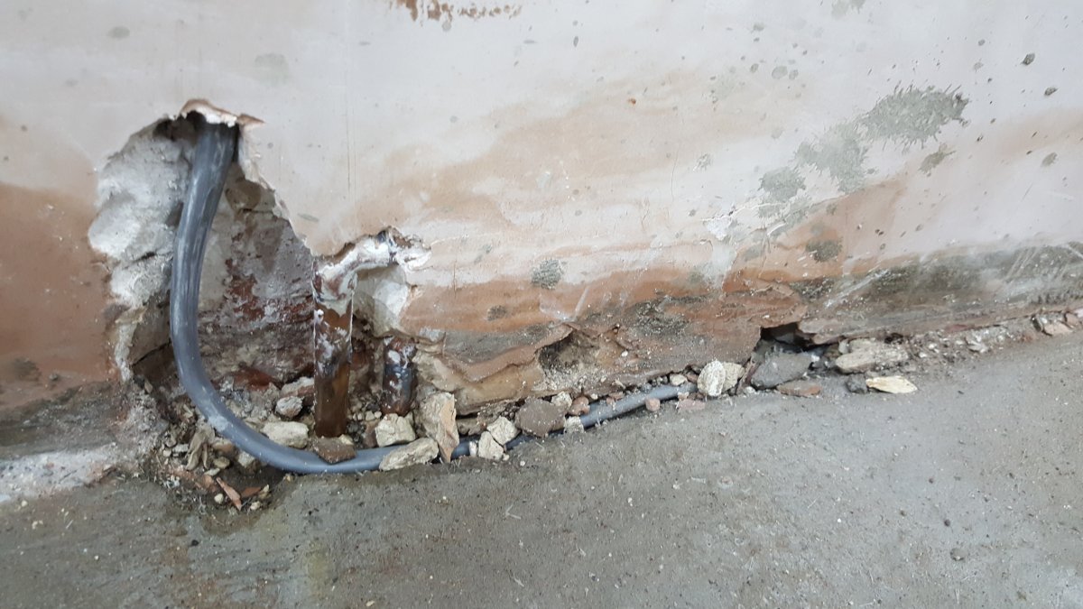

He cut a channel in concrete floor, put cable and hide it as show on picture
During his work he damaged a central heating pipe which promise to fixed until 17:00 (still not fixed).
Any way. Is there any regulation about laying cable on concrete floor on ground floor next to central heating pipes? I want to put tiles on floor but it is doesn't look good for me. I'm not feel safety when i see that cable.

With regards to central heating pipes and electrical cable.
In your case they must be separated, as the heat dissipated by the central heating can and probably will scorch the sheath (or worse) or the twin and earth cable. It will also have some effect on the current carrying capacity of the cable.
This guy coming into your house performing electrical work is a cowboy and I doubt some of his cable safe zoning is much to be appreciated?
I would have expected, at the bare minimum, for that cable in the concrete floor to be in some plastic conduit - if only to offer some minor protection, and to keep the cable off the pipes.

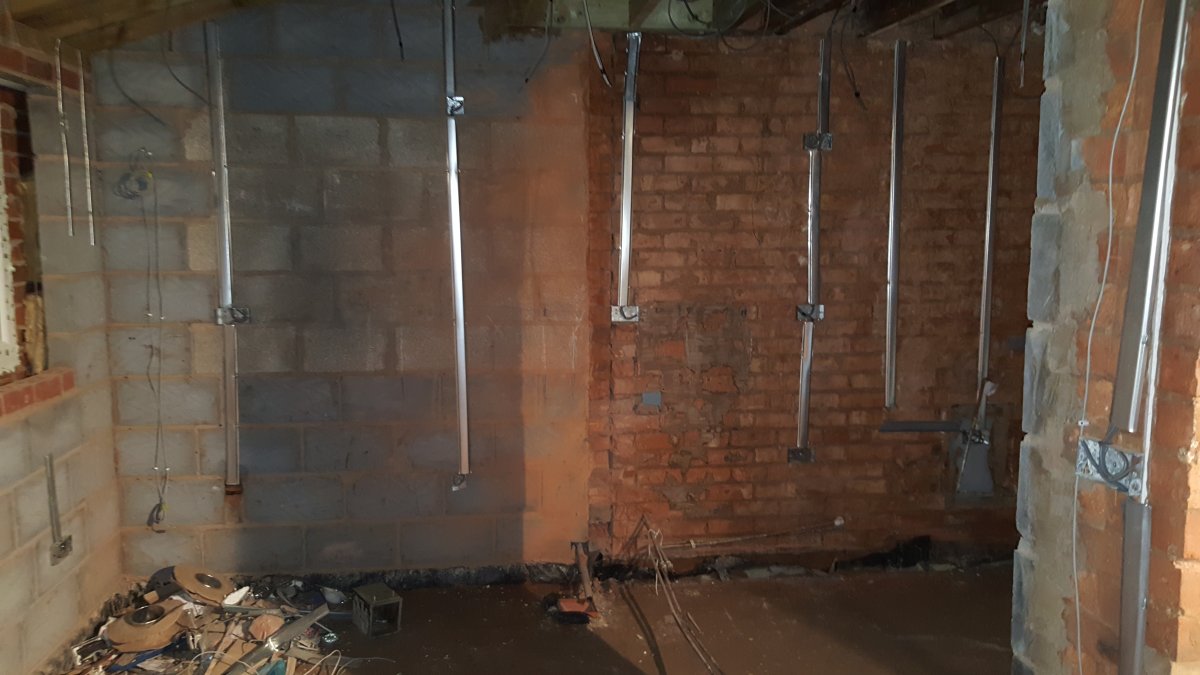

I did not take many photos before plastering.

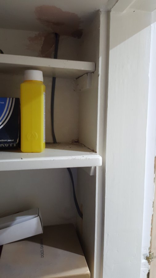

He cut of lights of my downstairs bathroom. After that damaged a lot of my house to find and connect correct cable. When he find connect it to switch like on picture bellow.
Top picture.
The cable drops on the left hand side start to give a bit of confidence reference cable zones but then that starts to fall apart as we look more to the right.
Bottom picture gives no confidence whatsoever
Is this company covered by a scheme? In which case, get them on to it. This is atrocious!
