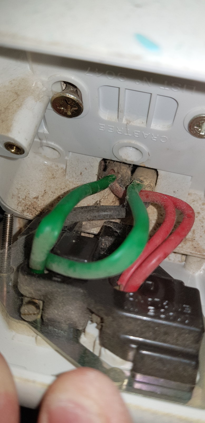

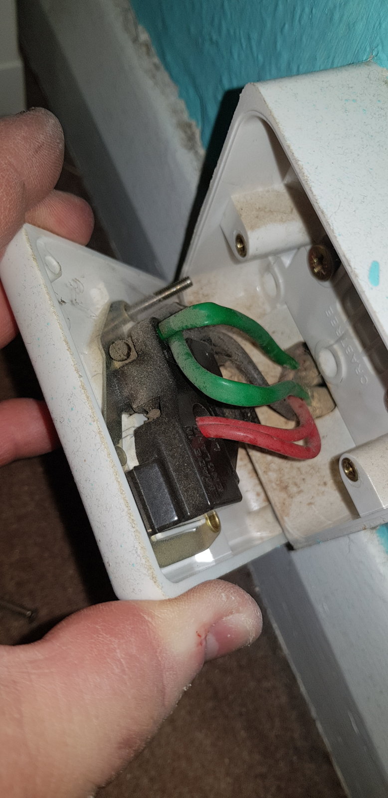

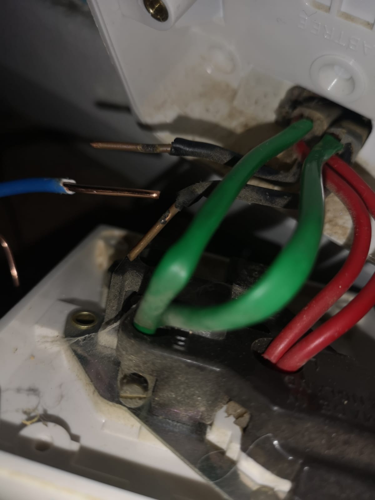

Yes, thats correct, if the left fuse is of but middle one is on then most sockets are of...i also looked behind 6 sockets both upstairs and downstairs (from both 32A fuses) and all are in 2.5mm cable...there are more sockets but not so easy to get to but can check these later...so seems like most of house is in 2.5mm
1970s wiring.
That looks thicker than 2.5mm to me.
Well the one with 2 cables.
The other one looks later and could be 2.5
Can you see a difference in person?

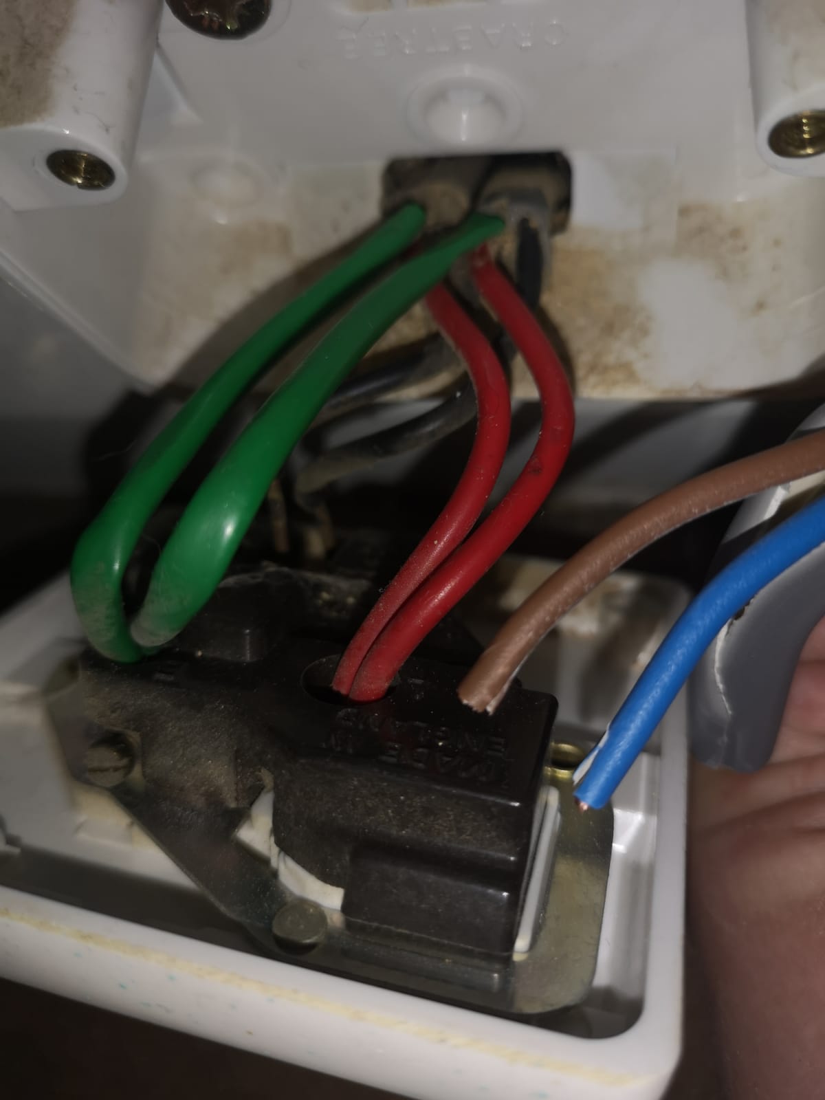

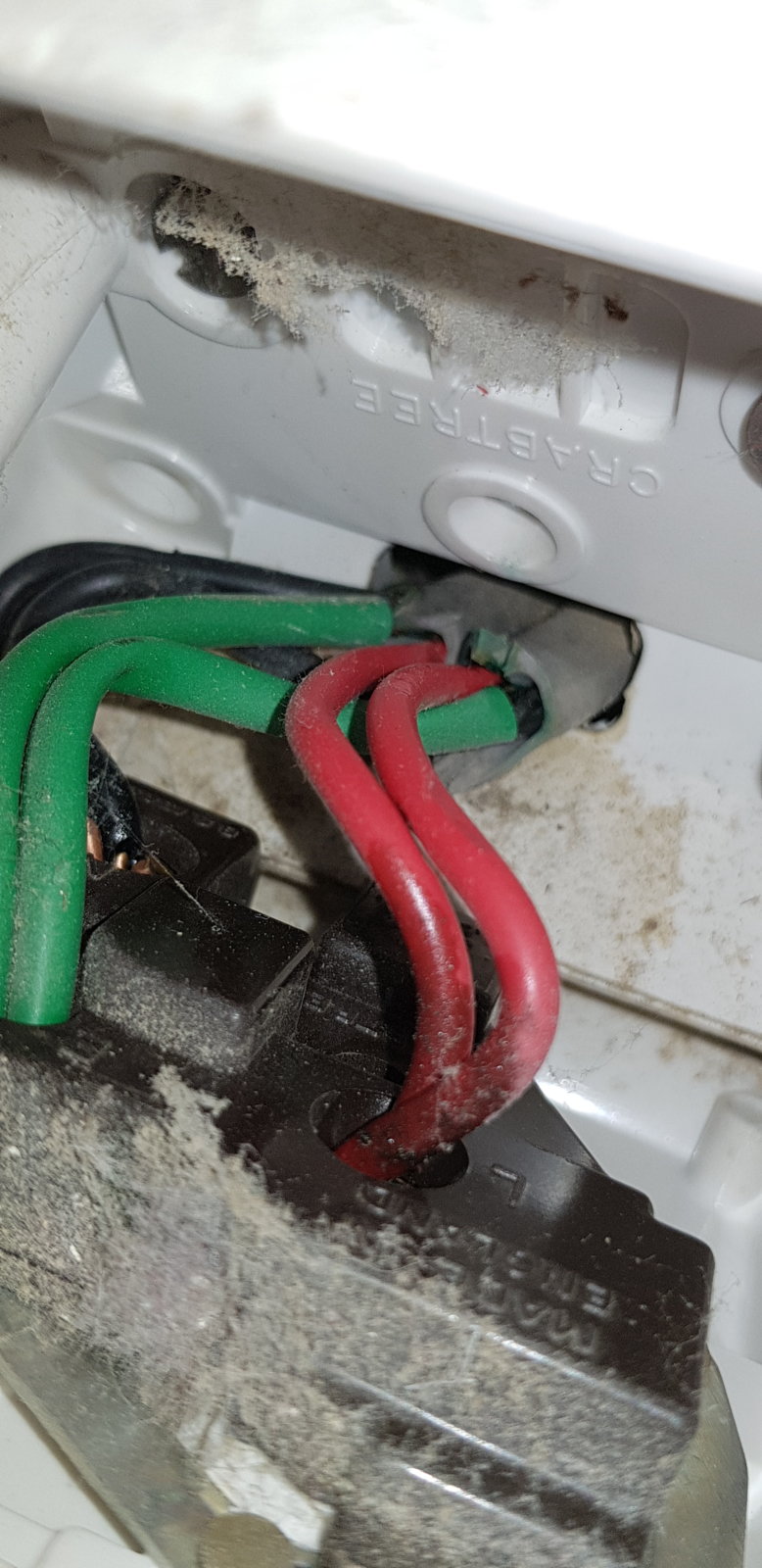

Not sure if these help more, they are different sockets...but looks same as 2.5mm a far as i can tell..i will try and get a better idea when check other sockets

Can you wipe off the dust of the external insulation in those last three shots?

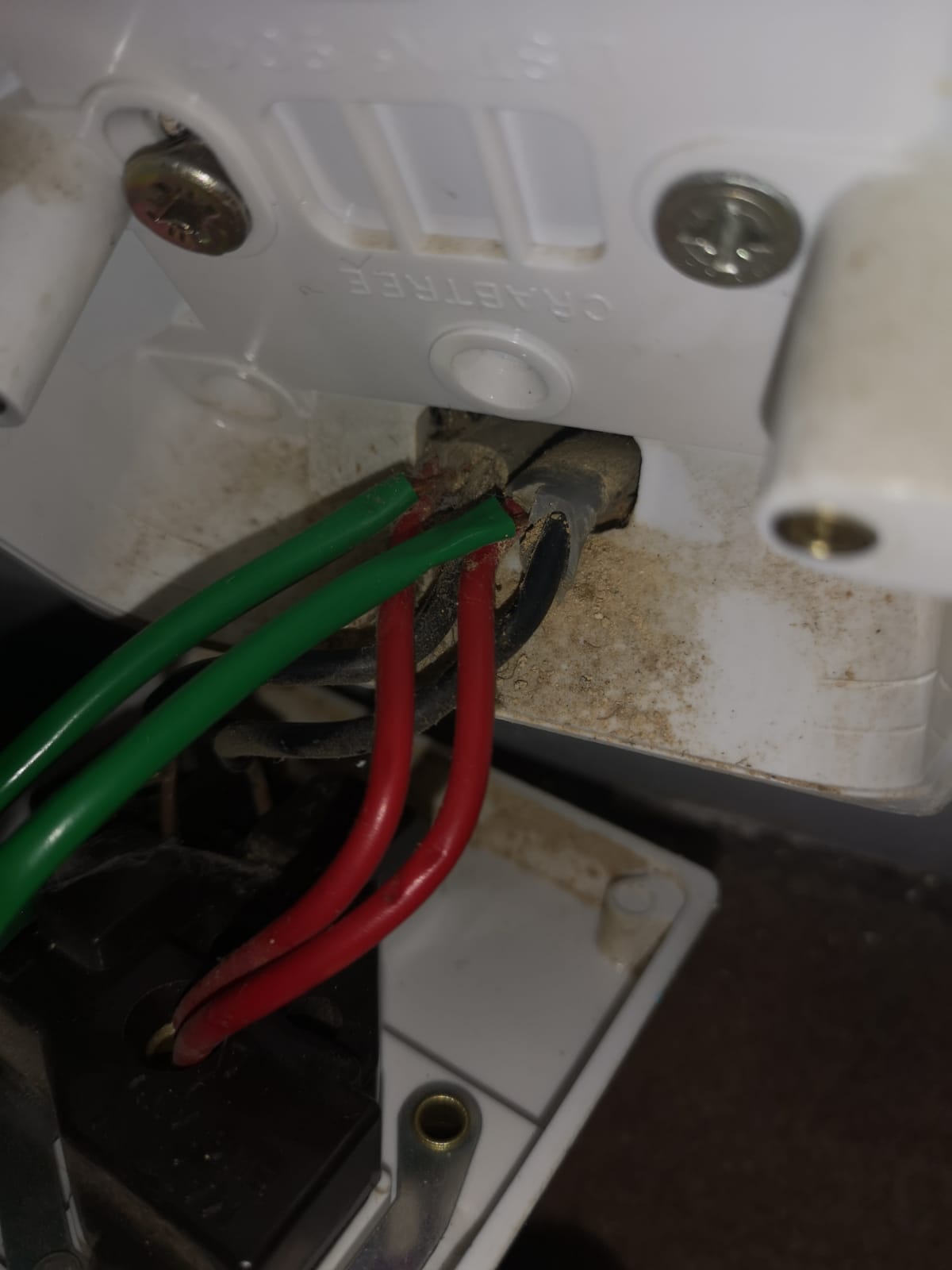

I tried to get better pics...and also compared to some 2.5mm i had and i think is same...unfortunately i dont have any 4mm but i guess it would be obviously bigger?

Almost certainly 2.5mm² - the 1970s stuff is likely to be stranded core rather than solid, which will make it appear slightly larger.
4mm² would be noticeably larger, and would be a very unusual size to find in a domestic dwelling particularly from the era of rewireable fuses.

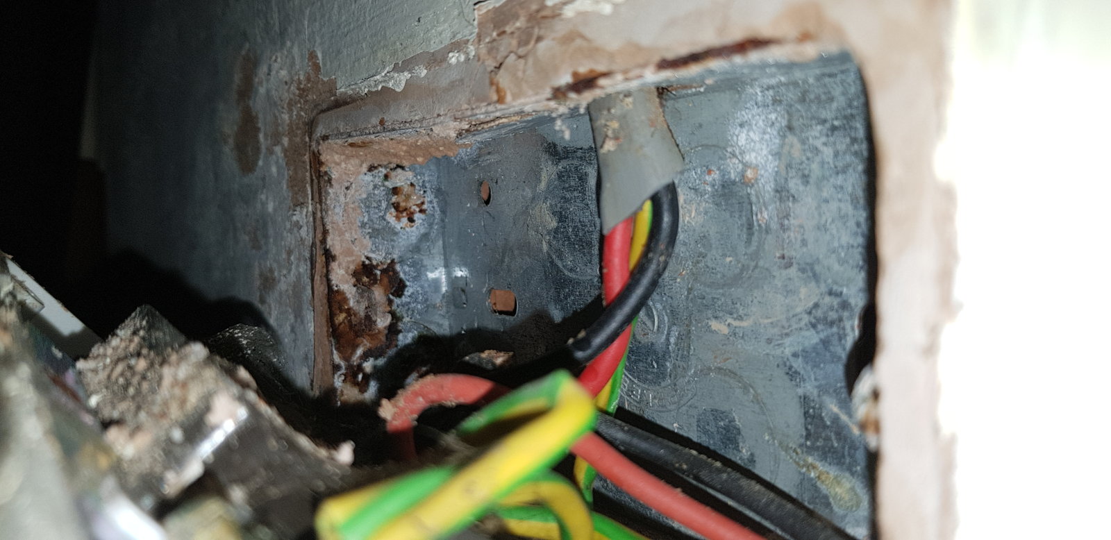

I think the 4mm from the MCB must go to a socket i havent yet checked and then pretty much the rest have been added using 2.5mm.
So does this mean i should replace the 32A fuses with 20A to be safe?
It sounds like the ring circuits start at the junction boxes, maybe the fuse box was moved at some point? I would suggest getting someone in to test it properly as any advice given here could be based on guesswork, but if you get a decent electrician and explain what you have found, they will be able to give you the information you need
