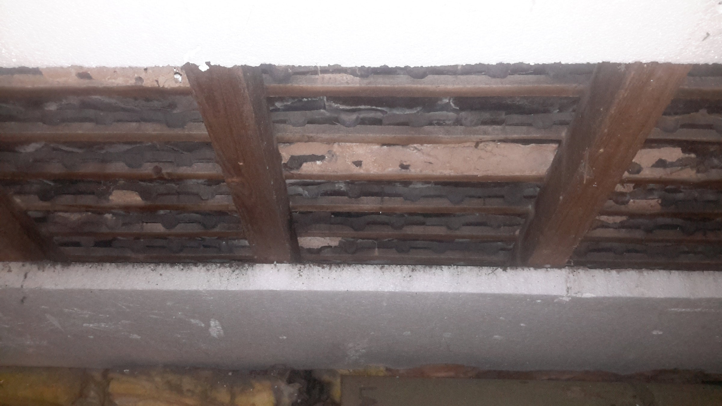

ok, thank you for all of your replies - I haven't heard back from conveyancers yet - no surprises there. However, I thought I'd post a couple of photos which should help the discussion along :-
I have pulled a section of the roof insulation away and it appears that I have no membrane under the tiles or insulation between the rafters and only 50mm simply polystyrene on top of them. No wonder it gets windy up there lol and its certainly gonna get cold !!. the rafters are only 80mm deep so I guess will need to battened to allow for proper depth of insulation between the rafters whilst leaving a gap of 50mm ?

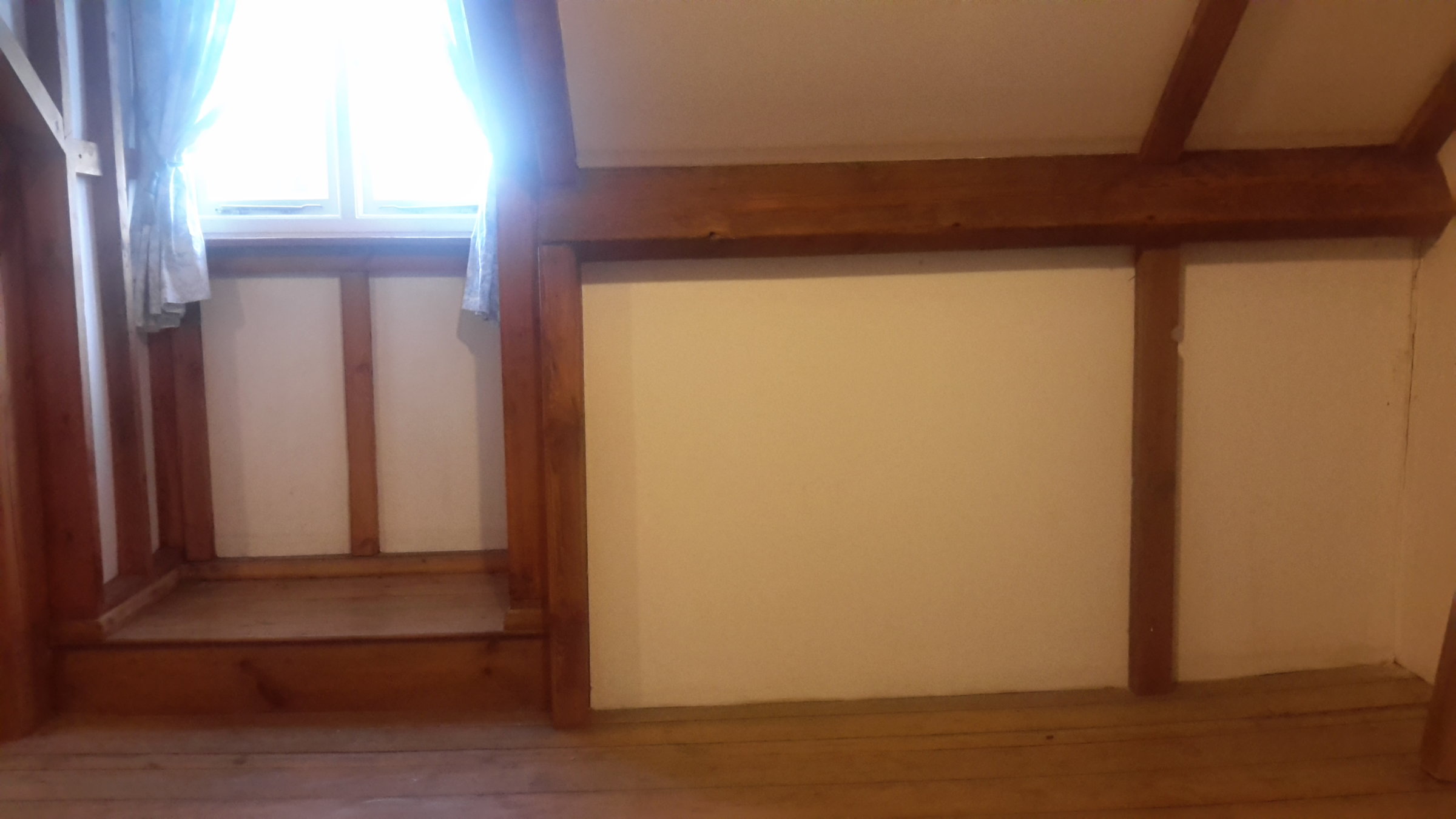

The second photo below demonstrates my worry. The floor clearly dips down to where the dormer has been installed and the purlin has been cut to accommodate it and then supported with two vertical struts. Now remember the floor is only 3x2 and is now supporting the dormer and now some of the roof weight ??. Please advise - much appreciated.
