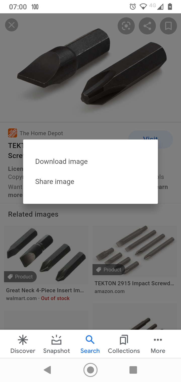

I used to wonder where you got the giant screwdriver to undo these and then I remembered my old impact driver from my motorbiking years:
My stepfather gave me an impact driver/screw remover a few weeks ago. I had been whinging about removing some door hinge pozi drive screws that had been painted. I haven't had a chance to try it out yet though.
