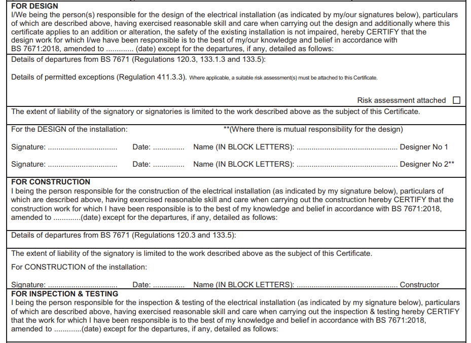

well id imagine he takes responsibility for the installation is the gist
Which part?
the design ?
the construction ?
the inspection and testing ?
or some combination of those three things ?
The problem is that if you or someone else installs things which are not compliant, it's then far too late when this person arrives to 'sign off' whatever it is they are taking responsibility for. The only option then would be rip it all out and start again.
That is why all questions relating to this installation must be directed to this person - and not random people on a forum who know nothing about this installation or the circumstances in which it being installed.
If you discuss the work with your electrician first, and he's happy for you to do the donkey work to his specification (and I'm sure he will be MORE than happy for you to do the donkey work) then it's down to him.

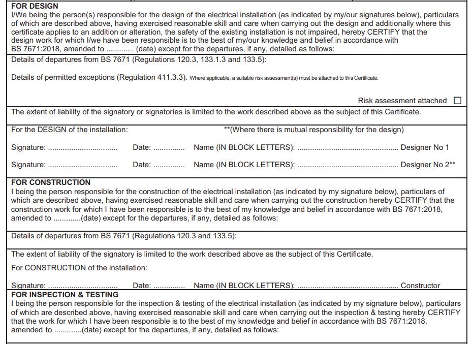

Which part?
the design ?
the construction ?
if he signs that form, then i assume hes intelligent enough to know whether he should sign for it all or not. I never said i was installing the tails, i will almost certainly run all the cables around the house on his advice so ive no need to worry about being compliant, he is going to see it all and then he can decide if he will sign it off or not.il
i asked general questions about meter tails, anyone who doesnt know the answers perhaps didnt outght to comment, and seeing as he will def do an inspection at 1st fix stage theres hardly likely to be any need to do any major ripping out. Thanks for the help though
Exactly, im pretty sure he will let me crawl around in the loft, and be in all other inaccessible/dirty places instead of him. Easy money for him.
