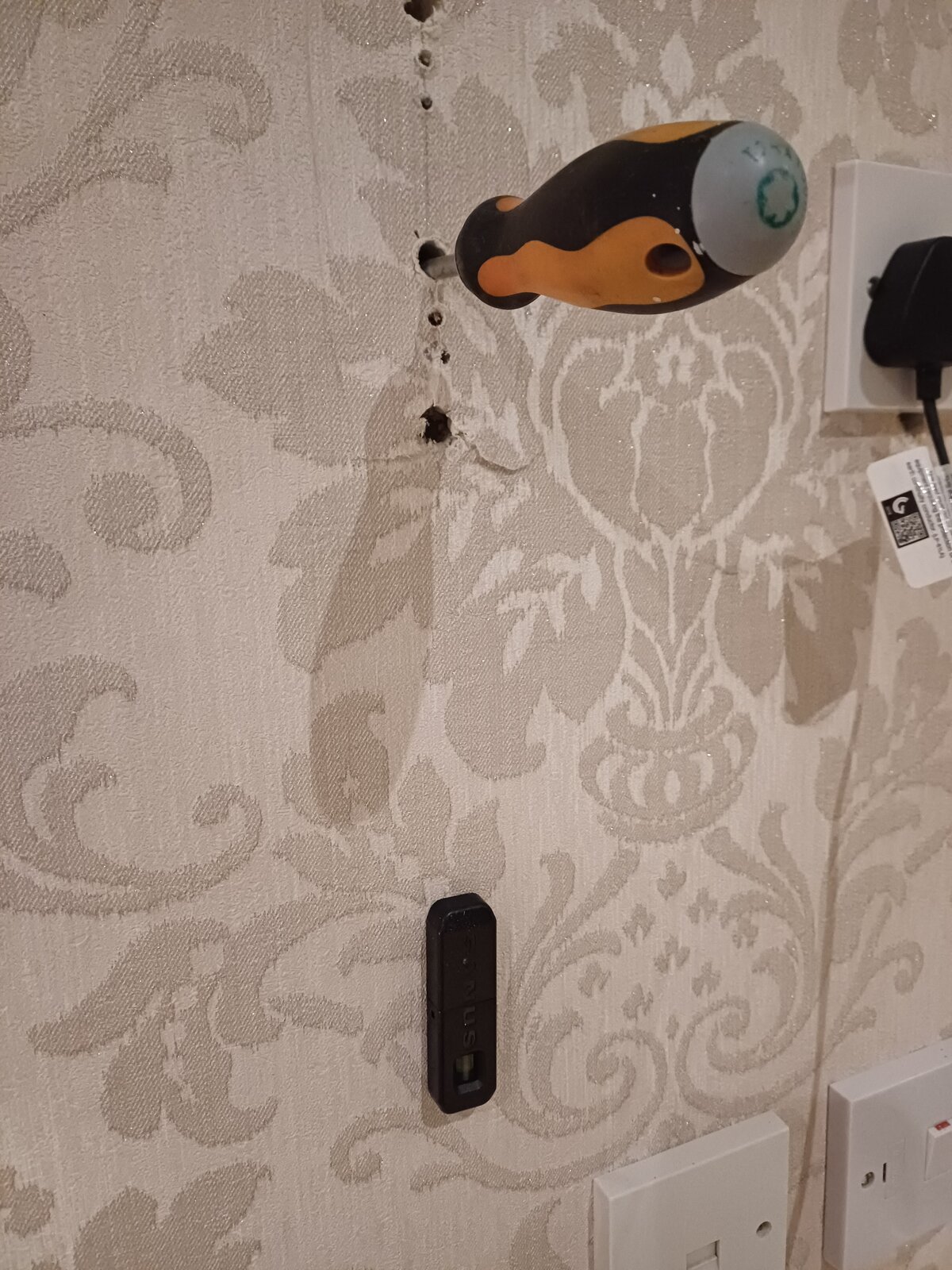

65mm plasterboard. Is this possible?
You would drill or shove your screwdriver into the existing holes.
Ah OK. It's a bit late for drilling but the screwdriver isn't picking up sawdust. All I can add just now is a photo showing the screwdriver 65mm into the wall, and directly below it is a magnetic stud finder that's found a nail or screw. If that screw is going into a stud then how can the screwdriver be going through 65mm of plasterboard?

My 1914 reno would show exactly the same as you're seeing.
It's almost certainly 50mm metal stud plus 12.5mm plasterboard plus a plaster skim - that would be your 65mm
That's a mighty bold claim and one I would argue is unfounded.

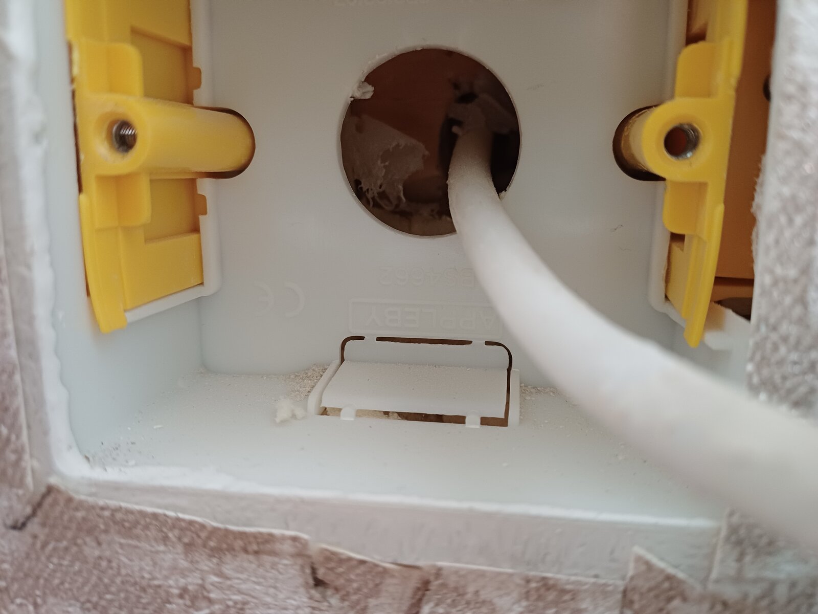

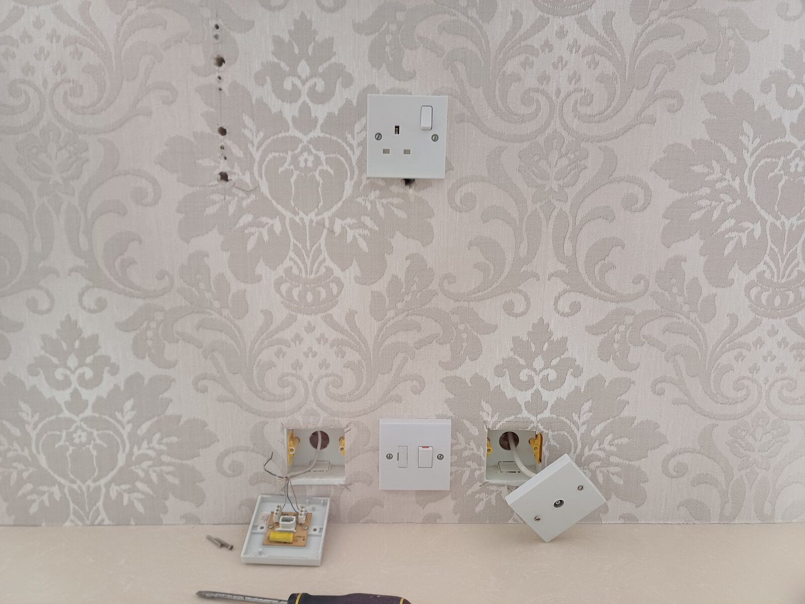

Behind these two boxes is a layer of insulation board, presumably with a layer of plasterboard on top, with a batten behind. Possibly a noggin between two studs either side. It's about 60mm from the wall face to the batten. You can just make out the insulation board and batten in the photo. I didn't remove the dry lining box because I didn't want to risk tearing the surrounding wallpaper.
