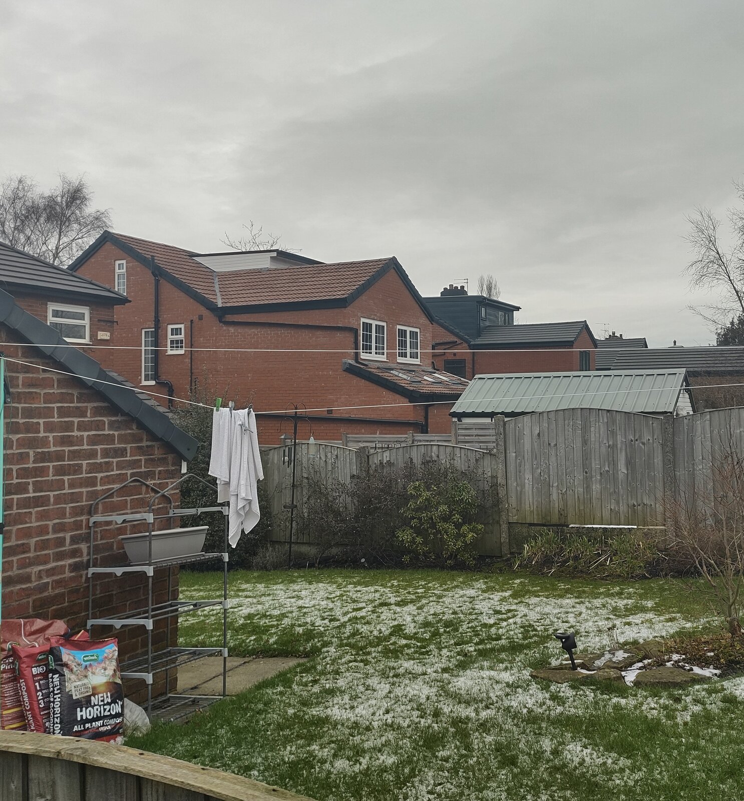

Thats a wide 1st floor extension on your neighbours !

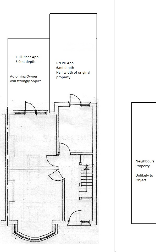

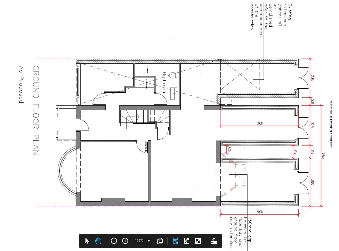

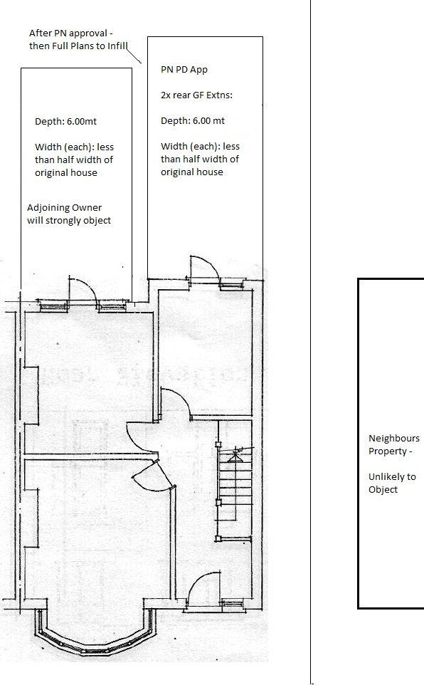

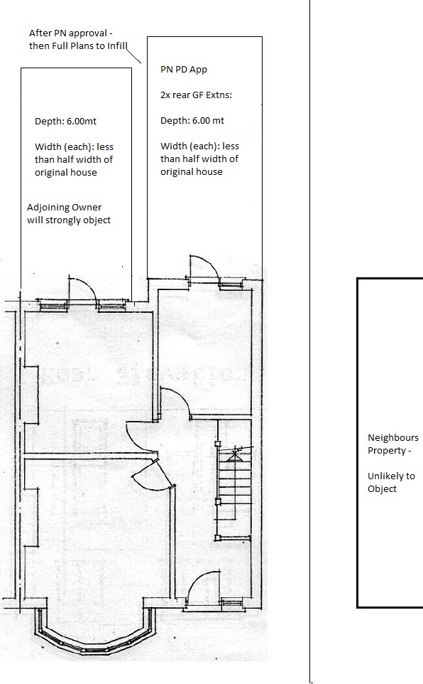

My Council state a 3.5mt rear extn is acceptable, but you can have any number of pointless thin extensions that are less than half the width of the original house, this one gained 3 of them under PN PD, if no one complained, you can guess what they will be doing with the daft gap ... I'm not sure why they didn't use 'half the width' of the house including the 'garage' (see my note below) and have just two larger extensions with a daft gap. Maybe they had lost the Will - it took them 3 apps in all to get here ...
The bottom two thin extensions went in as one PN PD app. which was approved (ie approval not req.) the top one was then submitted, again as one PN PD app. and again approved, what is interesting is the top Extn. appears to be on a new side extension, however that is an existing garage that runs the length of the flank wall, how they proved that was original I am not sure (ie pre 1948), which is to be demolished nd rebuilt with cavity walls.
I am considering submitting a PN PD for less than half the width @ 6mt, built on the side of the house thats away from the neighbours side (left) who will definately make a lot of noise and complain, I may have to cut it back to say 5mt (which is what planners seem to want happen where there are objections), that will establish at least the projection and a depth to come off - if approved then apply under Full Plans for the other side at 5.00mt, again I may have to pull that back to 4 or even 3.5mt (3.5mt being what they approve under full plans), and if necessary vault the roof on the adjoining neighbours side, to bring the eaves down to 3mt. this will all hopefully avoid having to go the route of two thin extensions.
I'll ask the council, see what they say ...

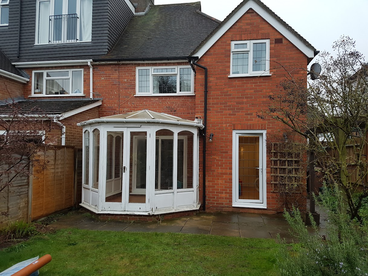

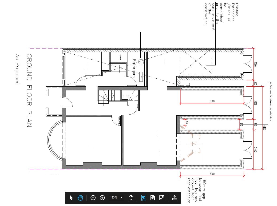

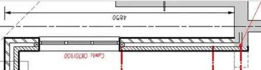

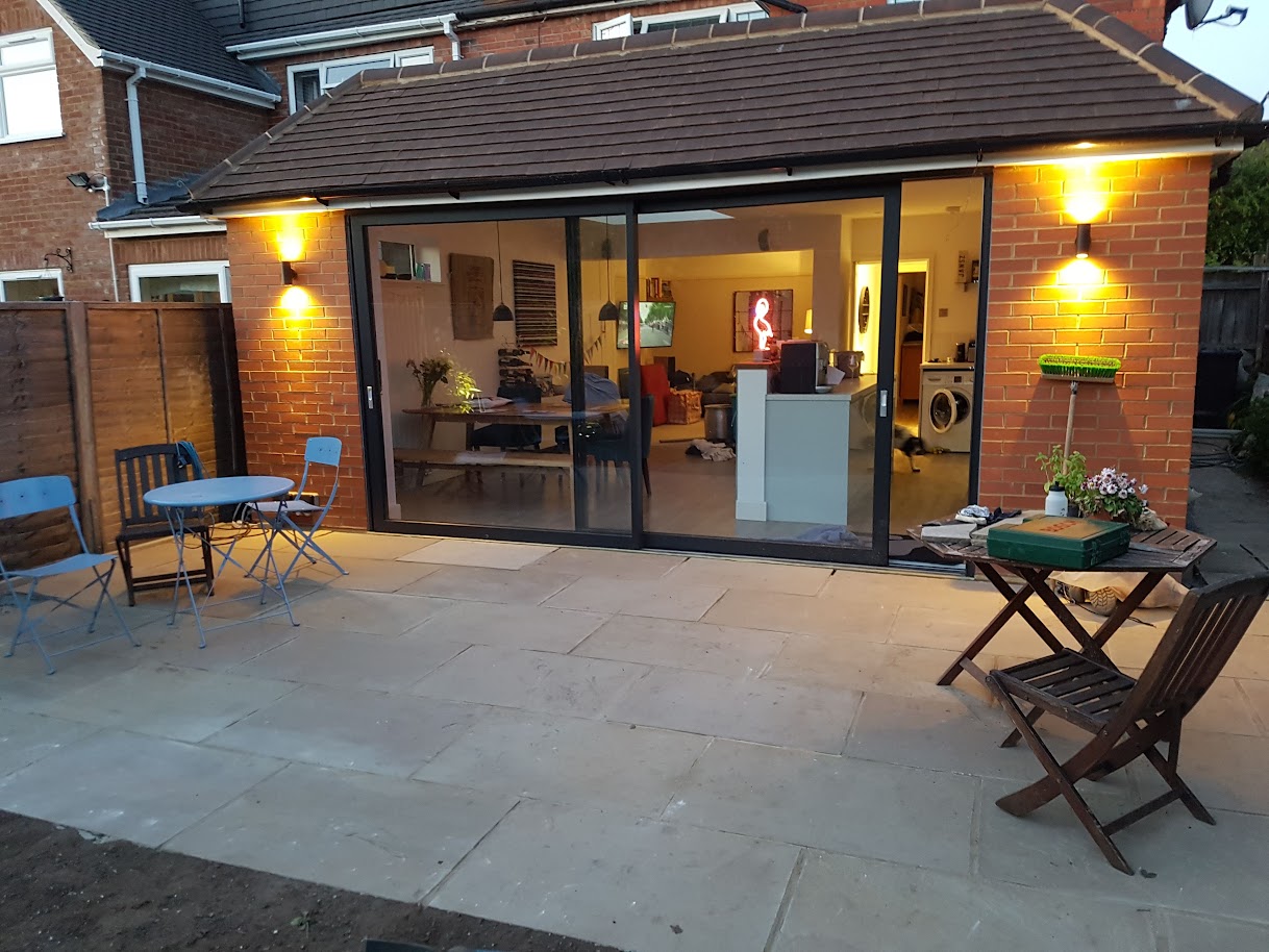

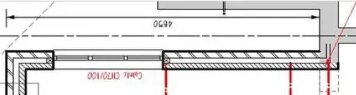

This is what we had approved on appeal. (Declined by council).

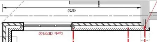

False pitch permitier hipped roof, flat roof inside. 4.85M. Original PN was parapet walls and flat roof, 5M depth of original elevations, on boundary line, zero projection eccentric foundation. There was another PN before full plans, that was someway between final plans appeal and original PN. I can't quite remember off top of my head.

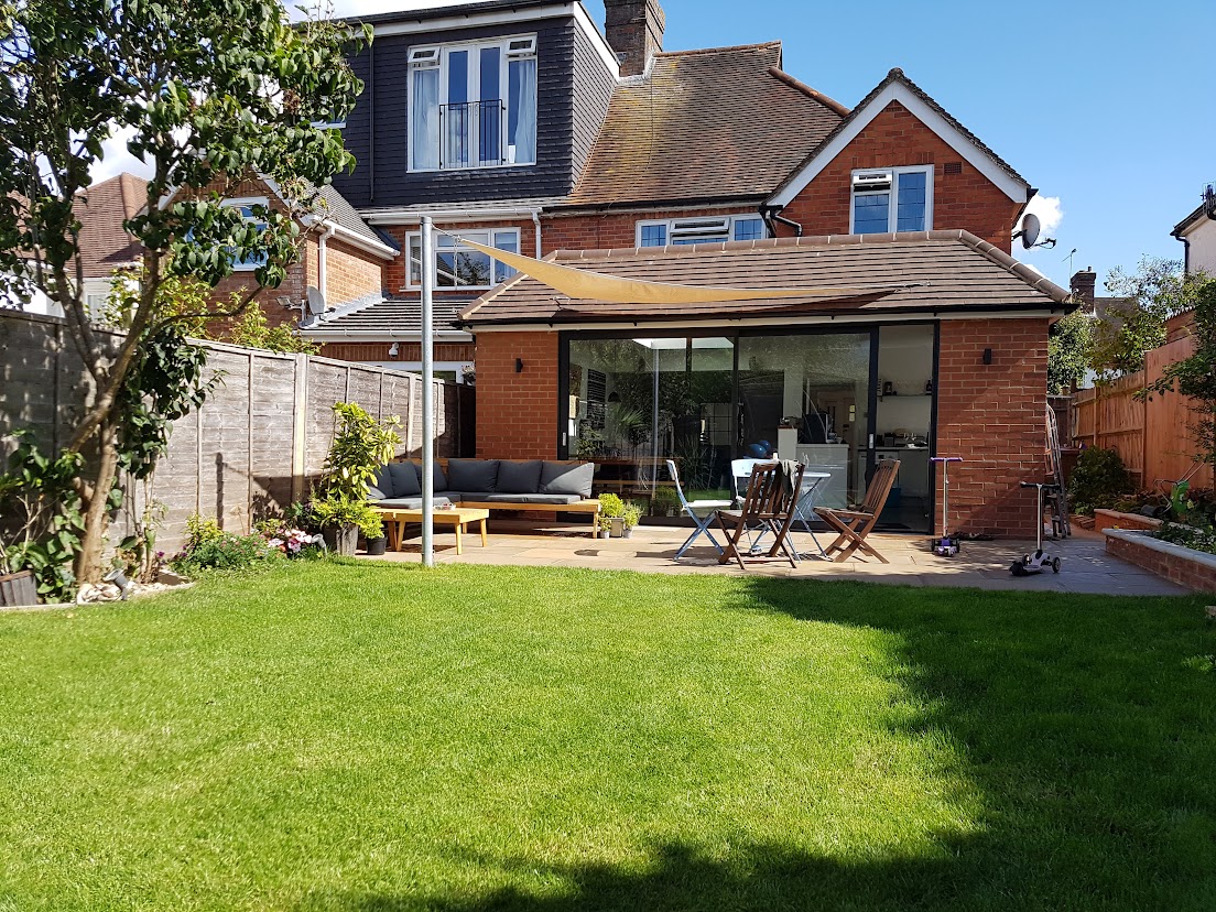

@GoodDIYjob - thats a Good job, but was it a DIY job, how long did it take you ?
I see you didn't go right up to the party line with the wall, any reason ?

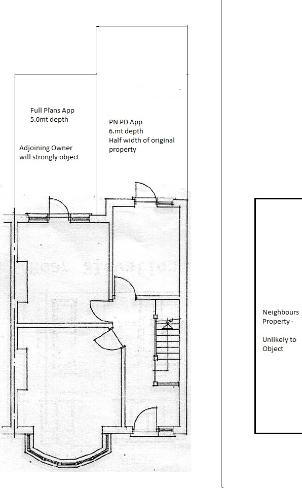

So going on the staged PN PD then Full Plans approach, we get this:
Assuming the council will require some consession for the objecting neighbour under the PN PD, I would expect to have to reduce the depth of either one or both of the thin extensions by approx 1mt to get the PD approval. And then appply under Full Plans to infill. And possibly somewhere in there the False Pitched roof along the Party Line.

Our journey started in 2015 and crossed 2016, so wait times may well not be reflective of now. From recollection, the planning inspectorate give current indicative appeal wait times on their website.
In our case, from having our 3rd application declined, it was about 6 months for the inspectorate to complete the referred appeal.
With all the messing around with the other 2 applications and council decision on the final app, it was well over a year end to end.
But all this was well before covid 19 and staff shortages which have brought council planning departments to a standstill and I know one or two people who have waited nearly a year for a single council application decision. A lot will depend on how your council is currently resourced and turning things around.
The boundary step in was required 1. In moving from parapet to false pitched hip roof in final application - there was a overhang for soffit and gutter required and 2. It resolved a small breach of the 45 degree as the neighbouring extension was also very close to boundary, with a wide patio door and very little brickwork before the corner. In fact their property also had another large window on the rear elevation beyond the patio doors assessed for 45 degree rule.
You'll notice our neighbouring property have a "small" dormer on the back of their property which involved a hip to Gable, change of plain tile colour.... and of course isn't overbearing at all. Clearly that sort of outcome wasn't properly contemplated. It's also distorted all the semi front elevation now as it's not balanced any more and the hip roof between properties gives so much more feeling of space and light from a streets cape perspective.

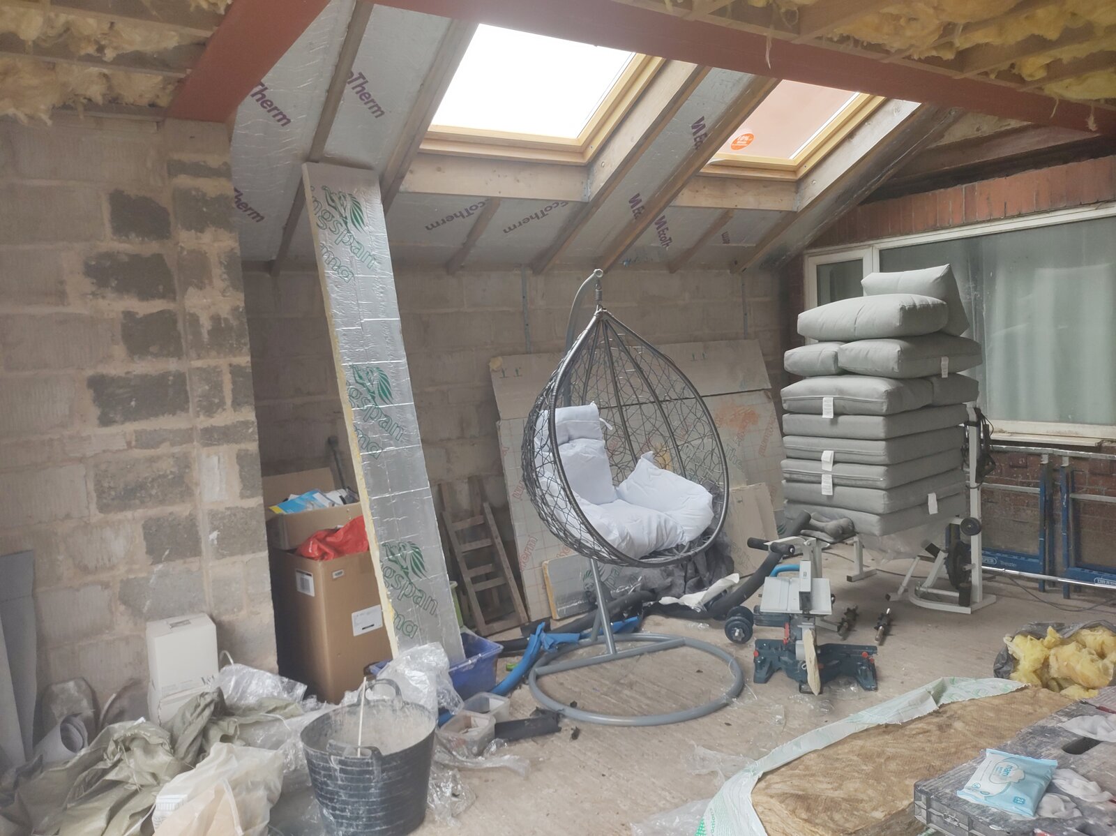

Ha ha. I did a bit yeah. After falling out with the builder who did the structure.
I dealt with his list of snagging for a month or 6 weeks, which was pretty substantial. I did the outside hard landscaping you see, shade Sail. I engaged final finish contractors and a carpenter including resolving all the bits that were so crap, they had to be dealt with rather than moving forward to finishes. I did all the bits that weren't someone else's job and seemed to fall between the cracks.. i recut window boards and got a plasterer to straighten up reveals. I did av wiring, cat 6 and wireless access point pre wire etc etc..
