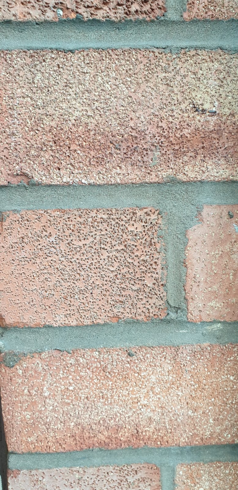

I'm continuing to plan a 2 storey extension. Ive looked at the existing brickwork and the bricks are 70mm, rather than 65..... 3 courses measuring 240 mm. It appears 70 mm bricks are universally rare.
If I find a suitable metric brick, how difficult would it be to tooth in to the original house? And how well would a decent bricklayer be able to match it in......

Toothing is not possible with differing size bricks.

Yeah, I thought they must be 73, but measuring them, they're 70.... I've checked the height of 3 courses in a few places too, and its pretty much 240 mm.
It depends on what part of the country, but most Imperial bricks since the 30's were either 2 5/8 inches or 2 7/8 inches, but some were in between.
You might be able to tighten up the joints with 73mm ones.

I've measured a few more now, and I believe they are 73 mm bricks. The brickwork is pretty poor tbh and the joints aren't that accurate. Just need to try and find a match for these bricks.....

Try a Carlton priory pinhole, its hard getting a perfect match due to weathering, if your knocking down existing walls it may be possible to use these at front if side extension.
