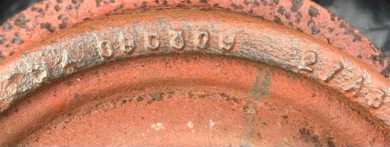

Just a follow on from previous threads, I have cleaned up what looks like identification letters/numbers which may lead to finding out more about the source of the 8" hub. If anyone can throw any light on that? Thanks, Terry
