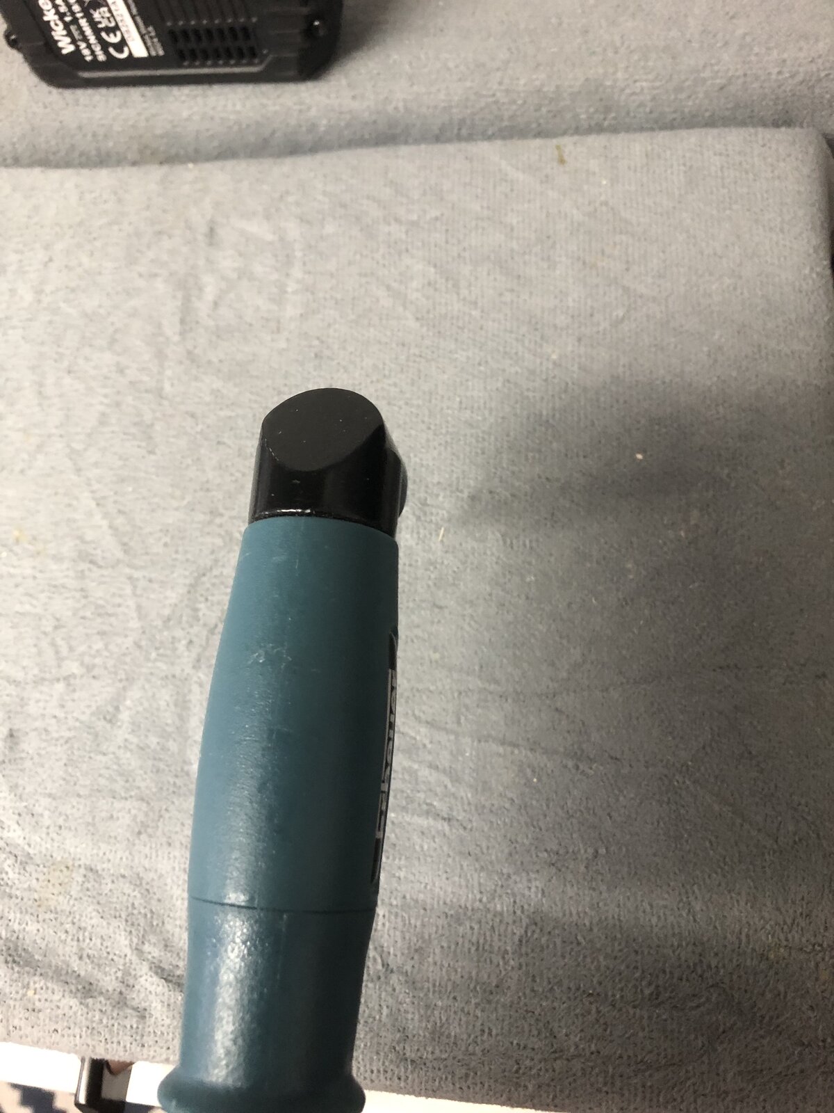

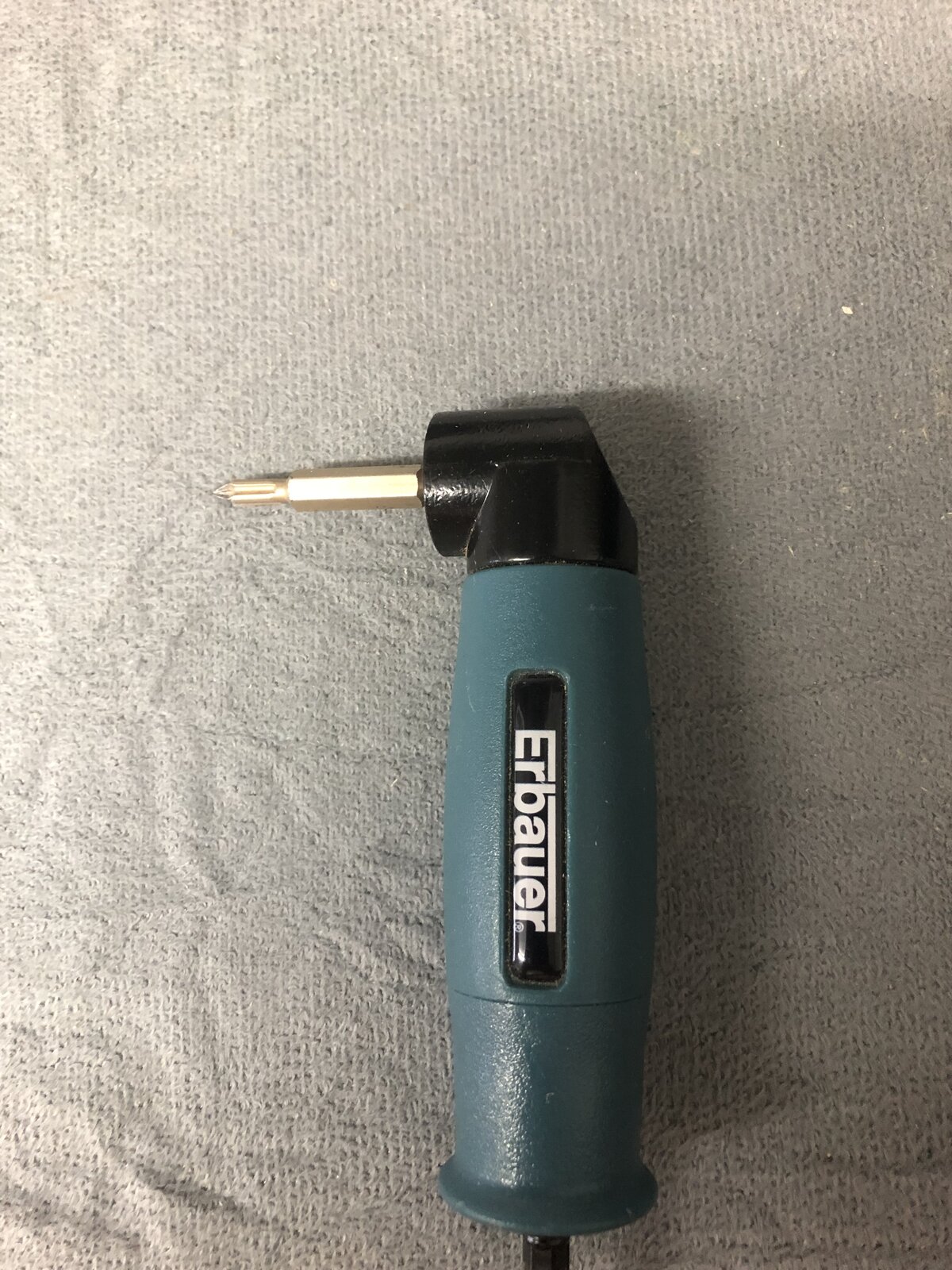

When I hold the angle Chuck, the driver bit stays where I need it. Photo one shows this at a 90° angle.
As soon as I let go of the angle Chuck, it “drops” back downwards due to gravity. See pic 2.
I don’t have the space to get my arm in behind the leg of a table, or pipes for example, but as soon as I can get it in the correct position, I can use my other hand going around the opposite side of the leg and get my fingers around to pull/push to get the screw in or out. It’s a massive pain trying to get everything aligned.

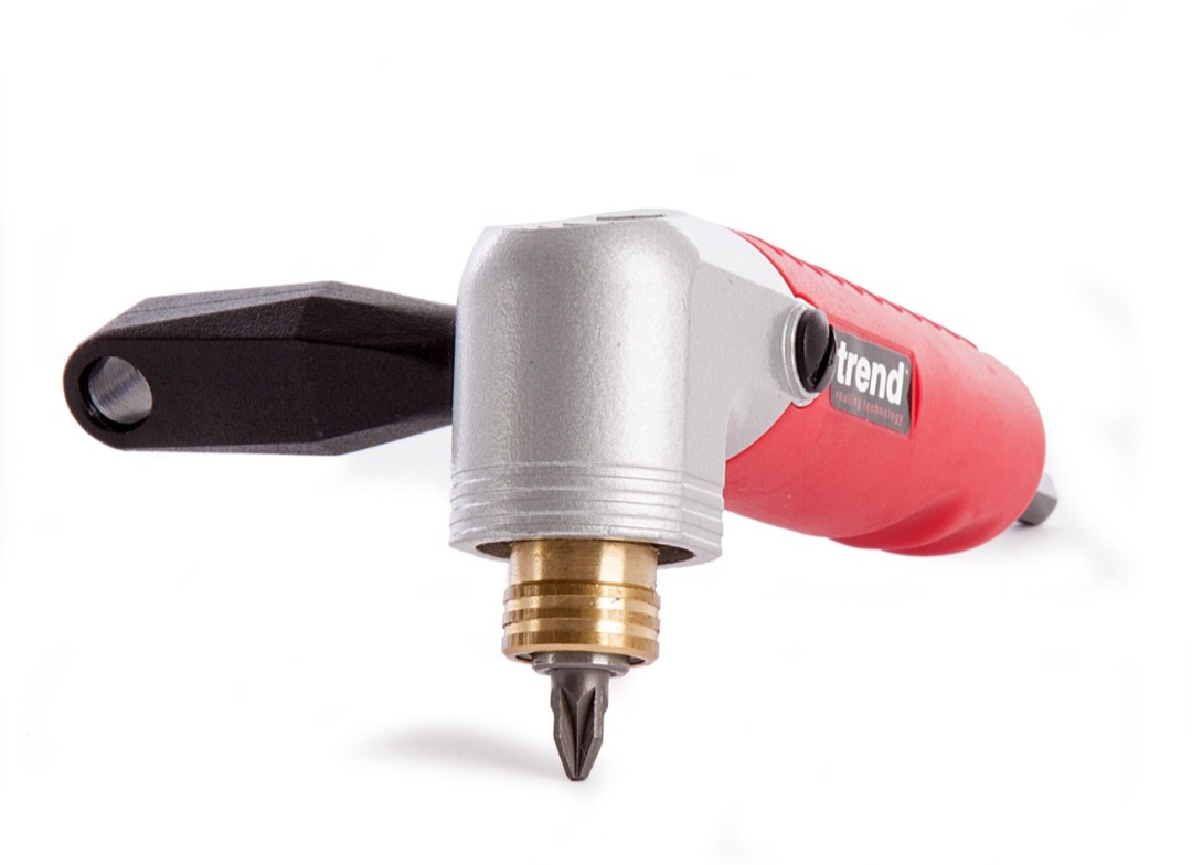

On my other one that’s not at 90° there is a little “fin” that I can keep my finger on to guide it, I can’t find it at the moment but a little like the one in the link. This one has a huge “fin”, my other one is some 25+ years old.
That’s poorly designed for right angle use , I have the one in your link which is much easier to use .
You could tape a long thin stick or dowel to it so you can position accurately .
I bought this Trend one years ago it does come with an unscrewable handle to stop it spinning through 360 degrees when you are using it, but...like all things carpentry you need the 3 hands, one on the drill, one on the handle, one holding the screw.
£45 or thereabouts....I lost the handle the first day....
I always find them best to use with the extra handle on, helps me keep it at the right angle.
However they are all a bit of hit and miss, if you cannot get your hand in well enough to do it then I think you may have to come up with a different solution.
Perhaps post a clear photo of the area you are trying to work in, also another further back as we may be able to come up with another way of achieving a screwed solution.
