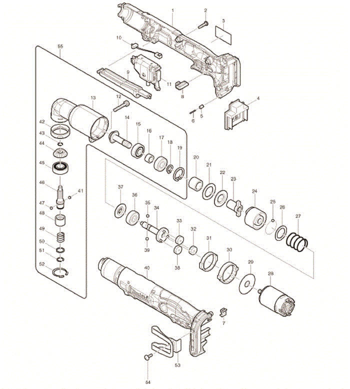

Exactly the same way a right angle driver works. The only difference being there's a chuck between the right angle gearing and the planetary gear drive and hammer, which theoretically could cause some minor torque loss.
If by what you're saying is correct I'm no better off for spending £120 on a cordless angle driver and would be better off buying this £25 adapter.
See diagram parts 23-27. That's the impact hammer assembly.

as i say i know exactly how an impact works so it seems contrary to what is logical well in my head at least :D

surely the adapter does the impacting function the drill just does the rotating. Or maybe ive misunderstood some of the replies.
I think people hear impact and think like a rotary hammer drill. The impact is rotational, not direct like a hammer drill.
The impact in a driver can be anywhere at any angle within the drive train. All it is doing on paper is assisting the rotation of the bit/drive which in turn drives the screw by increasing momentum.
At it's most basic form it is nothing more than a typical drill driver. The hammer and anvil just exert more force on the drive train than a motor and planetary gear reduction can alone.
