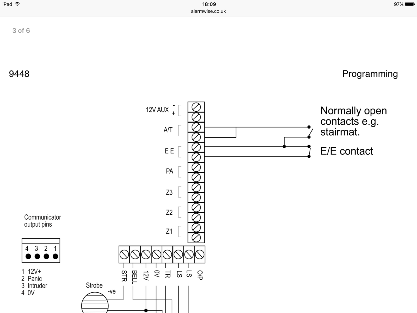

Your going to have to start isolating tampers ...open panel and start with global A/T put a link in the terminals , now try to set the alarm
Ok next step put a link between 0v and TR bottom of pcb , stretch spring ...if it's still showing ....time for a new panel
Have you tried what I said with the new battery? Power down then up and reset?
Hi Guys,
thanks for all the help (and patience). Good news, it turns out the problem was a high resistance contact on the panel's PCB mounted Anti-Tamper switch, I have temporarily shorted this out and the system now works as it should.
