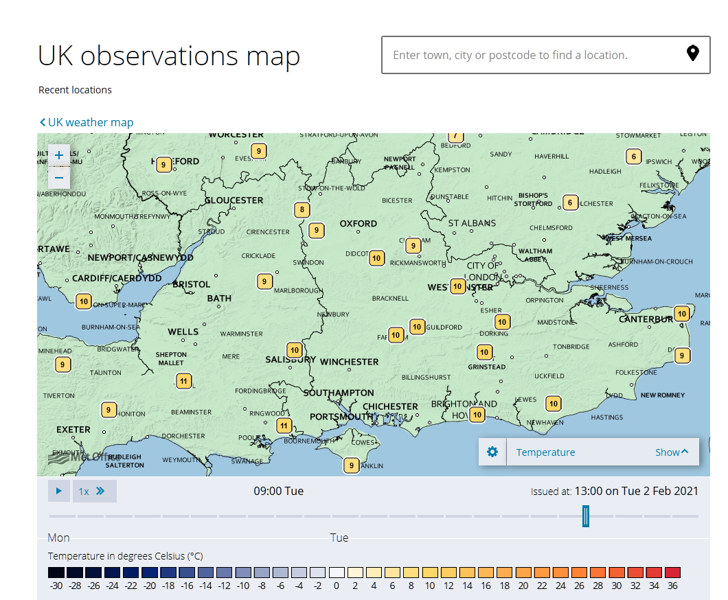

I see the temperature in London this morning was about 10C. Is your house truly colder than that?
https://www.metoffice.gov.uk/public...&fcTime=1612213200&zoom=8&lon=-0.97&lat=51.34
It's usually considered that a house needs to be maintained around 12C. This will keep it dry. It will feel more comfortable if it is not damp, and this will prevent walls and wardrobes going mouldy. Fuel cost is very low at that temp, because, in England, the daytime temperature is often around 2C, so you are only heating it by 2C a lot of the time.
