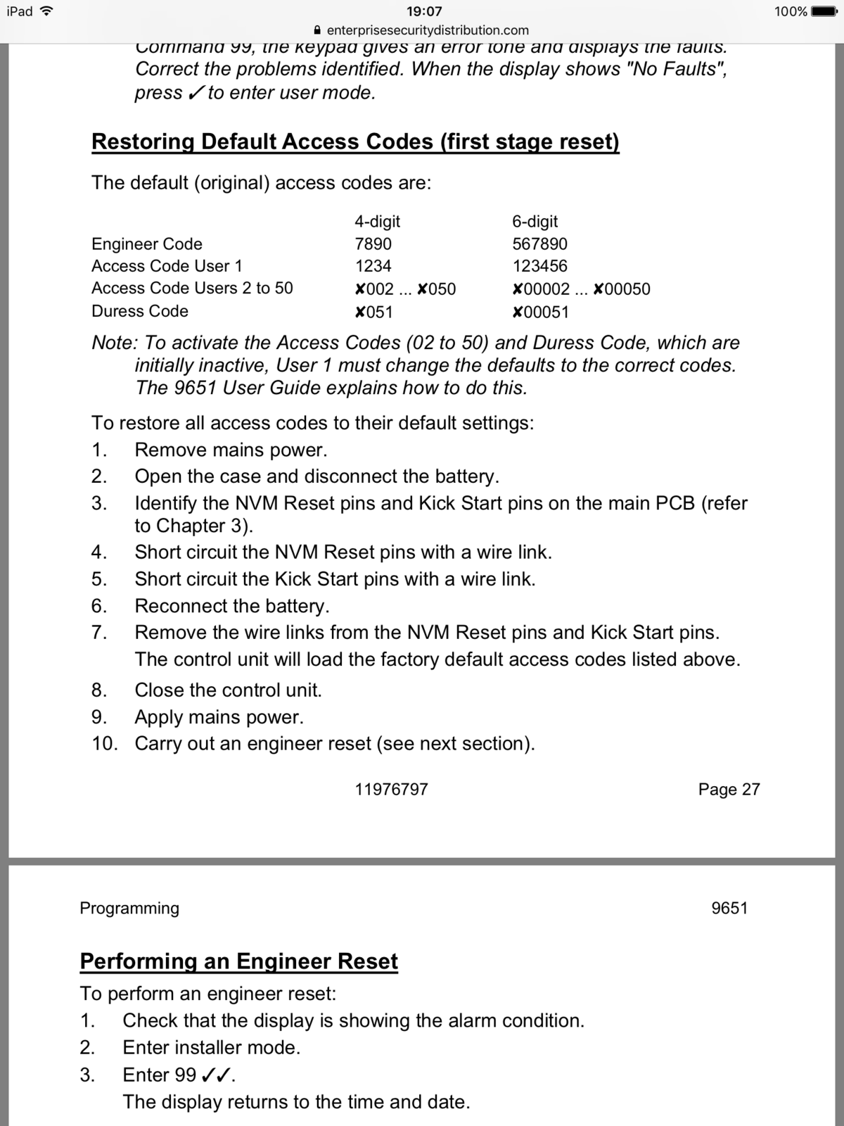

Hi newcomer here.
A guest entered a code too many times wrong and the alarm went off.
I then put my code to reset and entered engineering mode to reset there as well.
System has remained stuck in engineering with an Excess Key 01 message.
How can I exit engineering and return to normal user mode?
Thank you!
Hi
Electric went out the other night and now alram is displaying "reset required - lid Tamper" I have went through the shirt linking of NVM and kick start pins but when I apply main power again error message returns - any ideas?
Hi
Tried this again, followed procedure panel lid back on and error message away but when I key 1234 error message comes back, any ideas?
Restoring the Access Codes (1st stage reset) If the user and/or engineer codes are lost, then: 1. First remove mains power and then open the case and disconnect the battery. Identify the NVM Reset pins and Kick Start pins on the main pcb. Short the NVM Reset pins together using a small wire link. Short the Kick Start pins together with another small wire link. Reconnect the battery. Remove the shorts from the NVM Reset pins and Kick Start pins. The control unit loads the factory default access codes: User 1: 1234, Engineer: 7890. Close the control unit and apply mains power. Carry out an engineer reset
To perform an Engineer Reset:
1. Check that the display is showing the alarm condition.
2. Key in 0 followed by the Engineer’s code (default 7890), followed by 99 YY.
The display shows the time and date.
This sorted it - for information
