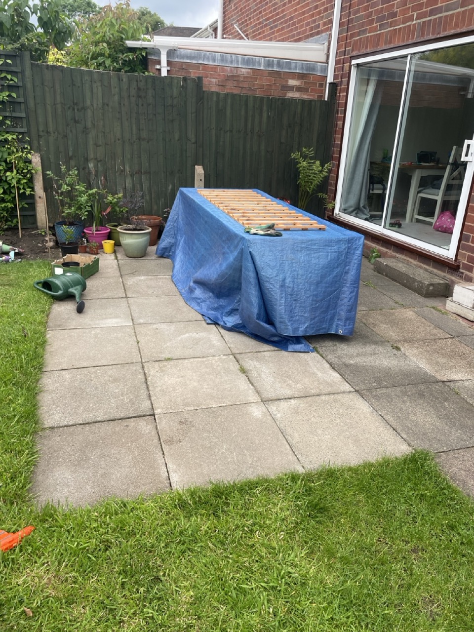

1) What do I need to treat the wood with, to make sure the pergola lasts? I assumed just a wood preserver, but apparently you also need a ‘topcoat’ of something. I want a completely natural look, and I don’t want anything that needs to be recoated quickly because it will be difficult to do when built. I don’t mind doing as many coats as is necessary and using multiple products if necessary, but if you can recommend specific products that would be great.
2) What should I fix the uprights to? I’ve included a photo of the area so you can see what I’m working with. These 60mm thick slabs are sitting on 60mm sand and 150mm compacted MOT1 hardcore. Crucial thing is the wood can’t be sitting directly on the slabs because of the risk of water damage, so I will need some kind of elevated bracket big enough for 150x150mm posts. I also don’t want anything very conspicuous. Has to be fairly discrete. I was thinking something like this, but would that be okay directly on a slab? I'm only having posts (3 of them) at the far end of the patio. The other side will be fixed directly to house wall, so it's effectively a lean-to pergola).
Thanks in advance for any help.

The timber is already bought in, so what I’ve got is it. It is pressure treated though.
I know I need to fix to the ground! The question is with what do I keep it fixed to the ground that won’t allow water to get to the timber.

Thanks, but that solution (concrete posts) would spoil the look. I'm really just deciding between (1) attaching the wooden posts to patio slabs or (2) removing the slabs/sand/hardcore in question and pouring in concrete, and then attaching to that.

You can get metal post bases that are either screwed to concrete pads or hammered into the ground, and these slot into the post - foxhole has posted something similar. These are unobtrusive as they slot into the centre not fixed around the edge.
