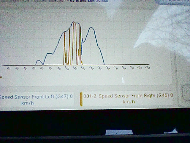

I used my new Topdon scanner to graph the front n/s and both rear sensors when driving. The graph curves were near identical.
I then graphed the both front together. This graph is the output. The RHS is very jumpy.
full

I believe I found the culprit.
The abs cable from the module to the sensor plug. Although I did voltage tests and the same on both sides, I've done continuity for each side cable.
With battery disconnected and the abs sensor plugs shorted, I measured at the abs module plug. The LH was 0Ω between the pins and the RH was kΩ which when the wires were test individually proved to be high on the green wire, the ground being 0Ω.
Needs a new cable I believe.
