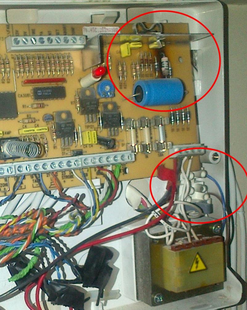

When measured with a multimeter the following readings were taken without the battery connected but with the panel powered from the mains. Note: The panel is protected by a 3 amp fuse but did not blow on panel failure.
1. Voltage from transformer onto PCB = 17.5 V AC
2. Voltage at battery terminals on PCB = 7.7 V DC
3. Voltage at auxiliary terminals 13V & 0V on PCB = 13.98 V DC
Now, I'm a mechanical not an electrical engineer but straight away I'm seeing big problems here as the battery itself is only holding 8 volts.

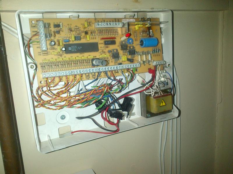

Furthermore, if you look at the photos you should see some tell tale signs of an electrical component failure (unless this is normal burning by a capacitor or whatever is).
On a positive note though, I did power up the panel after clearing NVM back to default again and the RKP and alarm system is now all working, but obviously without a backup battery or any means of charging it!
My assessment suggests that the battery did not cause this or is itself at fault so maybe the battery isn't always the obvious culprit. Maybe?
Guys, please put me out of my misery - am I into forking out for a new panel installation? Perhaps I could do the job myself and save a few quid. In the meantime lets hope we don't have any power cuts in my area!!
Bernard will tell you exactly what the resistor is for, but I'm pretty sure it's a current limiting resistor protecting the voltage regulator.
When the battery went short circuit the voltage regulator was asked for more and more power - until it gave up.
Replace the panel, it's not hard to do.
Without the circuit diagram it would be a calculated guess as to what that burnt resistor does. It is too far burnt to be able to read the colour code to find the value.
But even if the resistor value is known the amount of charring of the PCB would require special care to repair the board.
It is very likely the copper tracks to the resistor will have detached from the PCB and will have to be replaced before a new resistor can be fitted.
Also it is very likely that the carbonised board will create un-wanted connections between components.

If a clr (current limiter) were not there, in normal working circumstances the battery may receive too much recharge. Nominally, the battery requires about 500 milliamps of constant charge. When a battery deteriorates and is left inside and connected to the power supply, it trys to pull down more and more current to compensate for the deterioration. Eventually, the clr goes high value (it is unusual for a resistor to go low value) to the extent that it 'burns out'. Now before Bernard "I get it all out of a book" green reads up on the subject and comes back with some answer designed for sympathetic scientists, it should be noted that the above explanation is purely for the benefit of the layman, and of course for Joe 90, who has homework to do before playing on his X.box.
This is not the end of the world, Any zener, voltage regulator, diode, capacitor etc. are not usually affected and the resistor can be replaced by taking it to your local technical college for the electronics class to replace. It's nice to offer them a fiver for doing the job. The resistor costs about two or three pence as opposed to a new panel. Where I work, the engineers change these resistors on site, if called to a one off job.

It is reasonable to suggest to you DDMA that whether you decide to have the resistor replaced or spend quids on a new panel, in either case you will need to take the panel off the wall, so do you dump it or take it to the local tech ? Your call.

The resistor is typically about 470 ohms, the pcb tracks may or may not require a solder dash. Oh glorious prophet of doom perhaps if you actually did some alarm installation work it would become clearer to you. Not the end of the world by any stretch of the imagination DDMA, if everyone threw away control panels because of a three pence resistor there would be none left to go around.

Need to add a few lines for the benefit of that great writer and author of several books. The value, or thereabouts, of a current limiter is about 470 ohms. DDMA, there are coloured bands around this 'hi value' resistor. Do you think it might be possible, when you have time, to let us know what they are ?
Thanks.
Nominally, the battery requires about 500 milliamps of constant charge. .
500 mA through 470 ohms is 235000 millivolts or 235 volts
Heat dissipation will be 470 x 0.5 x 0.5 = 117.5 watts
Time for a re-think on the value of the resistor ?
