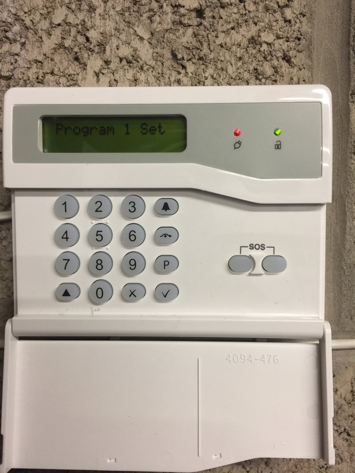

Okay - after lots of help from here I finally got everything installed and thought I had it sorted - sadly no!

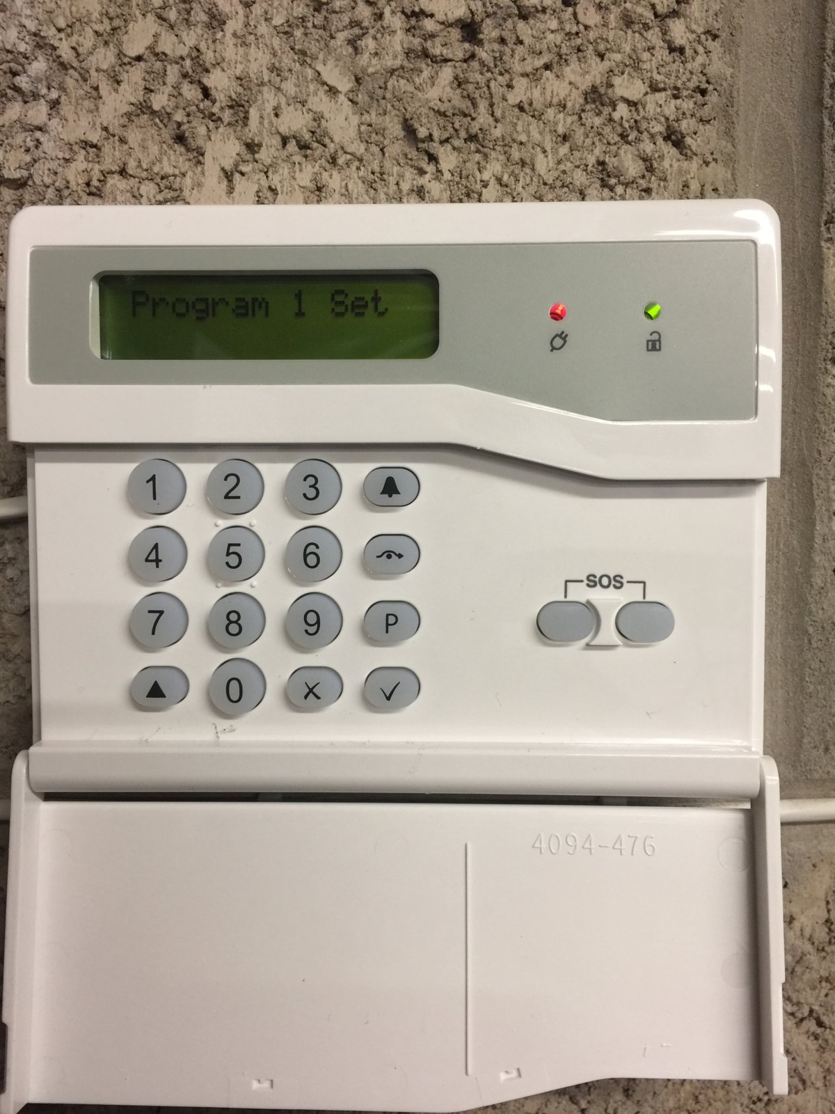

I went to set the alarm for the first time today and it just wont set? I enter the code in the keypad and the display then changes to "program 1 set" , which according to the manual is correct, it should then beep for 30 seconds and set itself. It doesn't set it just stays as "program 1 set" and continues to beep?
What have I done wrong? System as follows:

The keypad is in my workshop right next to roller door. When I enter code to set alarm but stay in the workshop it will not set it just continuously beeps. When I open the roller door to leave the lcd display then changes to "setting fault front door"
Roller door is zone 1
pir zone 2
Its about a simple a system as you could get? I just want to set the alarm, have 30 seconds to leave and it sets. It must be the programming, I cant work out what I have done wrong?

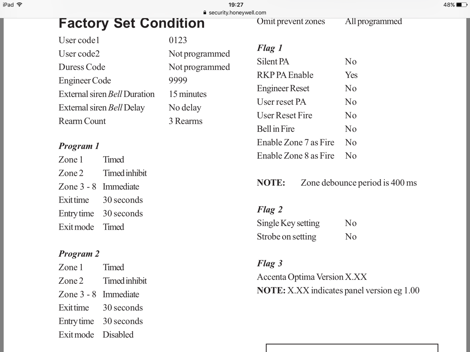

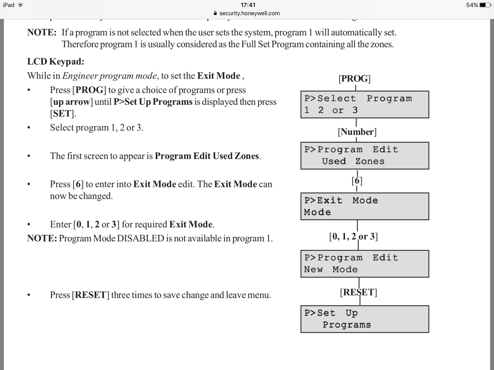

I have tried setting as per the above user manual screen shot with no joy?

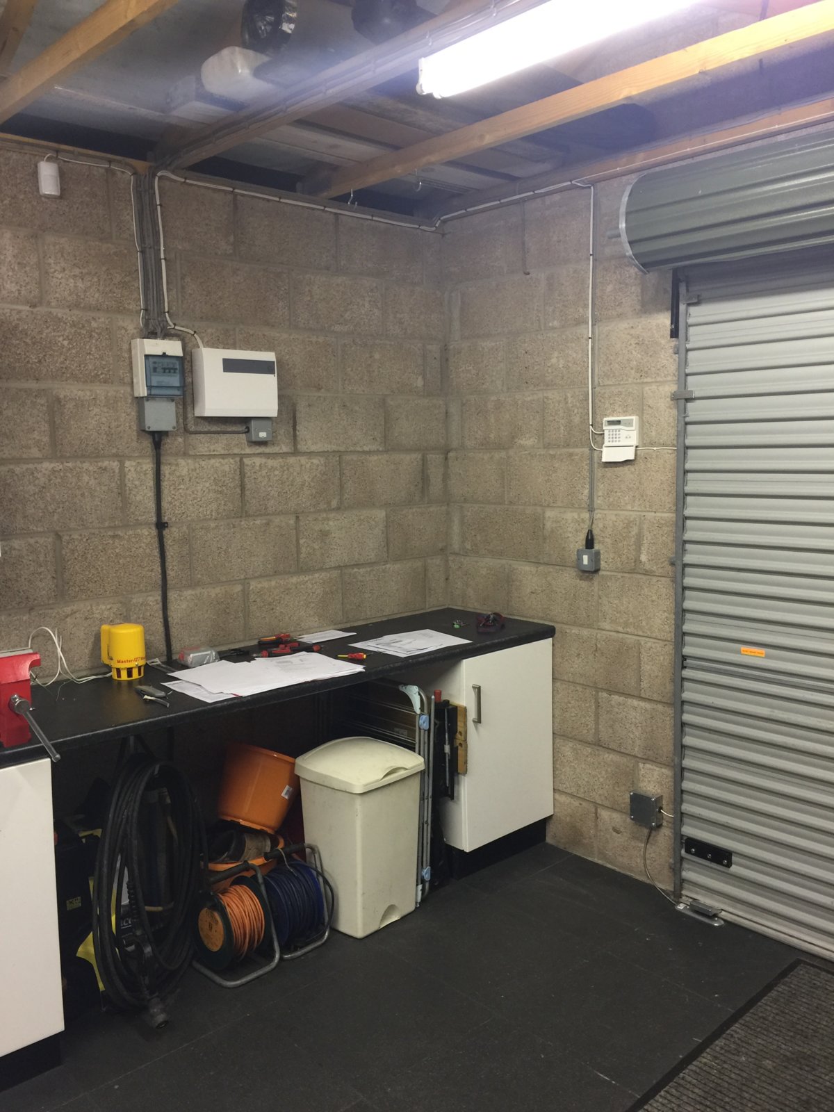

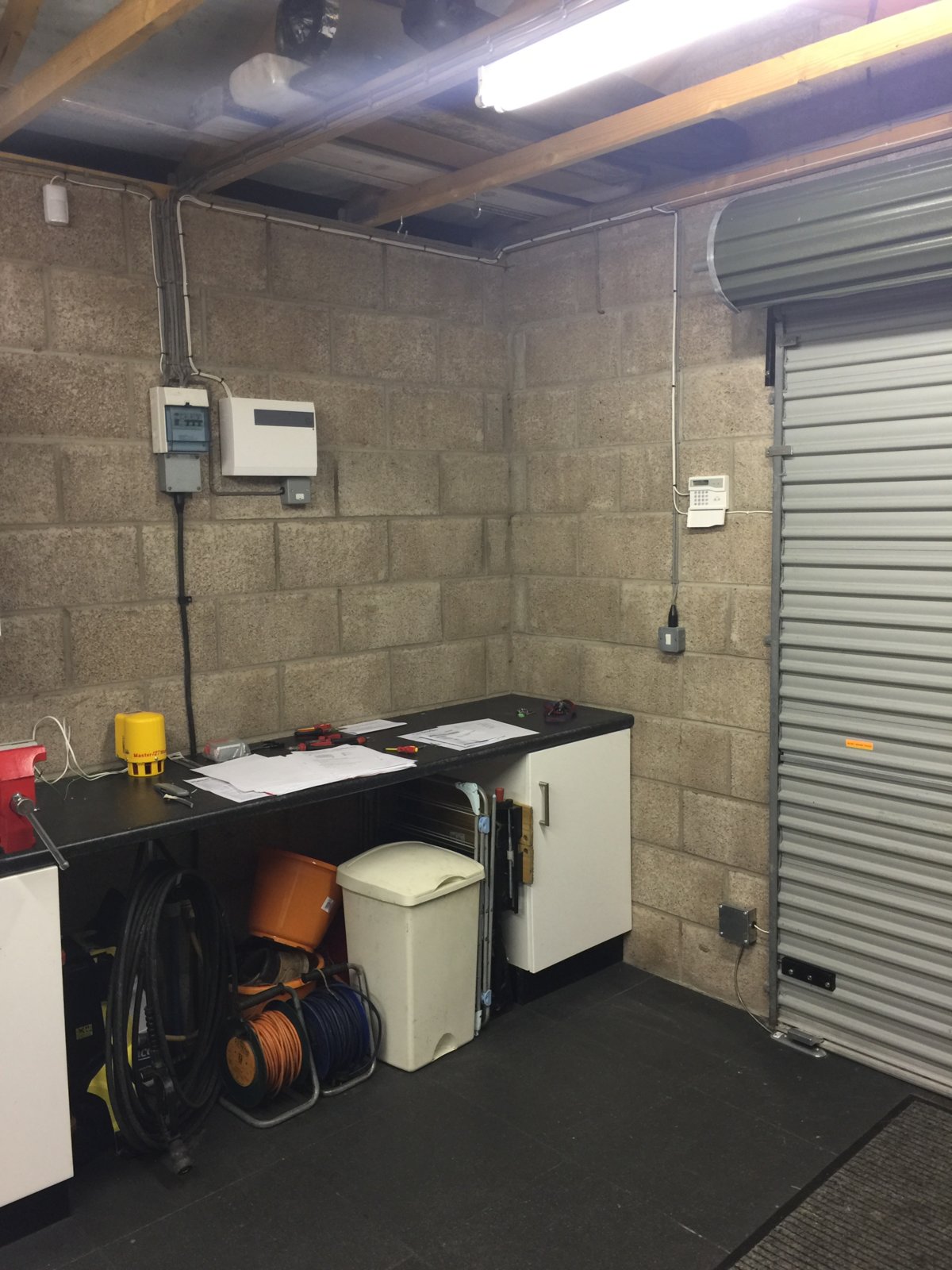

Sparkymarka - does this pic help? Top left pir - bottom right door contact. This all that I have in my workshop . Just spent the last hour trying to set the alarm and failed miserably. Entry and exit is roller door.
How exactly should I program the panel?

As default in manual it should work! But not sure what else you have altered in the programming
Default panel as per page 17 and try to set it with 0123 see if that sets ok

I have reset to default - all I have then changed are code 1 and code 2 and set the time and date. When I enter the code to set the alarm the panel just continually beeps and will not set????
I'm getting somewhere - reset to default again (no changes at all) and tried to set the system - same problem, would not set. Went into programming and marked zone 2 (PIR) not used - tried again and system sets perfectly with just zone 1 (door contact)
What is it about the PIR on zone that is causing it to not set?

Ill check and report back tomorrow. Had to leave and get back home. - links in all other 8 zones (see pic) but I do intend to mark then unused in the programming. Walk test works fine' open door and 0 under zone 1 changes to a 1, move around and 0 under zone 2 changes to a 1.
