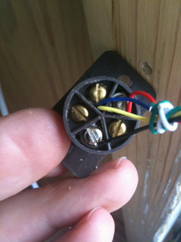

Wiring at the door switch (not currently used testing via the shorted circuit). Red and black across the reed switch, blue and yellow joined at the junction. Resistance of red and black when closed is 1.8ohms, and when door opened, circuit is open, i.e. inifinity ohms
<a href="http://s1221.photobucket.com/albums/dd478/prbuk/?action=view&current=4aff35cb.jpg" target="_blank"><img src="http://i1221.photobucket.com/albums/dd478/prbuk/4aff35cb.jpg" border="0" alt="Photobucket"></a>

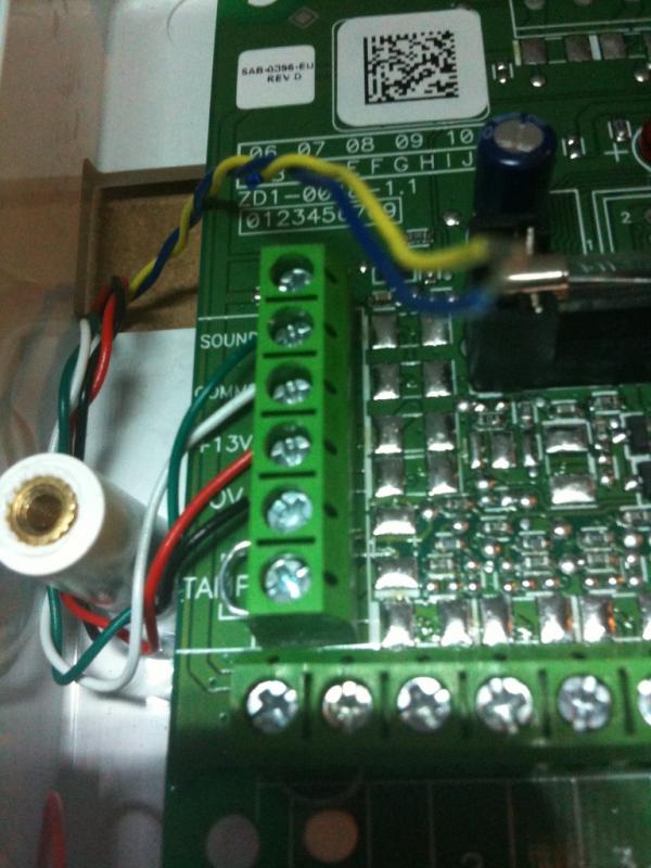

These next photos are of the board as it is. Note I have no real wiring attached. This is the RHS of the board as you will recognise.
<a href="http://s1221.photobucket.com/albums/dd478/prbuk/?action=view&current=c98bf171.jpg" target="_blank"><img src="http://i1221.photobucket.com/albums/dd478/prbuk/c98bf171.jpg" border="0" alt="Photobucket"></a>

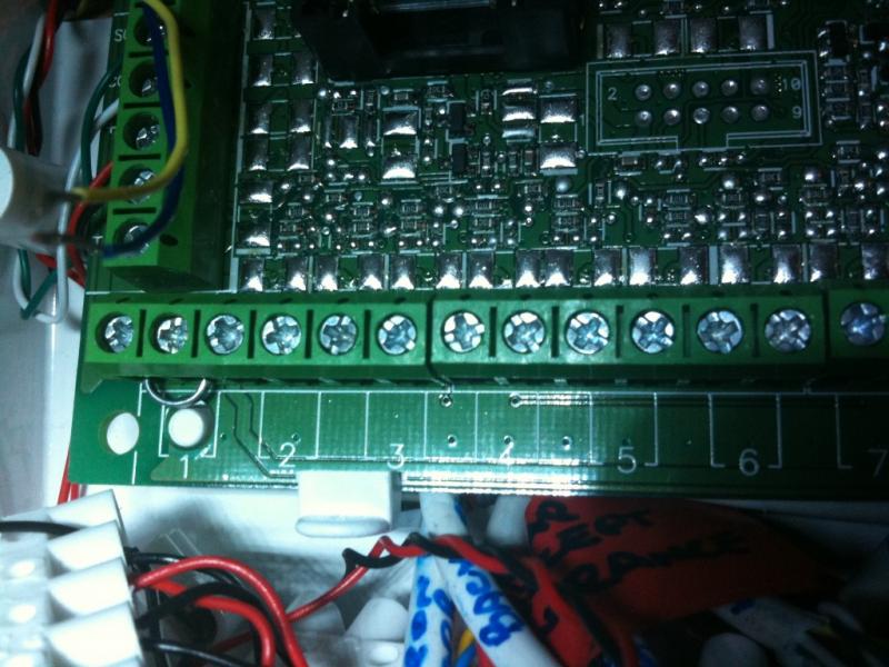

This is the shorted circuit
<a href="http://s1221.photobucket.com/albums/dd478/prbuk/?action=view&current=5a3372ac.jpg" target="_blank"><img src="http://i1221.photobucket.com/albums/dd478/prbuk/5a3372ac.jpg" border="0" alt="Photobucket"></a>

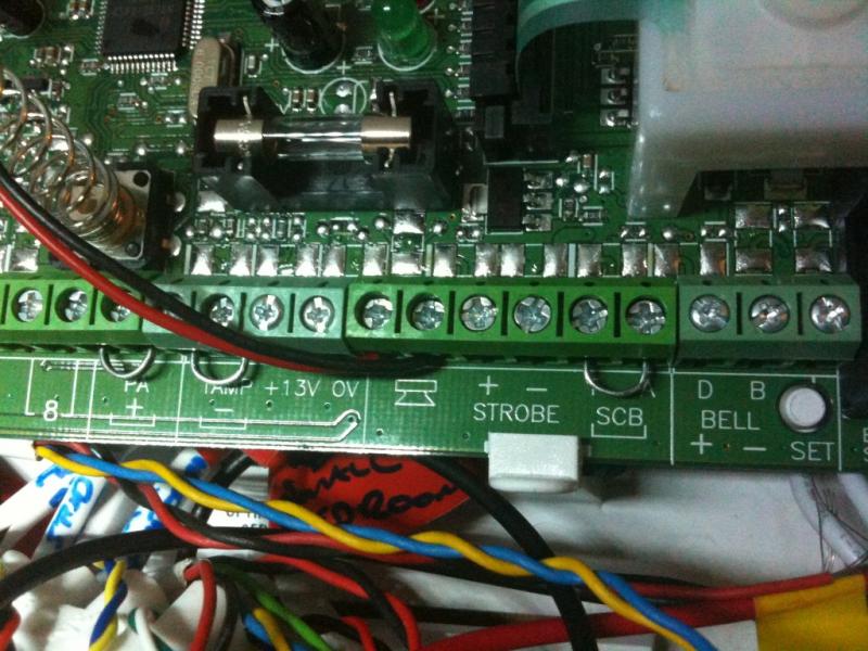

This is what it looks like when I have connected it, i.e. the black and red in the zone 1 circuits. Tamps not connected from this circuit as they are shorted out on the board for now. After the walk test was sucessfull, I will wire up the tamps in serial.
<a href="http://s1221.photobucket.com/albums/dd478/prbuk/?action=view&current=5d8fff74.jpg" target="_blank"><img src="http://i1221.photobucket.com/albums/dd478/prbuk/5d8fff74.jpg" border="0" alt="Photobucket"></a>

Red and black across reed. blue and yellow joined
Showing all factory shorts
Shorted zone 1
LCD panel (doesnt show much without rear of panel I guess)
What it was like before I went into debug mode
