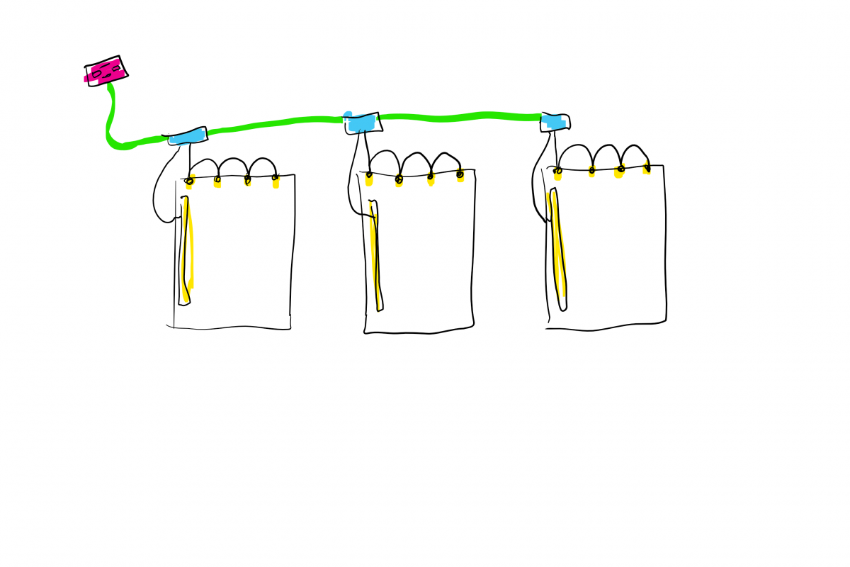

Hi All.
Quick question. I am looking at some cabinets (see pic )which are currently fed via greg bank. From the greg bank a 1.5mm t&e is plugged in (pink plug) and goes into the first unit and then through the top of each of the other units. In the top of each unit the 1.5 is split via a junctionbox and from the junction box (shown in Blue) a feed cable for 4 down lights on 0.75mm flex comes out and a feed cable for what looks like 0.75mm flex with moulded plug to connect a strip light.
The greg bank is protected by a C10 breaker.
The units are not movable and are screwed together. All the cable is concealed within the unit. Is this acceptable?
PS the picture is only representative all the wires and JB's are in the units and can't be seen.

Plug in Ceiling Roses and a Lighting Distribution Box to suit
Is that already in place? Seems a bit overkill/industrial if not. Is there a power switch for that bank or only the mcb? Also what are the ratings of the downlights and power strips?
Yes it's a mill so very industrial. The sectional areas though are light commercial type. This is just one area. The average draw per area is around 4 amps. The down lights are watt with 13 watt side lights but overall it's about 4 amp total draw. Industrial or not though would not really affect the suitability unless we are talking about the C type and even then there is no fixed rule.
Sorry got called away while writing, The Klik units are rated 6A, although likely they can take well over 6A for a commercial unit you should really follow the rules. I have had problems myself with a 16A MCB with lights, the bulb welded it's self to the holder, I think the C10 is not the way to go, stick with B6 MCB's, the main idea of the plug in system is so you can swap units and not disrupt the work, so one could unplug remove the assembly either replace as complete assembly or take it to workshop repair and then replace original and no production is lost.
Of course as the responsible person you can do anything which you feel you can justify to management or court of law if it goes wrong. There seems not to be anything which would likely come back and bite you, but I personally would not do it that way.
Hi Eric. Thanks for the reply. Its like that now so I am just getting opinion. Do you mean the Klik Plugs are only rated at 6 amp? The main issue I was thinking of is the lower guage wiring coming off the 1.5 backbone. I know its a short run and no real different to a spur but seems wrong but I can't really think of a better way to do it that wouldn't cost a fortune.
If you have KLIK then the output plugs are 6amp each, they are not designed to take T and E cable either.
There is ample connections inside to connect a 1.5 cable and as the unit has a 10 amp supply I dont see a problem
Maybe change the first J/B to a fcu and fuse down there to 6 amp
