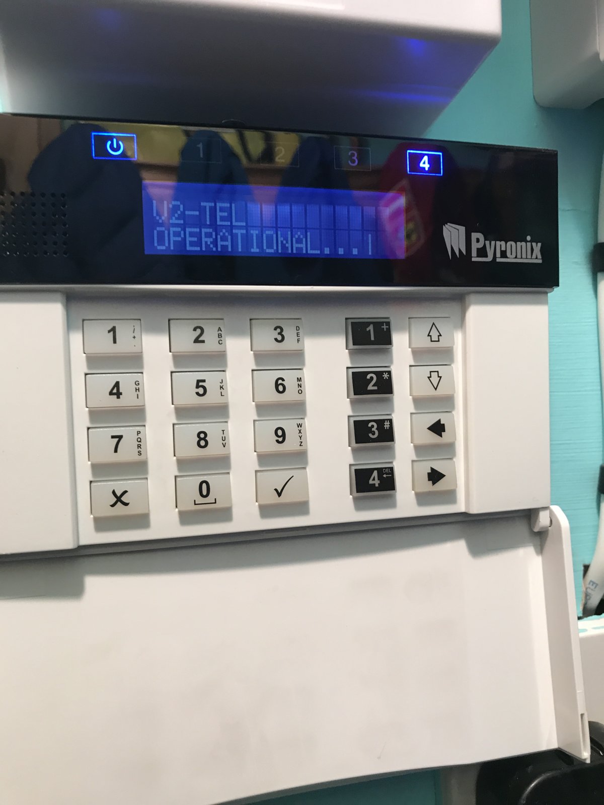

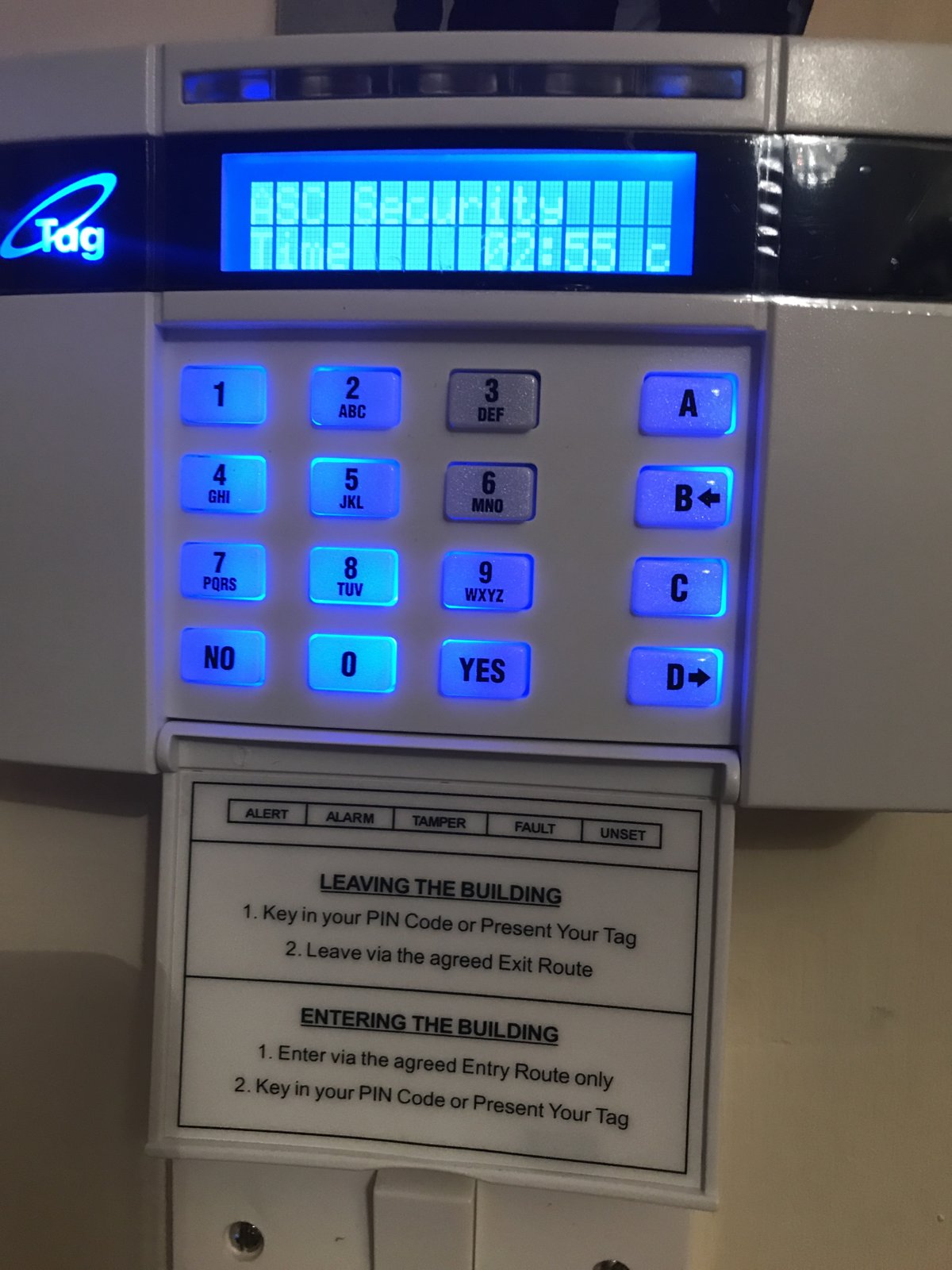

Hi, I got a new battery...fixed fault but it’s not ringing my mobile when alarm is triggered? All help appreciated.
Buy a crystal ball ....
Or post a picture of what you have we sort of know it's a pyronix / castle panel but that's it ...
Were would I get my hands on a crystal ball? Lol.
Check phone line at dialler
Is dialler on bell trigger or programmed output
Have you played around with programming when trying to sort battery fault
Check connections
