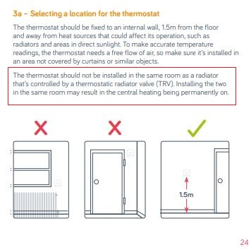

That's not a recommended practice. If you put two devices in the same room one will take precedence over the other, so that:
1. If the TRV reaches its set temperature before the room stat it will turn down the radiator so the roomstat will never reach its set temperature and the heating will continue to run indefinitely. Or at least until any time control switches it off.
2. If the roomstat reaches its set temperature before the TRV it will turn the entire heating off and the TRV will be rendered redundant.
Many thermostat manufacturers state that it shouldn't be done, but some do go to the trouble to explain why it shouldn't. Here's a couple of examples.
Hive
Energenie MiHome
a-jpg.182748

The thermostat should be mounted about 1.5 metres from the floor, and not close to, or above a radiator.
Preferably it should not be on an outside wall, (although if you have well insulated walls, this is not quite so crucial.)
It should be in an area where air can circulate easily, not in a corner, or hidden behind curtains, or furniture.
Also avoid locations where the sun can land on it, through a window etc..
