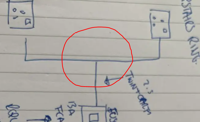

Hi there, I’m in the process of having my basement tanked and want to add a few sockets and a humidistat fan (probs a monsoon).
It’s a radial circuit being set up down there. Can I add a fan to the end of this? I’ve added a diagram of my thoughts for reference.
Cheers for the help in advance.
We call that a spur; not a radial and yes you can do as you draw but -
what exactly is this arrangement?
Ok thanks for clearing up the term, apologies!
That would be a junction box.
I think I’m actually going to add the fan onto the lighting ring now anyway.
Ok but why not use the FCU there and you can replace the removed socket.

So I basically can’t have a junction box in an inaccessible place, now I know that, I know I can’t do what I was wondering. Thats all I needed to know before allowing the builders to continue.

All accessories that are NOT MF compliant should be readily accessible
That is, indeed, strictly true, particular i installed in fairly recent times (goodness only knows how many millions of inaccessible non-MF JBs are currently in service in the UK :) ).
However, given that the poor OP is being 'taken to task' in a somewhat abrupt manner, how is it that you can be absolutely certain that the JB in question is not 'MF' - I haven't noticed anyone telling us that.

I got a look at the JB the other week, it was a white circular one like this
https://www.screwfix.com/p/20a-4-terminal-junction-box-white/1239d
I suspect it’s not MF compliant?
Probs because from what I’ve now read, there’s a chance the screws could come loose, I don’t imagine the wires have been crimped etc. (It’s installed onto a wooden floor beam for the room above. It’s accessible via floorboards but this doesn’t seem to be in the spirit of ‘accessibility’.
If i have to open open the freshly done ceiling so be it :( only got myself to blame for getting distracted and not sorting before they plastered!
I got a look at the JB the other week, it was a white circular one like this https://www.screwfix.com/p/20a-4-terminal-junction-box-white/1239d I suspect it’s not MF compliant?
Your suspicion is (unfortunately) correct.
... from what I’ve now read, there’s a chance the screws could come loose,
That is the theoretical reason why non-accessible JBs are 'required' to be MF these days. However, as I implied, there are countless millions in service, many of which have been in-service for decade, whosw screws have not come loose - and, in any event, even when they are accessible, I seriously doubt that many people ever check the tightness of the terminal screws!
However, "regulations are regulations", and people's attitudes to that vary.
