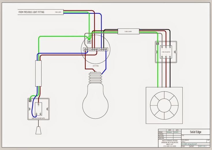

as they say in the Navy, a hole is a hole....You use a 4 wire cable for fans, 3 wire will just give you on/off capability, not light activated switching.

I said first you don't need four wires (three plus earth) to make the humidistat work.
The humidistat merely triggers the timer circuit - after all it does that with the light off in a timer/humidistat set up so presumably would work with no connection to timer terminal.

No, I think I was right.
