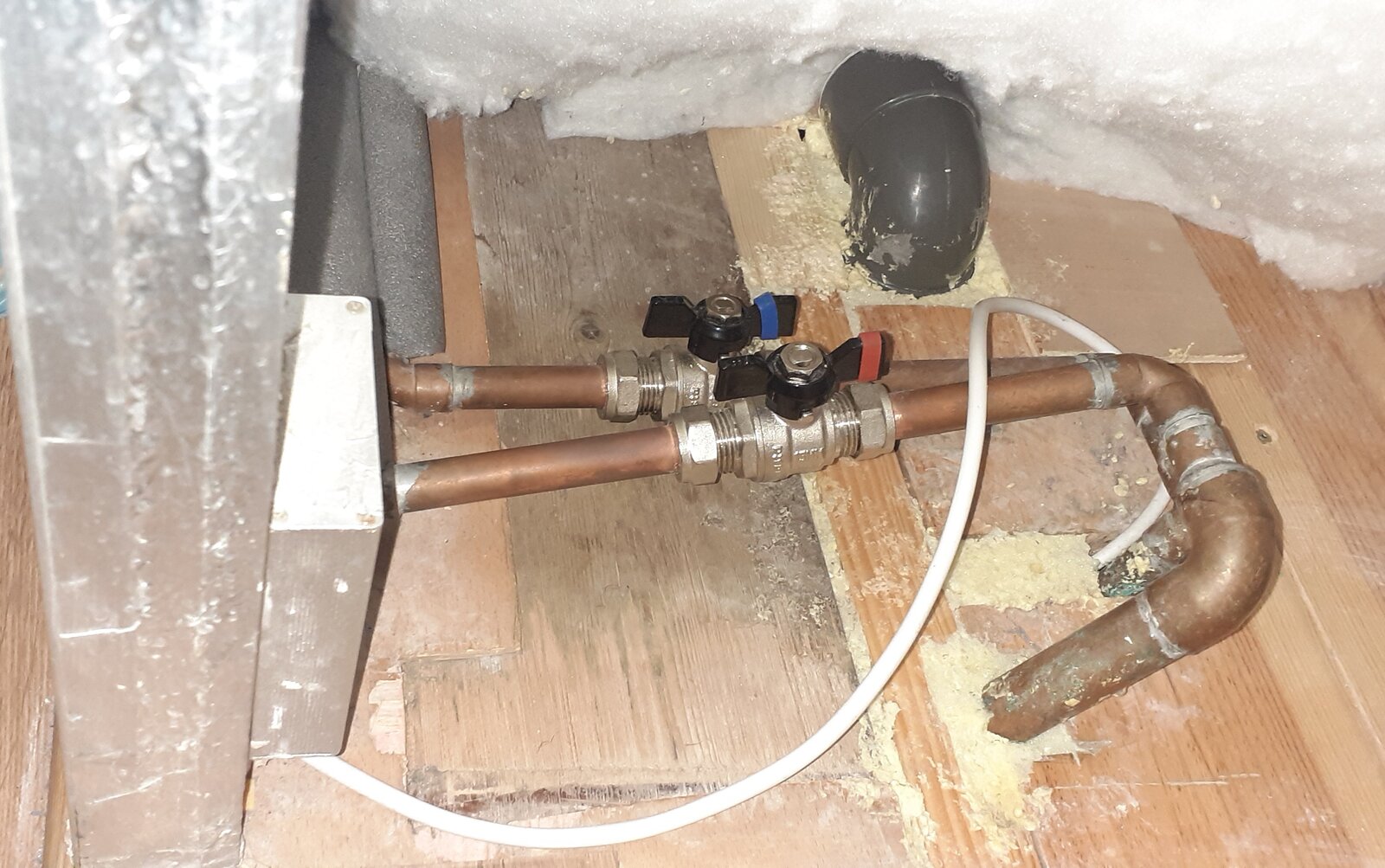

After refitting my bath (removed in a bid to stop rodents entering from next door); I realised I had forgotten to incorporate any junction in the waste for a condensate pipe - my current boiler is non-condensing and lives in a cupboard at the end of the bath.
The bath waste is 50mm solvent weld and dives below the floorboards, before immediately turning 90 degrees and running beside the joist to an outside stack.
Access is a little tight...
Unfortunately, access to the basin, or toilet waste would be even more problematic.
I could cut out a section of board to make better access, pry apart the bend and try and fit a solvent weld t, but I wondered if:

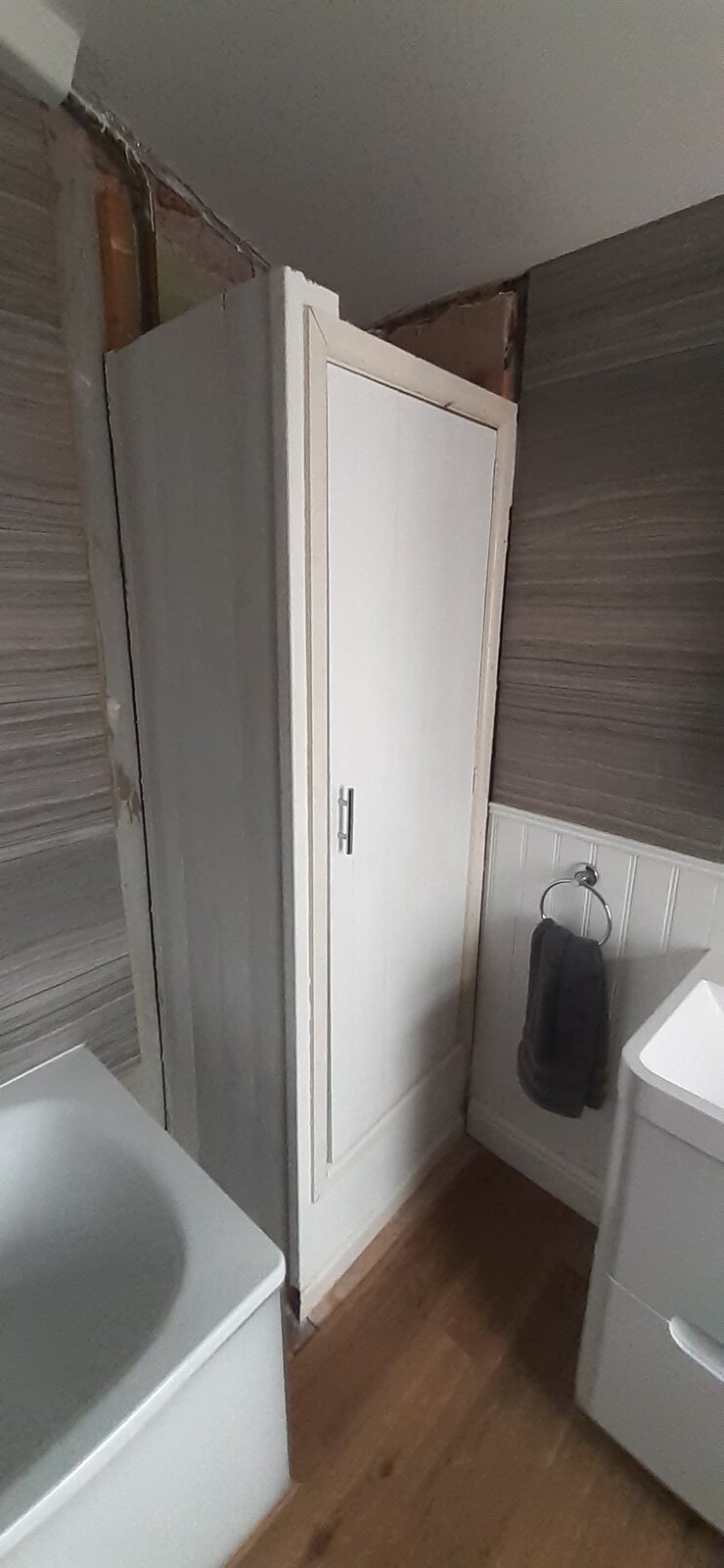

Rebuilding and enlarging the boiler cupboard was the last job to do, after replacing the bath - hence wanting to get a waste ready now.

...and if anyone was interested (probably not), with some lateral thinking, it was quite straightforward.
Most of the pipe beneath the bath was 40mm, before enlarging to 50.
I could reach under and cut the 40 without much hassle.
With a 40 coupler I could connect a 40 T, cut the 50mm bend flush with the floor and drop in a modified 40 to 50 reducer.

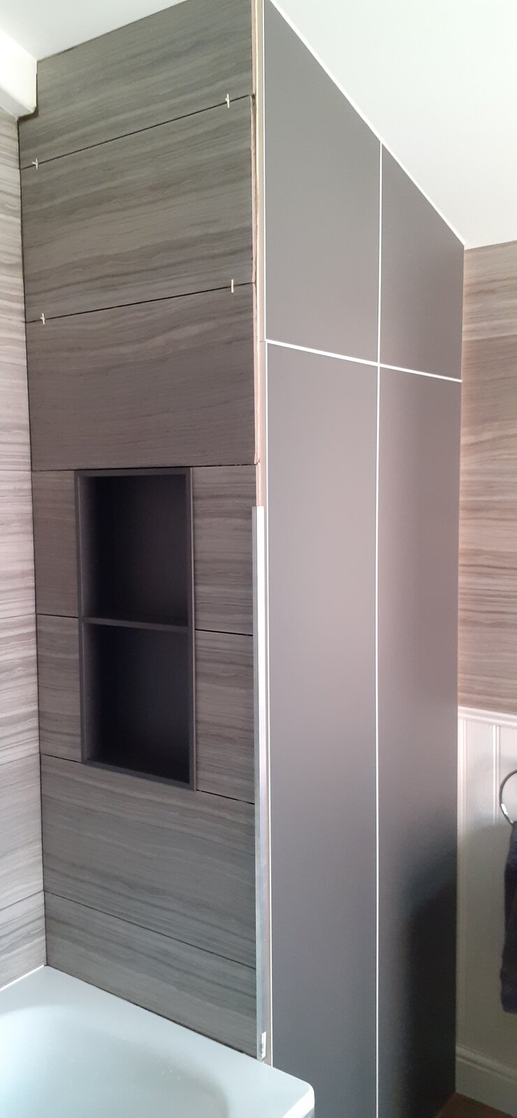

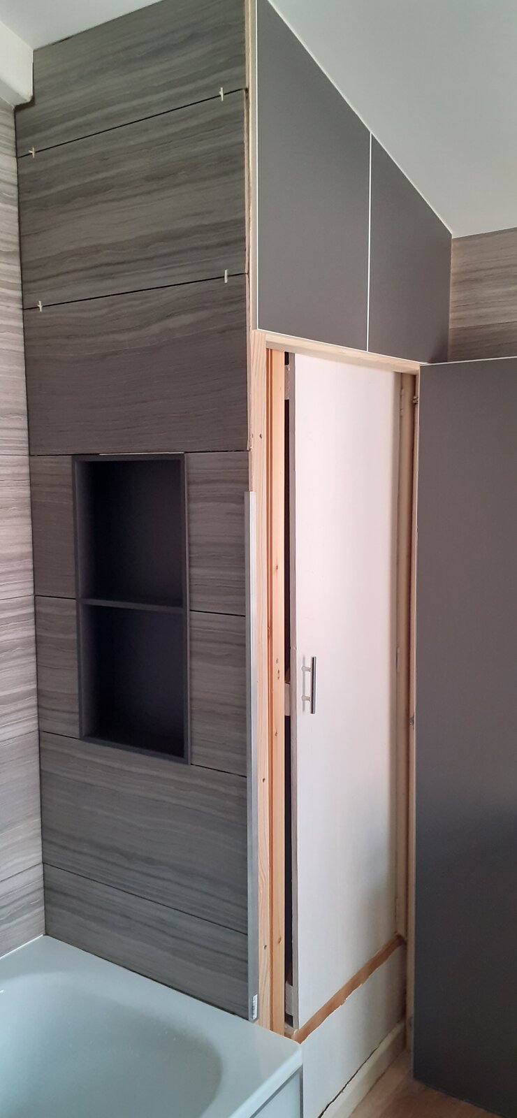

As for the cupboard, with some IKEA hackery, it's getting there...
But do you ever get the feeling you're forgetting something? :unsure:
And totally coincidentally, my boiler has suddenly become a lot quieter! :LOL:
If that's the case I'd just leave it to the boiler fitter. Different doing it beforehand if there would be difficult access in the future.
