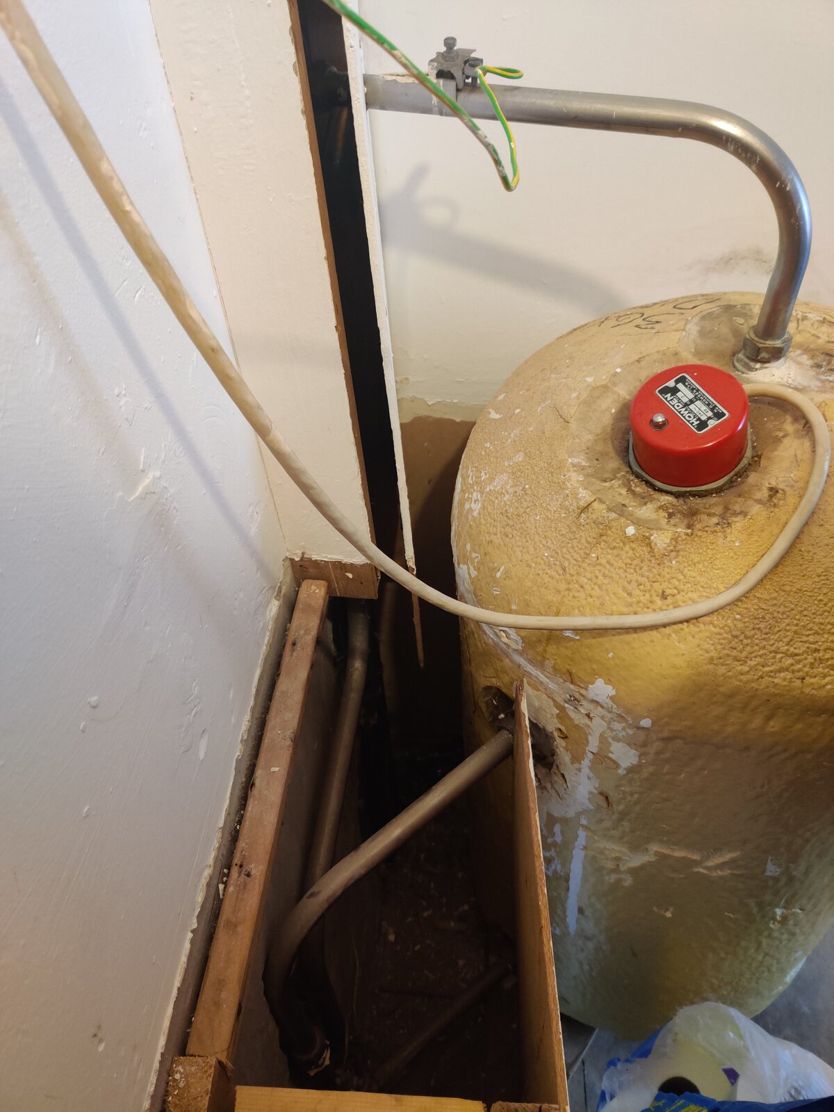

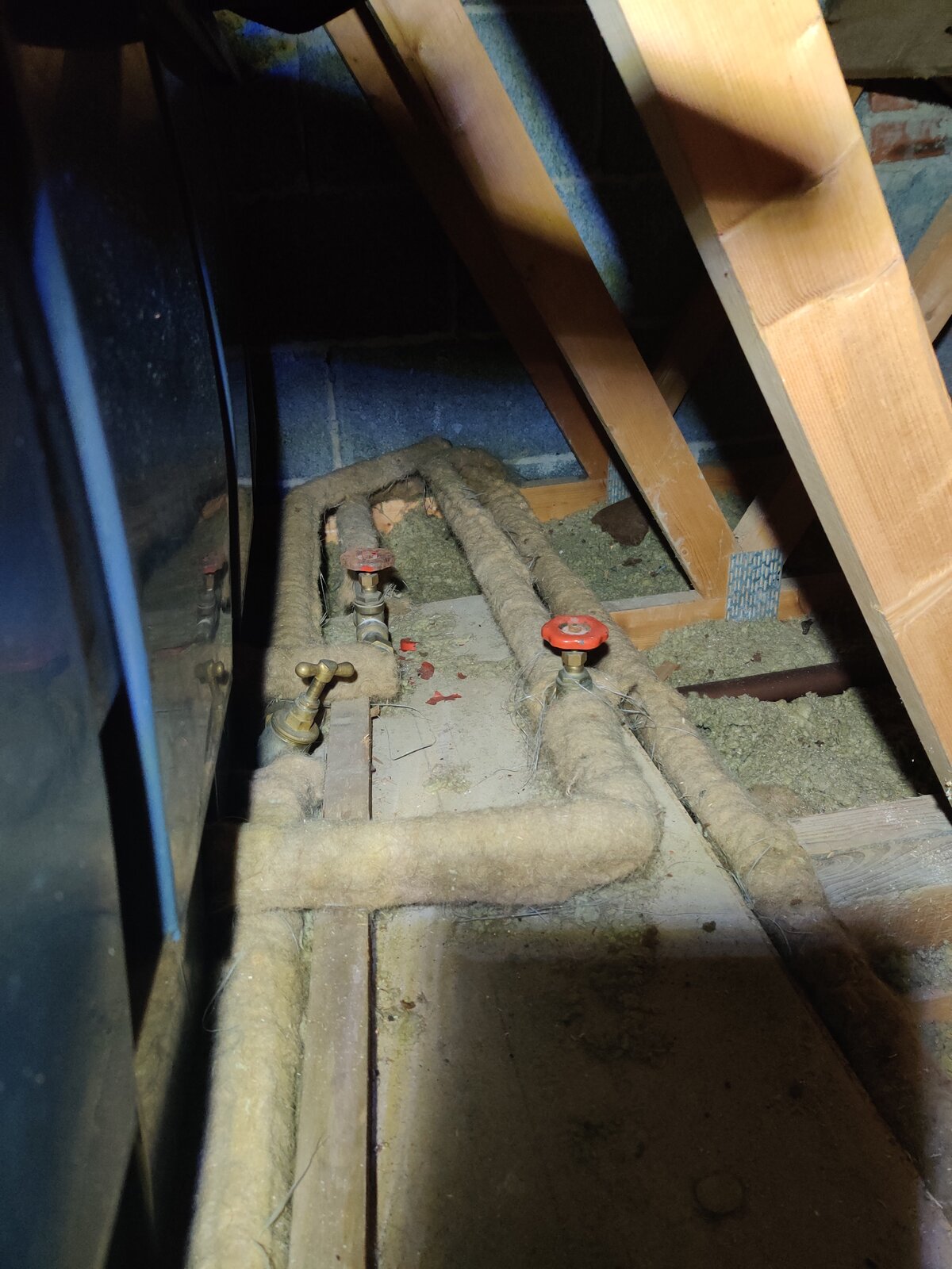

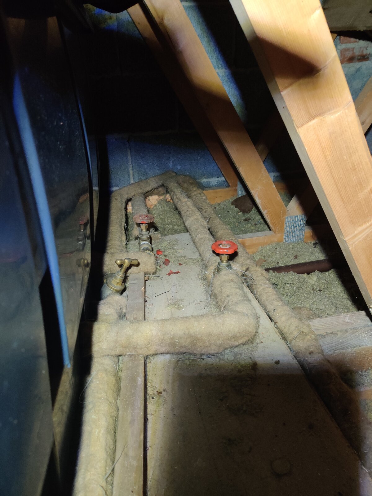

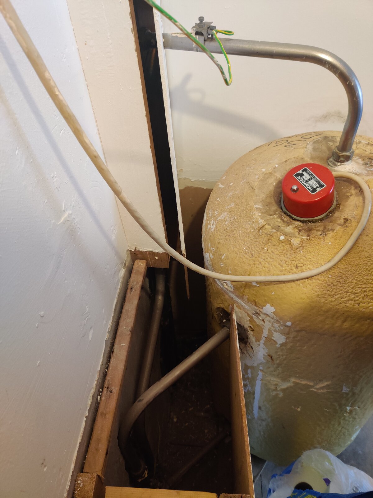

Hello all, I'm looking to install a shower into the house. Currently there is only a bath.
There is a cold water tank in the loft space which I assume mains pressure enters, with two outlets.
There is also a hot water tank on the same floor as the bathroom. Which is heated by electric immersion, and also by gas ( not central heating ) an old heating system that blows warm air into rooms via vents.
What type of shower would suit me best? I don't know if I can tap into the mains if it goes directly into the loft tank, although there is a capped mains pipe which I could use but it's a wide diameter pipe.
Would I be better taking a feed from say the cold bath tap pipe which would be gravity fed and using an electric shower with a pump for good pressure?
The drop between the tank and where I'd position the shower is only about a metre or so.
Many thanks

I think your best solution is to run pipes in the loft to a point directly above the shower mixer location, with drop pipes down. Cold feed from the cold water tank (CWST). If one of the 2 outlets is not currently used, use that. Otherwise tee off one of the pipes, presumably 22mm, or add a new tank connection. For the hot feed, tee into the HW cylinder vent pipe, which goes over the CWST. You'll need a low-pressure (gravity) shower.
I've done that in 2 houses and it works fine. It doesn't give a blistering shower like some people demand, but it's perfectly adequate and uses less water.

First floor. Bottom of the CWST is about 1.2m above the shower rose level. Depth in tank 0.3-0.4m.

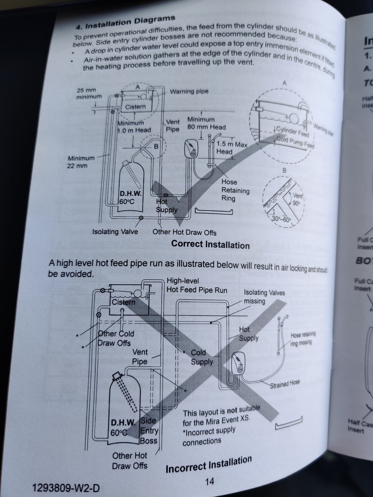

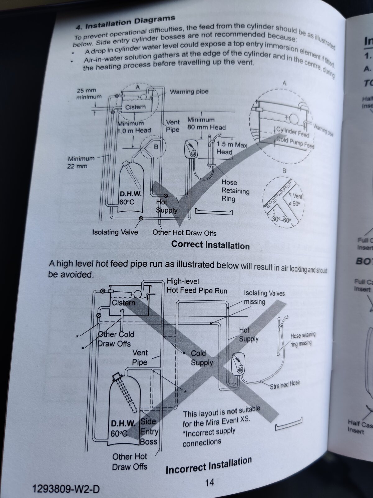

So I decided to purchase a Mira Event XS power shower, which uses hot and cold feeds, and electricity for running a motor only. However looking through the instructions it tells me it's not suitable because it doesn't have a 45degree vent pipe, the hot water tank has a side entry boss, and they don't recommend a hot feed pipe run because of air locking.
