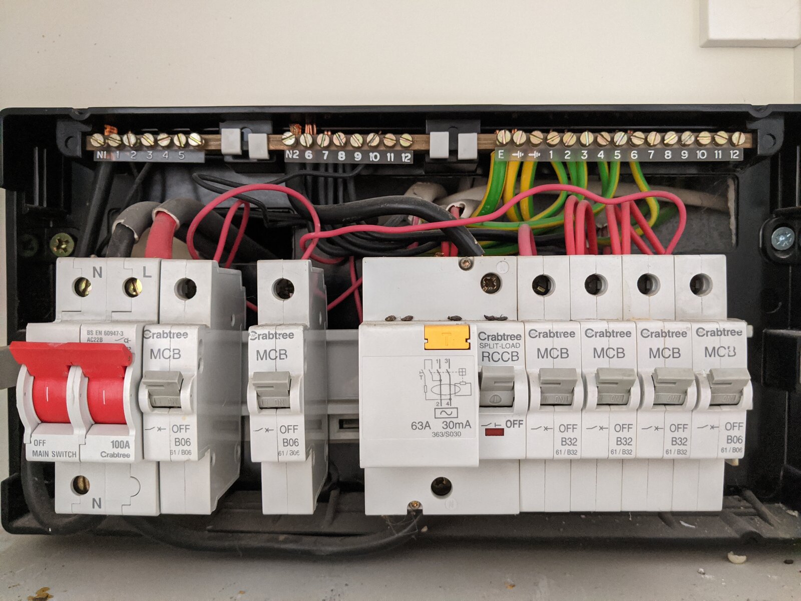

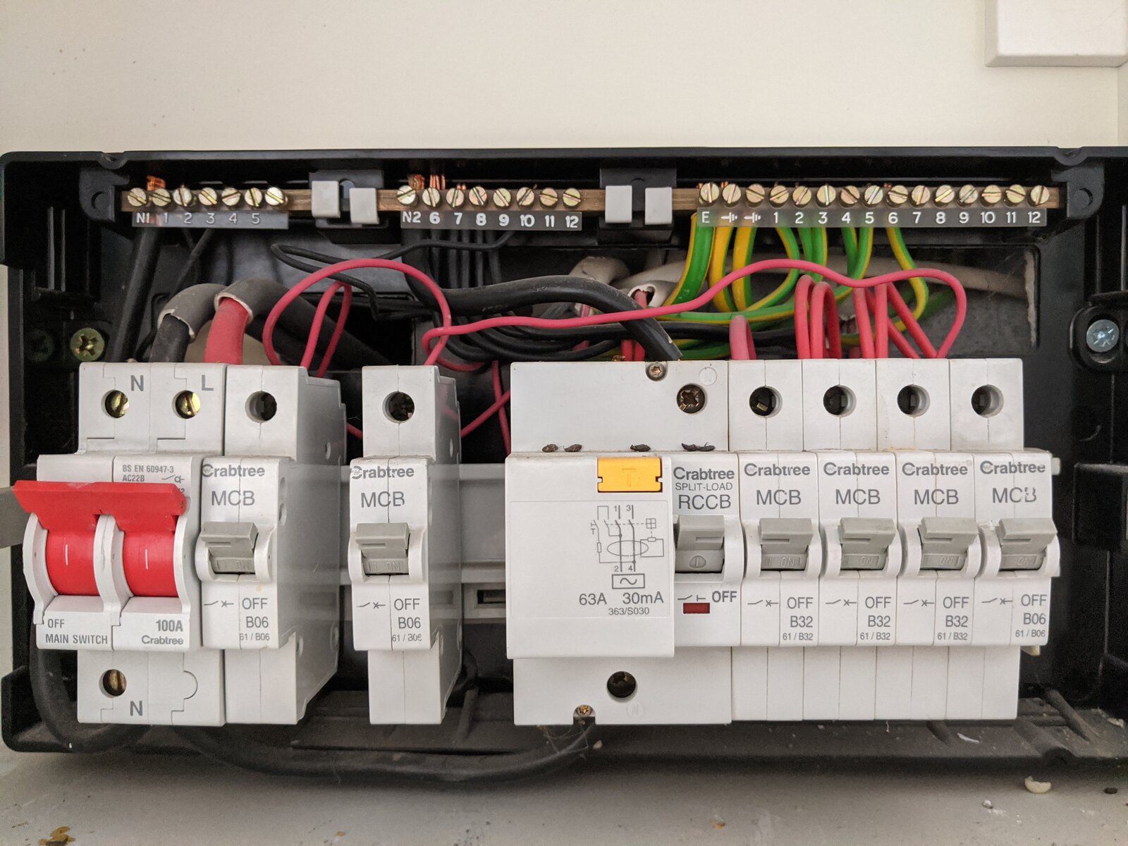

I've done some research and this looks like a ring circuit to me. Any chance anyone could validate my assumption from the attached photo?
It certainly appears to be ring circuits.
When you disconnect the socket from which you want to spur, test for continuity between the two reds, the two blacks and the two CPCs(earth wires) to make sure there are no disconnections in the circuit.
The readings from the reds and blacks should be roughly the same and the CPCs 1.66 times higher.
If you do not have a multimeter, then get one before doing any electrical work.
