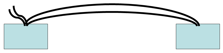

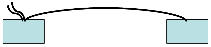

Instead of presumably having unwanted connectors in the back box for one of the cables, why not connect both cables to the existing socket?
This would give you 5mm² (2 x 2.5mm² in parallel) conductors to your new socket - and the same if you decide to add more at some time in the future.
Of course the same could be achieved by using one 4mm² cable.

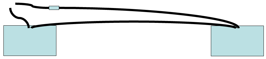

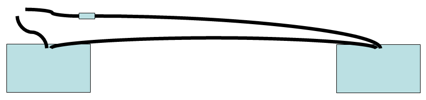

Agreed. In my case though, the places where I wanted sockets conveniently coincided with the cable route for the existing sockets in the room. As a result I was able to cut the existing cable, bring one end into my new socket, extend the remaining cut end, then bring that into my new socket - thus achieving the extended ring with only one join and no backboxes stuffed full of Wagos.
Any chance of you explaining why it is OK for you to suggest this:
and at the same time call this suggestion
"absolutely pointless"? (In both cases, connections etc shown at the cable level, not individual conductor)
Of course the same could be achieved by one using 4mm² cable.
Probably, but at the risk of some unusual topologies developing in the future.
No doubt in your mind you think that playing these sorts of games is of benefit to the forum.
Why would I suggest it - having just dismissed the proposal as absolutely pointless - and then go on to describe why it is?
Given that you will have to run a cable from the existing socket to the new one, why not run 2 cables and keep them all on the ring? (If it is a ring, which it probably is)
How would this work? Take one of the original cables from the ring into the original socket, new cable from same socket to next socket, then new cable from second socket back to the other original cable from the ring? Would you connect them with terminal block then in the original back box, or am I missing something? I installed some spurs in my house, but would have preferred to extend the ring, so is the method i described correct?
Yup.
Instead of this:
this:
My contention is that it really is no harder, and no more disruptive, and doesn't introduce any hidden joints, to run 2 cables to the new socket instead of one.
