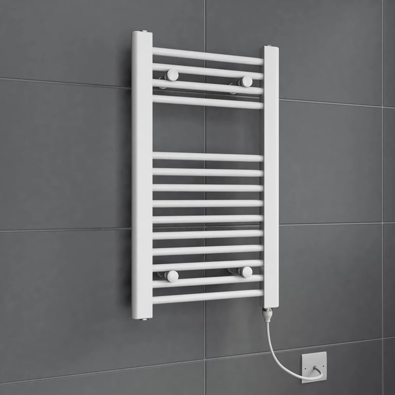

You could fit an electrically heated towel rail. The power usage is very low, often around 300watts. You can in fact run it off a lighting circuit (which is normally fused at 6Amp, which will supply up to 1400 Watts. Modern lighting is mostly with LEDs, which use insignificant current.
Examples

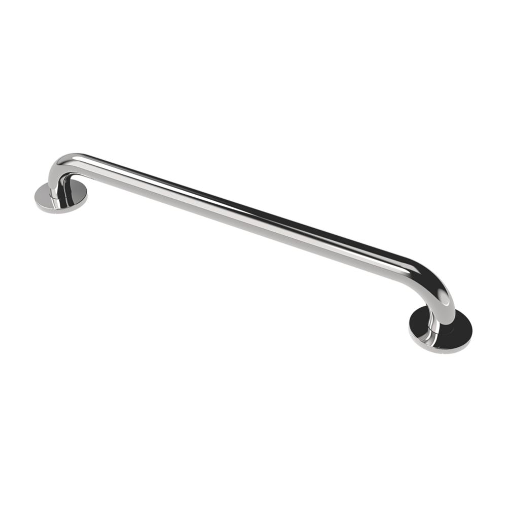

For a person who is frail or disabled, fit a grab rail to help getting on and off the WC. They are not expensive. I have fitted several in bathrooms and WCs, the stainless or chrome ones look like, and can be used as, towel rails at other times.
I recommend stainless as it will not rust, is easy to clean, and will not be damaged by cleaning products or stained like paint. 600mm is big enough to use both hands. You will not slip down a horizontal one.
Painted ones are cheaper. A disabled person might get them free from a support agency.

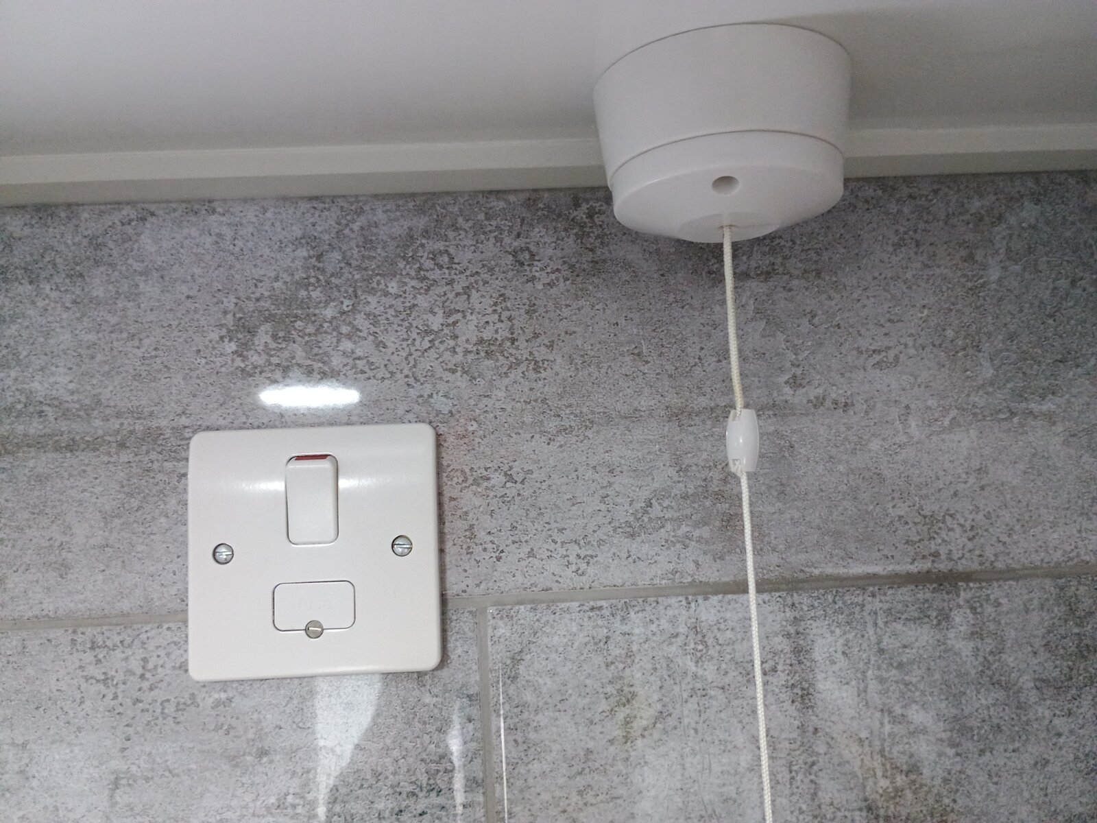

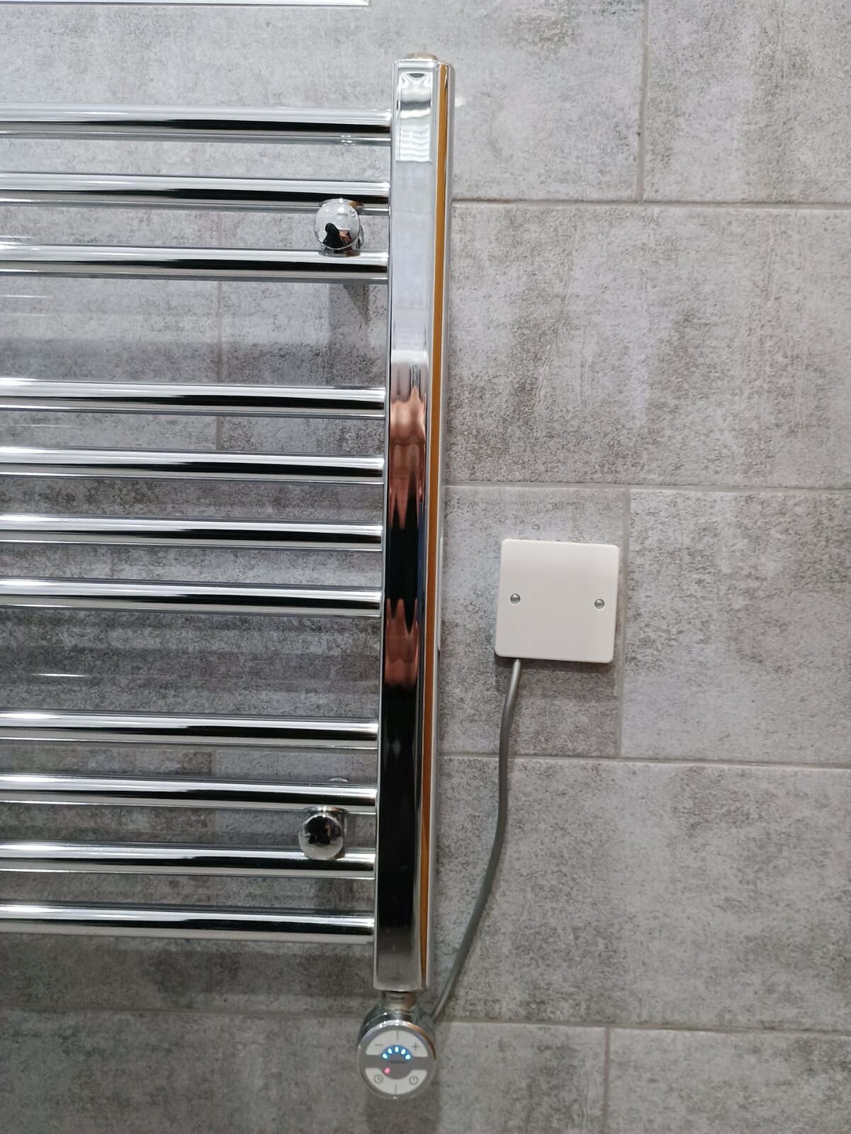

A neat solution is a fused isolator switch at the top of the wall and a thermostatic towel rail wired from an outlet. See attached photos of mine.
This is a Terma thermostatic element/controller in a standard towel rail radiator. I bought this pre-assembled and filled from a website, I forget where.
The Terma unit will maintain a constant room temperature. It also has a basic timer - if it's off then press the bottom left button to switch on for two hours then off again. It also keeps a frost guard while off, it switches on at around 7 or 8 degrees.
If you need a proper timer then that would be best fitted outside the room, perhaps on the wall outside the door. You'd need to check whether the Terma units remain on when power is removed and re-connected (they probably do though).
